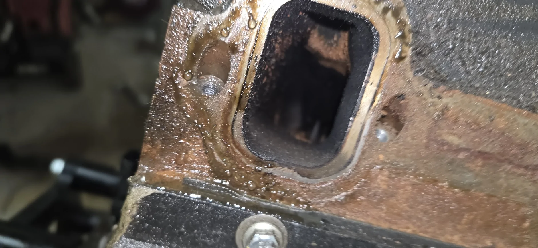

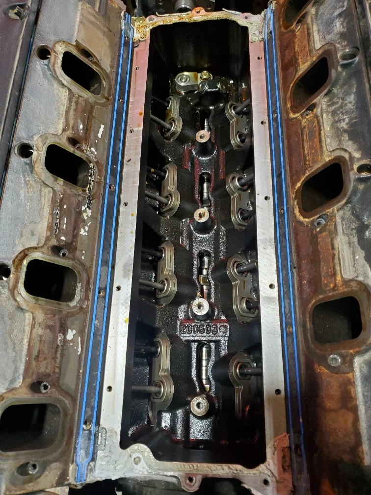

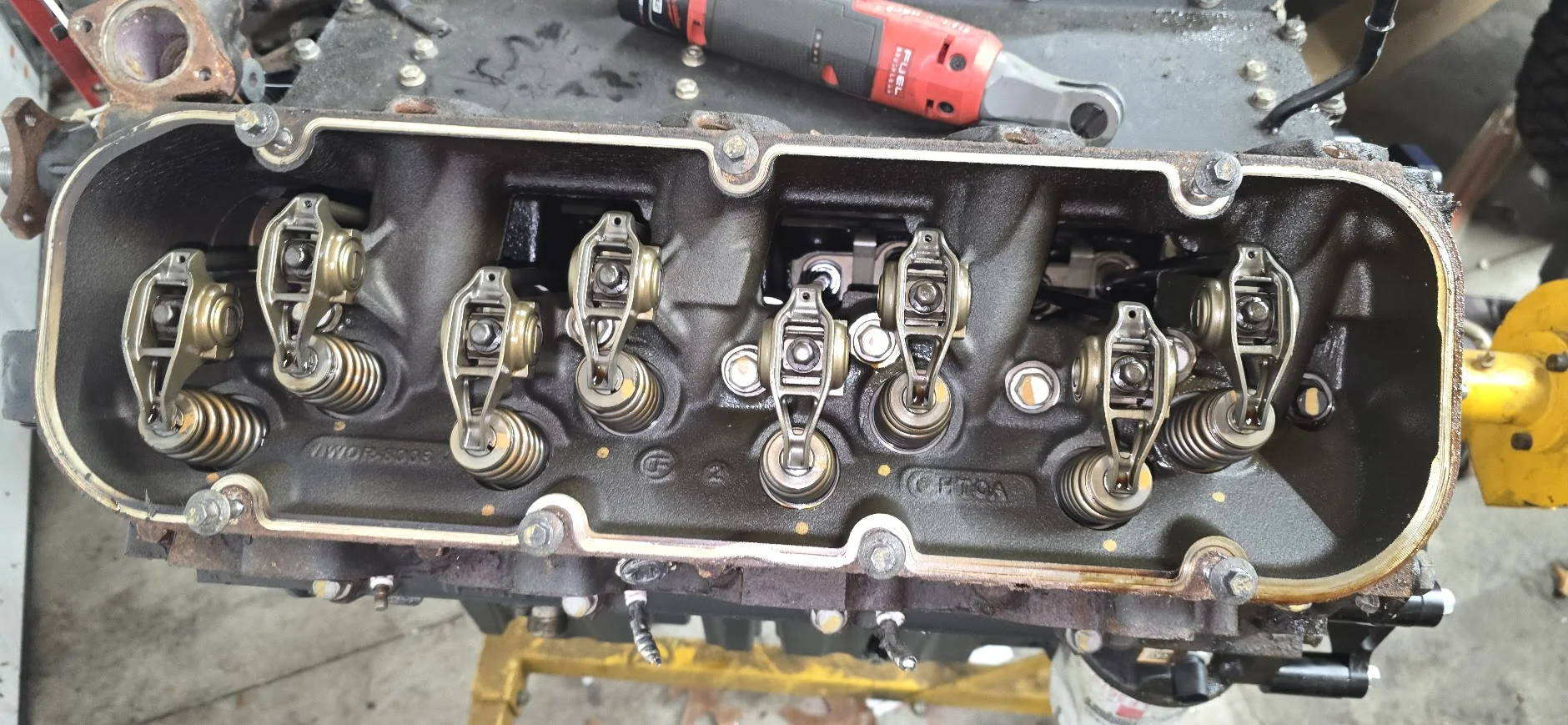

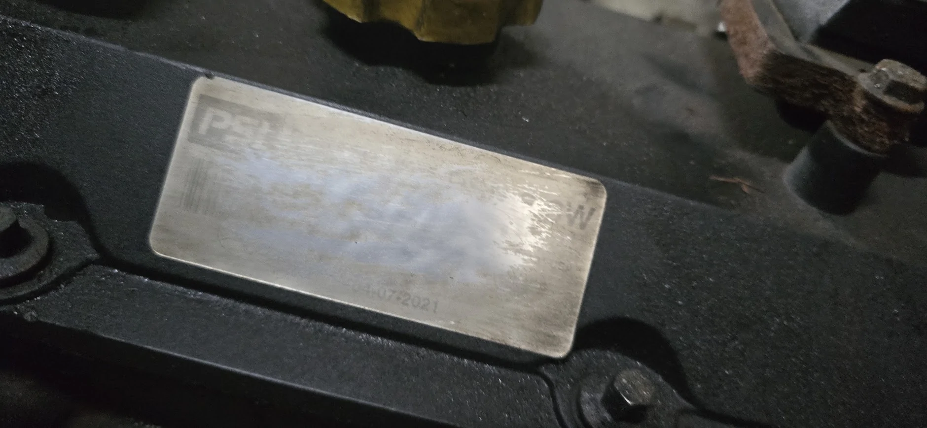

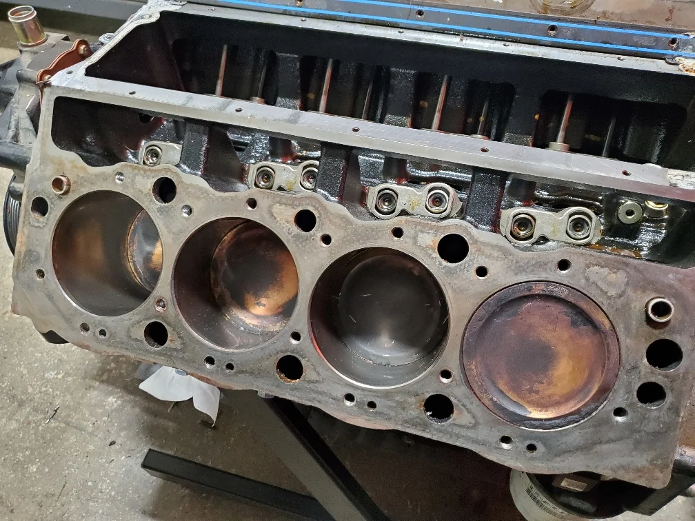

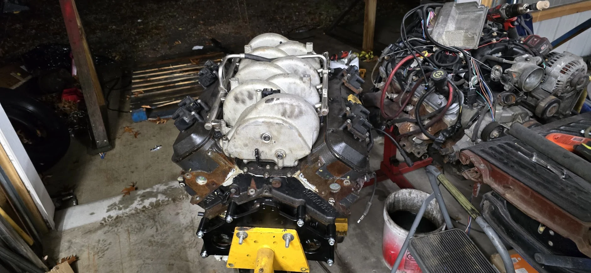

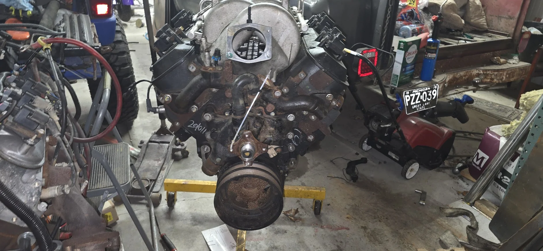

I figure there will be some interest here, even though this is slated for my C10. C10 is currently a 3600 rpm converter, 3.73 gear, turbo LS with a .585 cam at 230 degrees duration, running on a Holley Terminator X.
I'm no expert, and learning as I go as well, but, I've purchased a PSI 8.8L "R" block from KB Cores on Ebay. Price was 1800 bucks plus 175 shipping to my local R&L Dock.
The 8.8 was a stroked 8.1, after Power Solutions International bought the tooling etc from GM. They continued to develop the platform for various medium duty and industrial applications. School busses, pumps, generators.
The R block specifically has a LS style rectangle port on the head, uses LS7 1.8 exhaust rockers, a pretty sweet intake compared to an 8.1, all metric fasteners, different style plugs, a valley girdle like an LS, giant TB opening, etc etc.
For my C10, I'm pretty married to the 4L80e, so I don't really want to go back to a carb from the turbo 6.0 in it now. Which had me looking at Vortec 7.4's and 8.1's. It's even really why I bought my current K2500, to harvest the 454 from.
8.1's have pretty restrictive intakes, modding one is a pain, the valve train is really expensive to add a real cam too, and they tend to run 7-800 bucks on Marketplace.
The 7.4 is it's only little funky monkey, switching it to something 24x and 1x cam was unappealing.
The added costs of either helped me justify spending way more on an 8.8 with "normal" rockers, springs, pushrods, lifters, and an intake that flows to 500 hp or so as is. Will still be added costs, because it showed up with a flat sump oil pan, R blocks are 56x crank and I need it to be 24x... But, whatever, last engine I intend to build in my life, so might as well party.

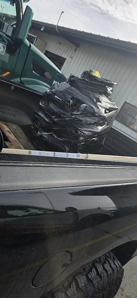

So anyway, pictures, here's some, paid my money to KB Cores, they had it on a pallet and out the door the next day, picked it up at the depot today. Plan to pull it down to a shortblock over the holiday.
The engine pics I stole from an offshore boat forum, until I can take my own 🤷

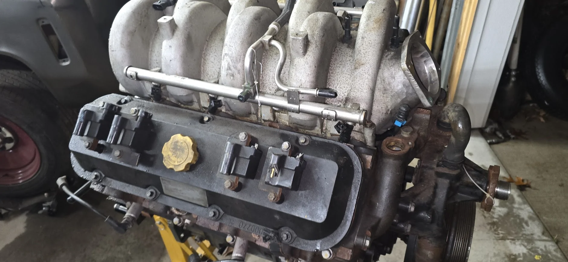

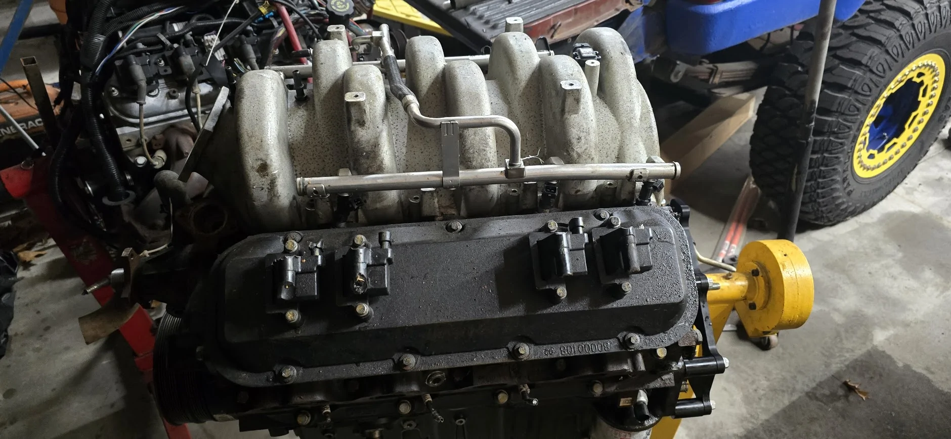

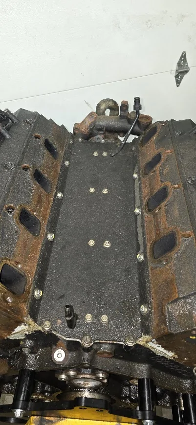

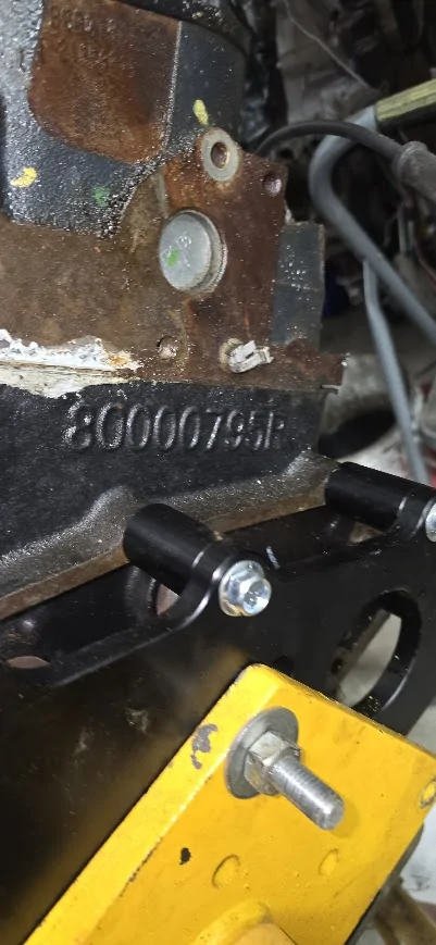

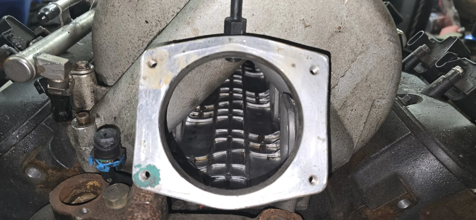

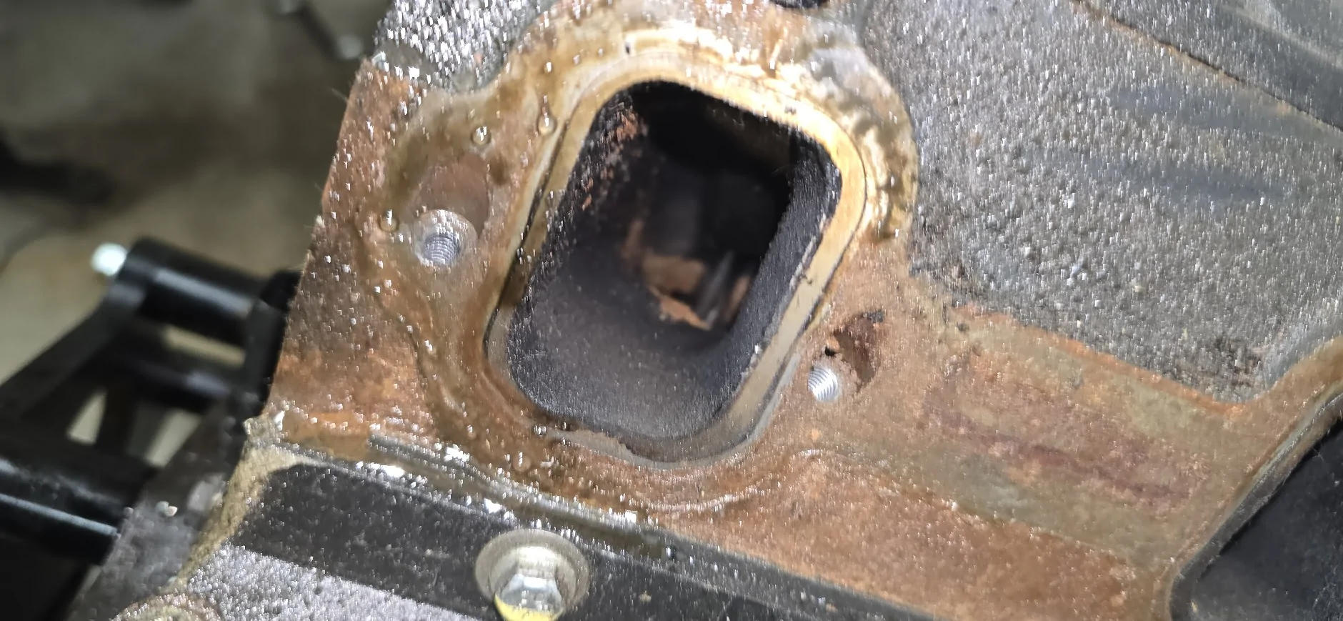

Picture drop, easy to see why this is desirable if you're at all familiar with engines.
BTW, the normal 8.8 is just a big 8.1, with a ton of the same hurdles to tackle, the R block is none of that.

That thing is huge.

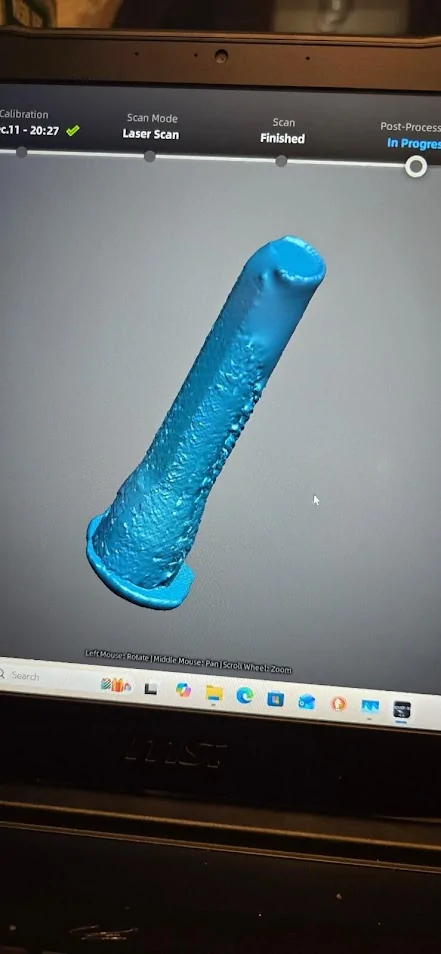

Part of this little oddball engine mission, is to gather as much data as possible for the community at large.
To that end, I got an Einstar Rockit 3D scanner to capture the intake, and entire engine for anyone who wants to design brackets, intakes, flanges, whatever.
Learning to use it last night, will definitely take some hours to get the hang of.

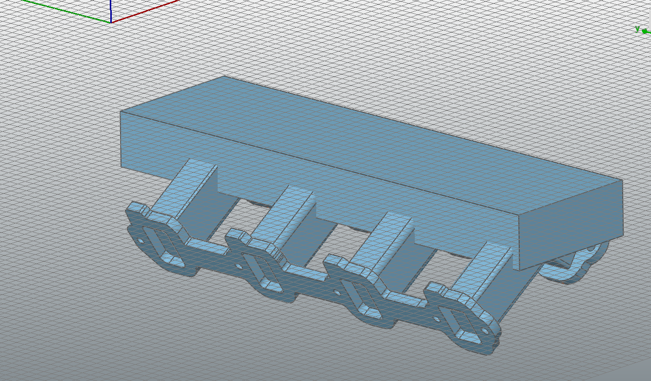

Some jerk is trying to charge 2k per download for a step file of an intake he doesn't manufacture or sell 🙄
I'm making it open source,
Idea is to model something with bolt on runners and a bolt on bowl with a Holley Hi Ram lid pattern so people can use any top they like, including blowers.

I never thought of printing an intake. Wow. What kind of crazy printer do you have?

Any printer in an enclosure with a hot end that can do 300+ can print the filaments needed for an intake.
I have a pretty basic printer. If I can do things like that at home, I might at some point do some research and upgrade. That’s so amazing.
