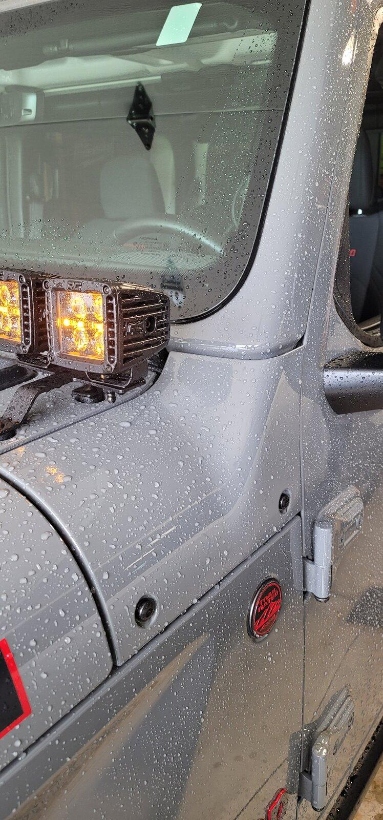

I looked everywhere and couldn't find an answer. Has anyone had issues fitting the Rugged Ridge High/Low Snorkel with a quad LED mount setup like I have in the pic?

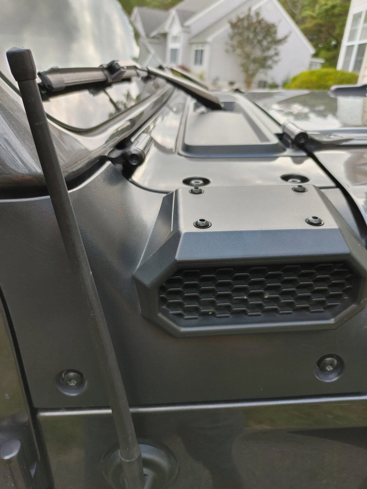

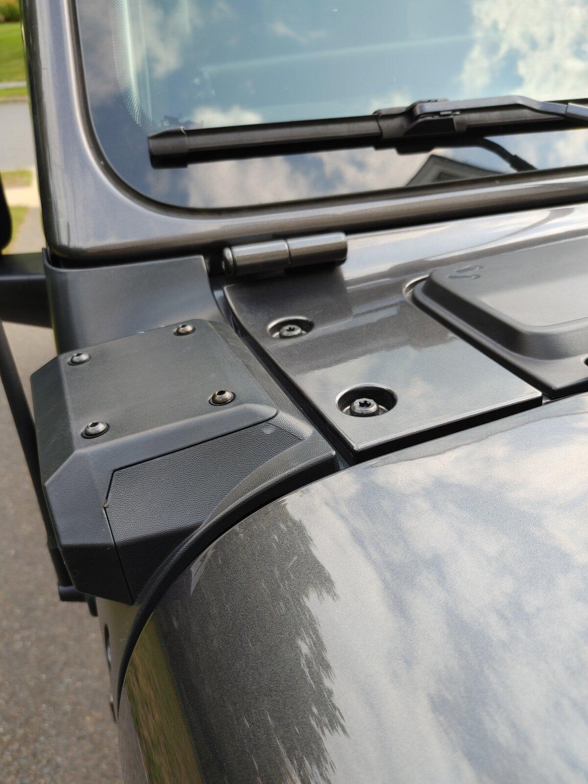

I don't have that type of light but I do have the snorkel. It looks like it should fit but it'll be tight. This bottom half "lid" comes off with the 4 bolts and the ram slides right in over top. It has a stocky base to it which is why I think it'll be a tight fit, but you can see that you have about an inch of play room from the edge of the cowl. I can't really tell from the angle how much overhang that outside light has.

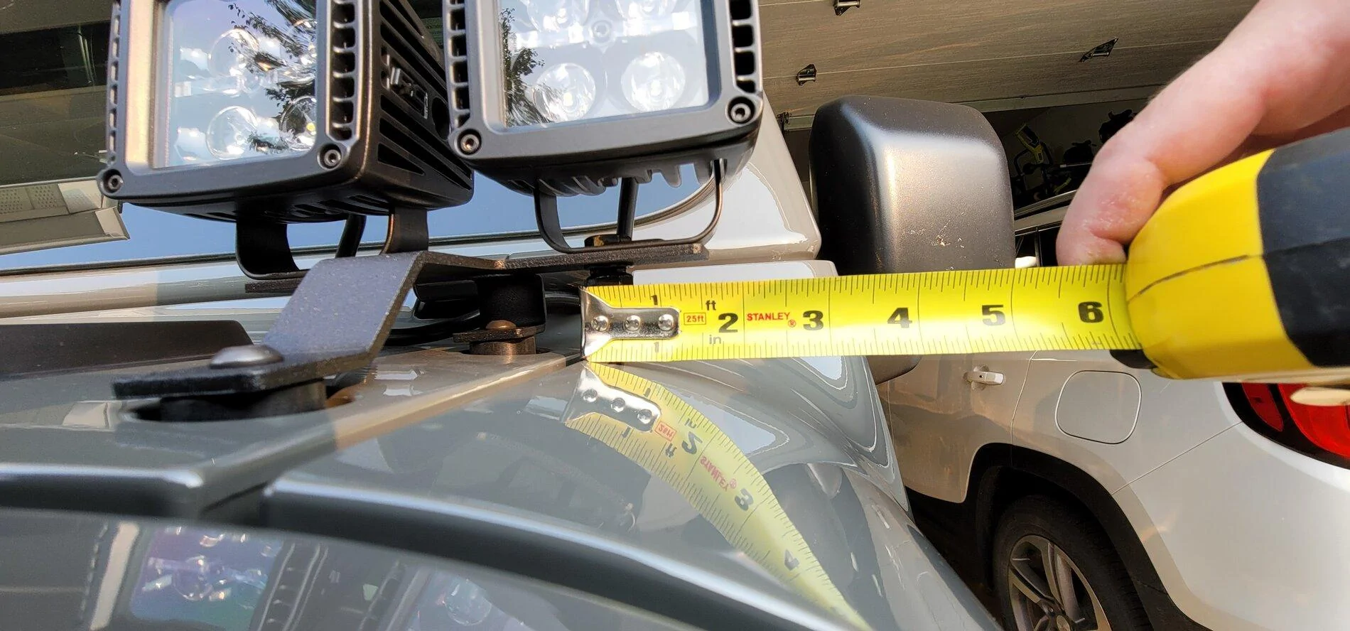

Definite NO on the upper, maybe yes maybe no on the lower.
Your bolt for the outward bound light is going to be directly over the lower cap. It may actually be into the lower cap. You would need to use a shorter bolt or cut the one you have down.
The upper just won't go. Any part of the light mount hanging over the cowl piece and the light attached are in real estate the upper snorkel needs to be installed.

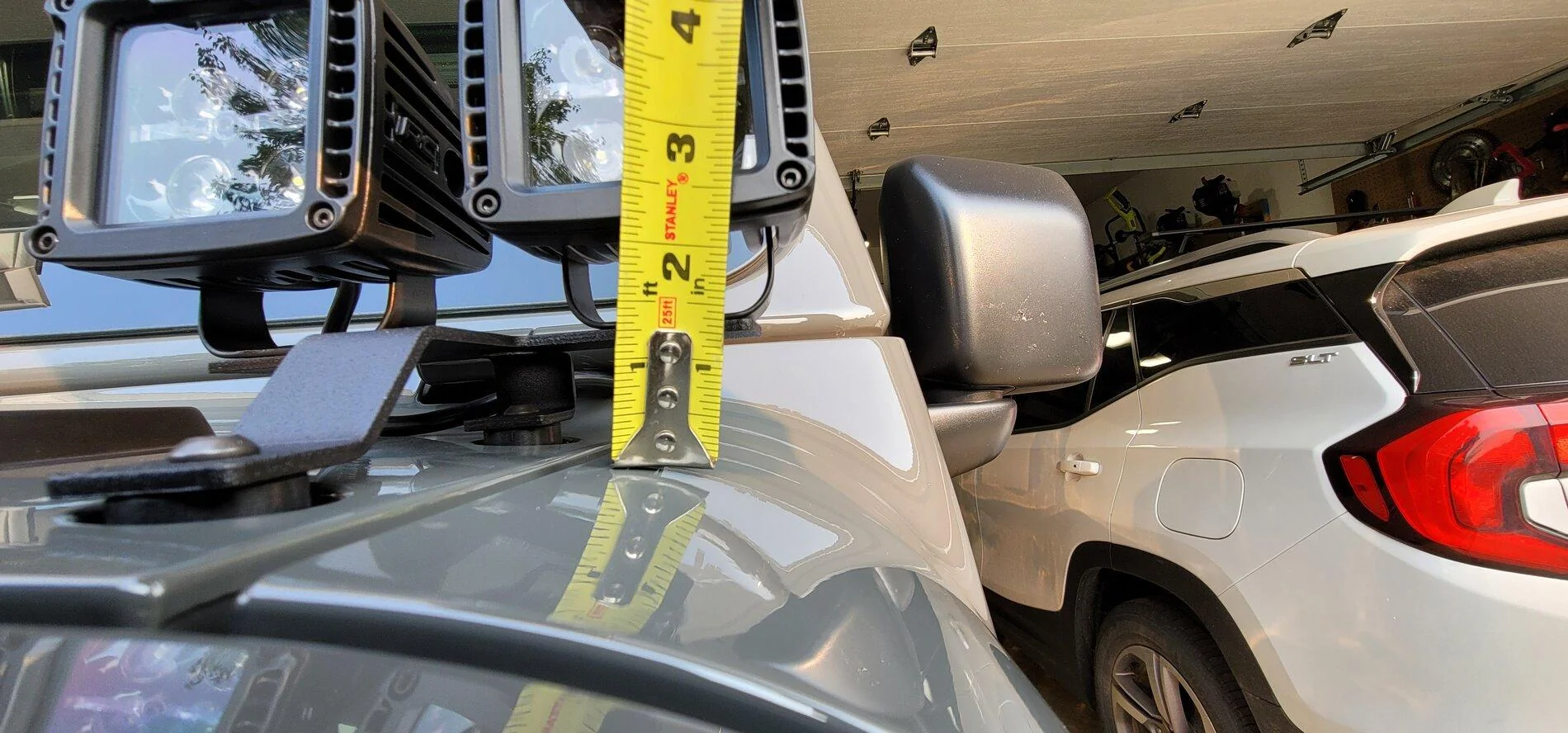

That's what I was worried about. I just took measurements and it looks like it may not be a go with that existing light mount setup.

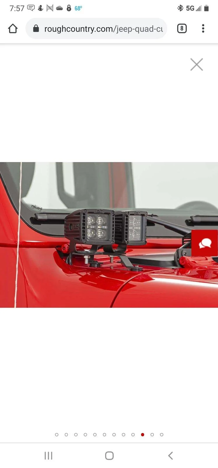

Personally I think it might barely fit. Are you more sold on the snorkel or the light mount?
You could always return whichever if it doesn’t work.
I have some that also use the windshield hinge bolt, I like them but they wouldn’t fit with the snorkel.
Have been looking at the snorkel and what light mounts would fit.

Oh yeah that sticks out way further than I thought. Let us know what you decide!
