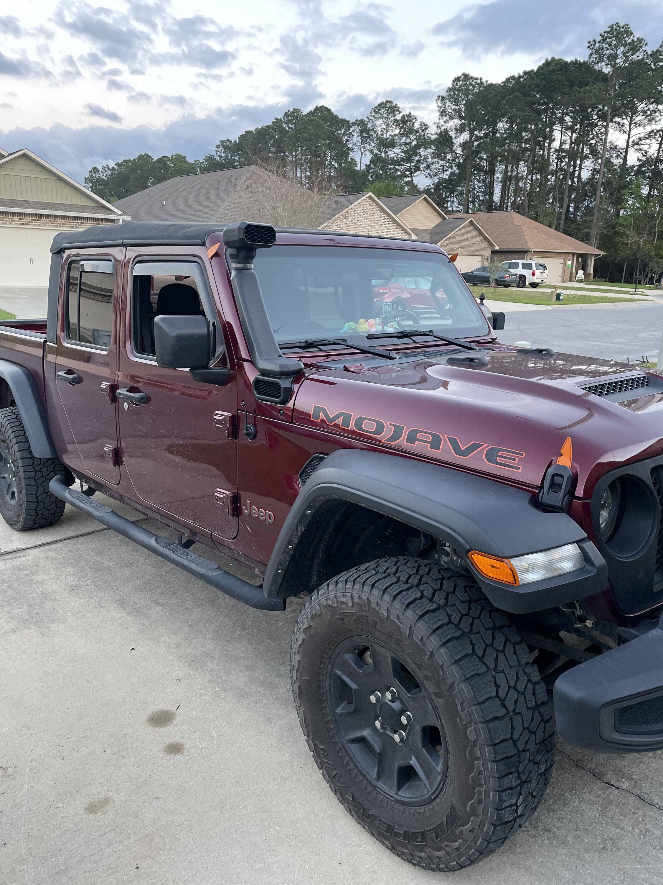

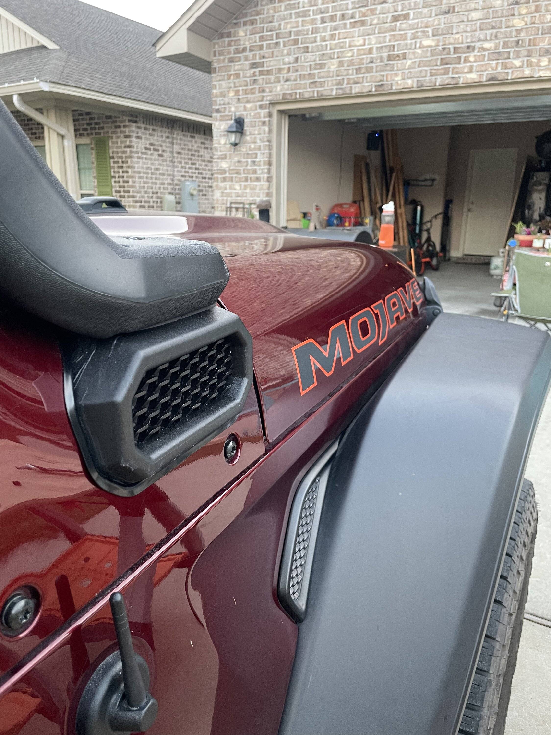

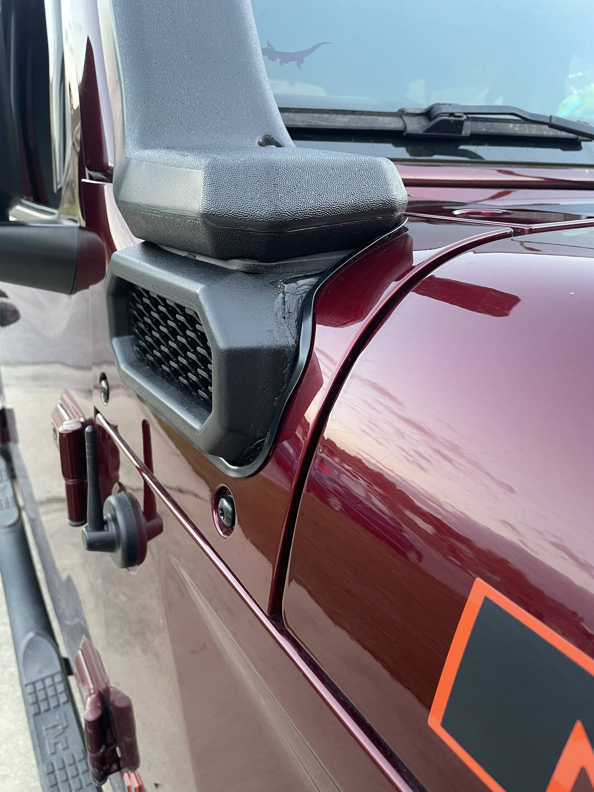

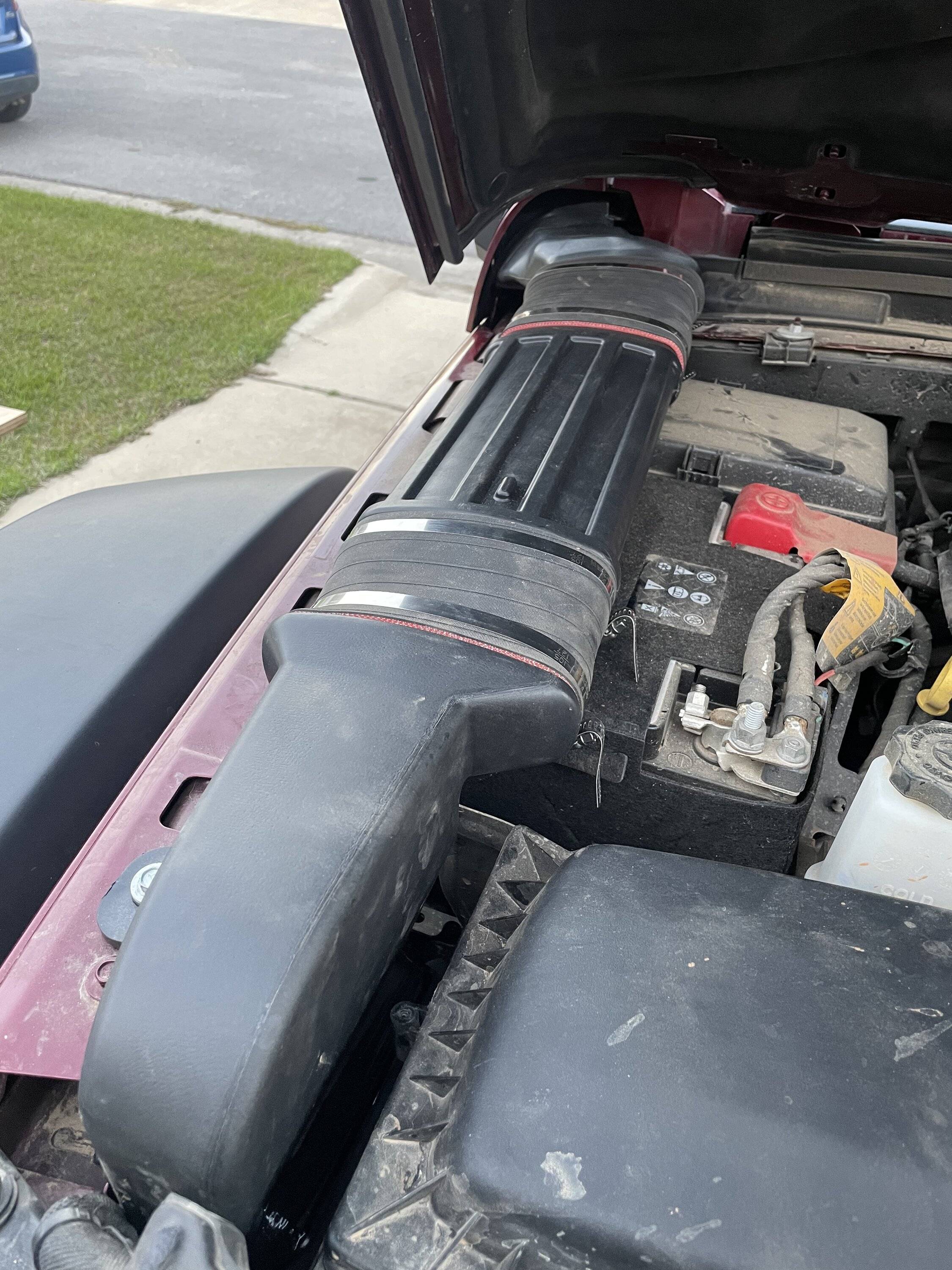

I know this is an old thread and chances are you've gone in a different direction but, for the sake of being helpful I found this guy on youtube that modded his cowl to work with the RR amfib snorkel. His process was super in-depth however, I reached out to him via Facebook and he happily sent me a template so I could do it for myself. Here's the video:
If you aren't opposed to cutting up a perfectly good cowl, its a great solution.
