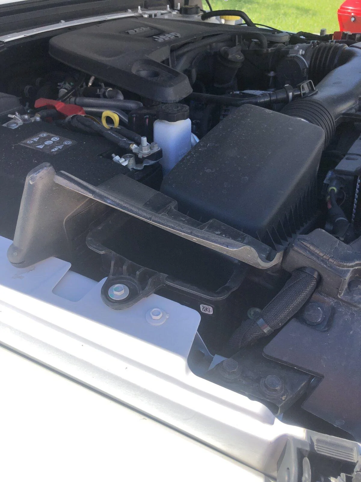

If you look up the member HRDWURC, he has the mopar one installed. Took a little modification to the bracket and instead of using the template to cut the hole in the hood, he said it would be a tighter fit if you cut your own hole, because the hood sits up higher.
When I get around to it, I’d like to modify an AEV snorkel since none of them bolt right up, plus I want to use the cyclone prefilter.

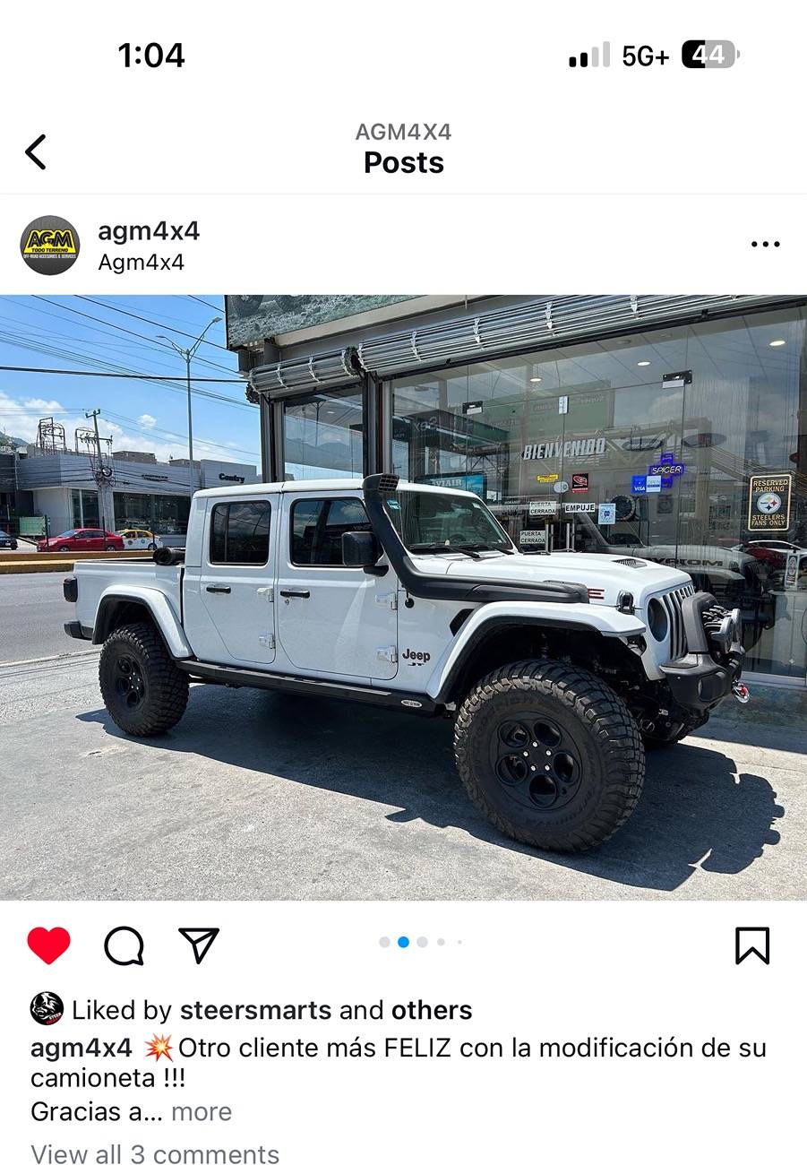

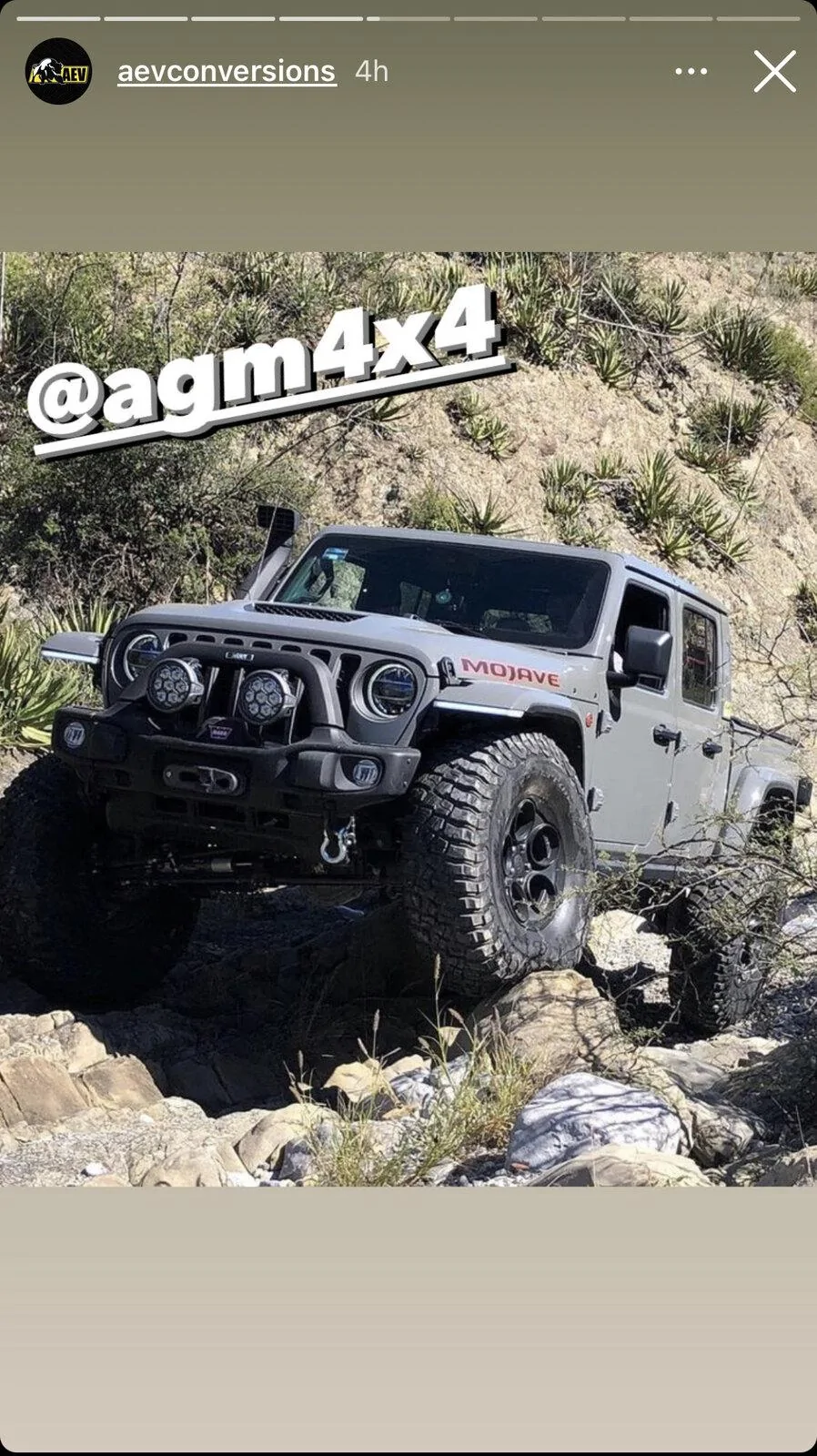

Hey everybody, just saw AEV post on their story that AGM4x4 in Mexico had a Mojave with one of their snorkel’s on it. Just wondering if anybody had seen anything as AEV’s website still states their snorkel doesn’t fit the Mojave.
Jeep Gladiator Anyone install a snorkel on a Mojave? 4FFC02A2-E067-45A1-9A6C-6B6E9433A46A
Hootbro
Apr 13, 2019
10,206
20,002
2025 Gladiator Sport
Might be a developmental one off for AEV and maybe one is coming down the line?

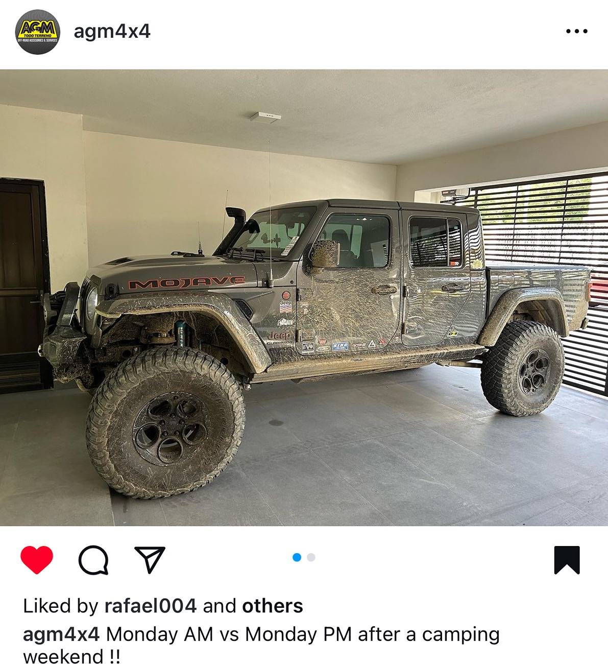

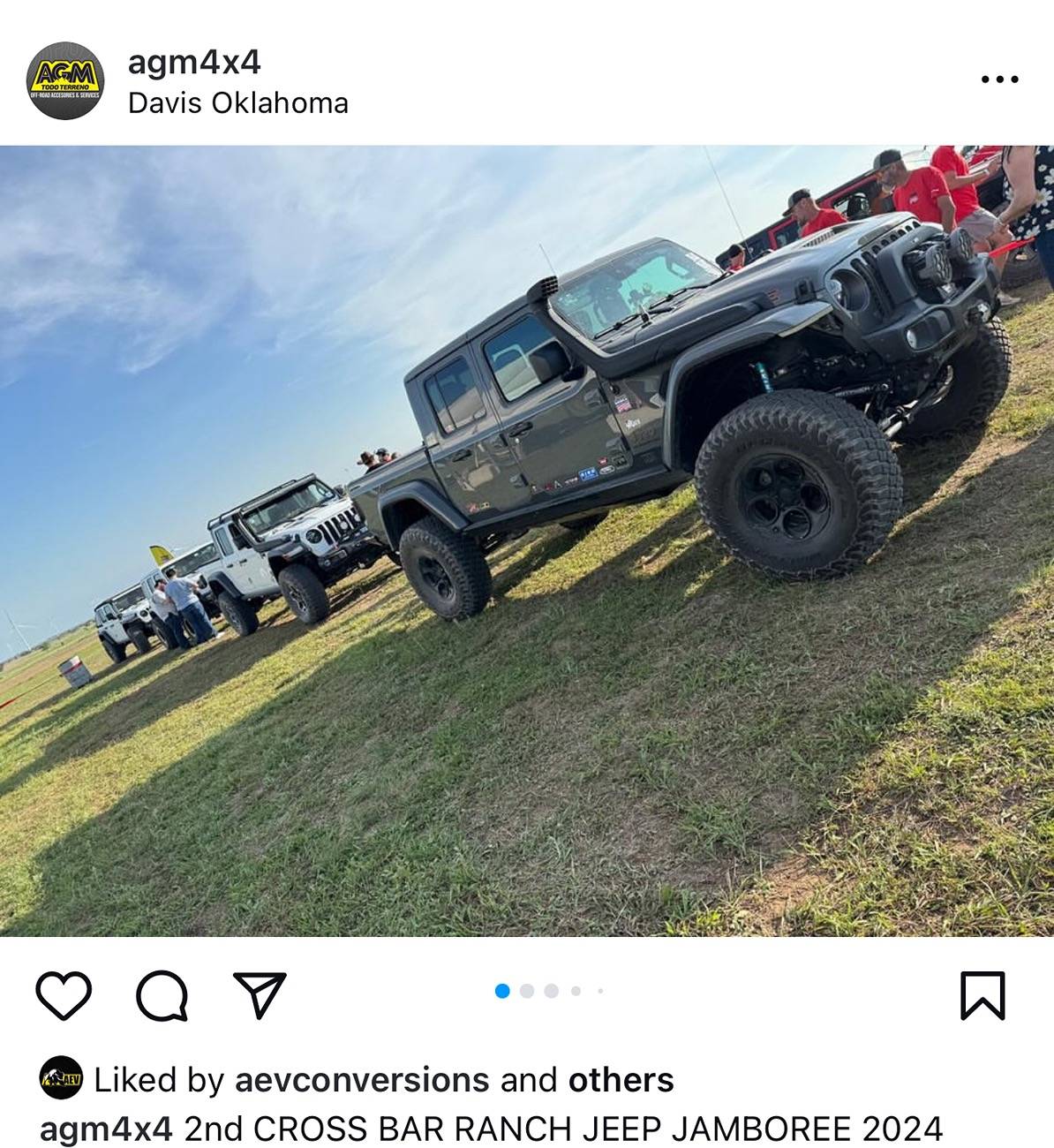

I saw an Instagram account that put the aev in several Mojave
Jeep Gladiator Anyone install a snorkel on a Mojave? IMG_9126
Jeep Gladiator Anyone install a snorkel on a Mojave? IMG_9125
