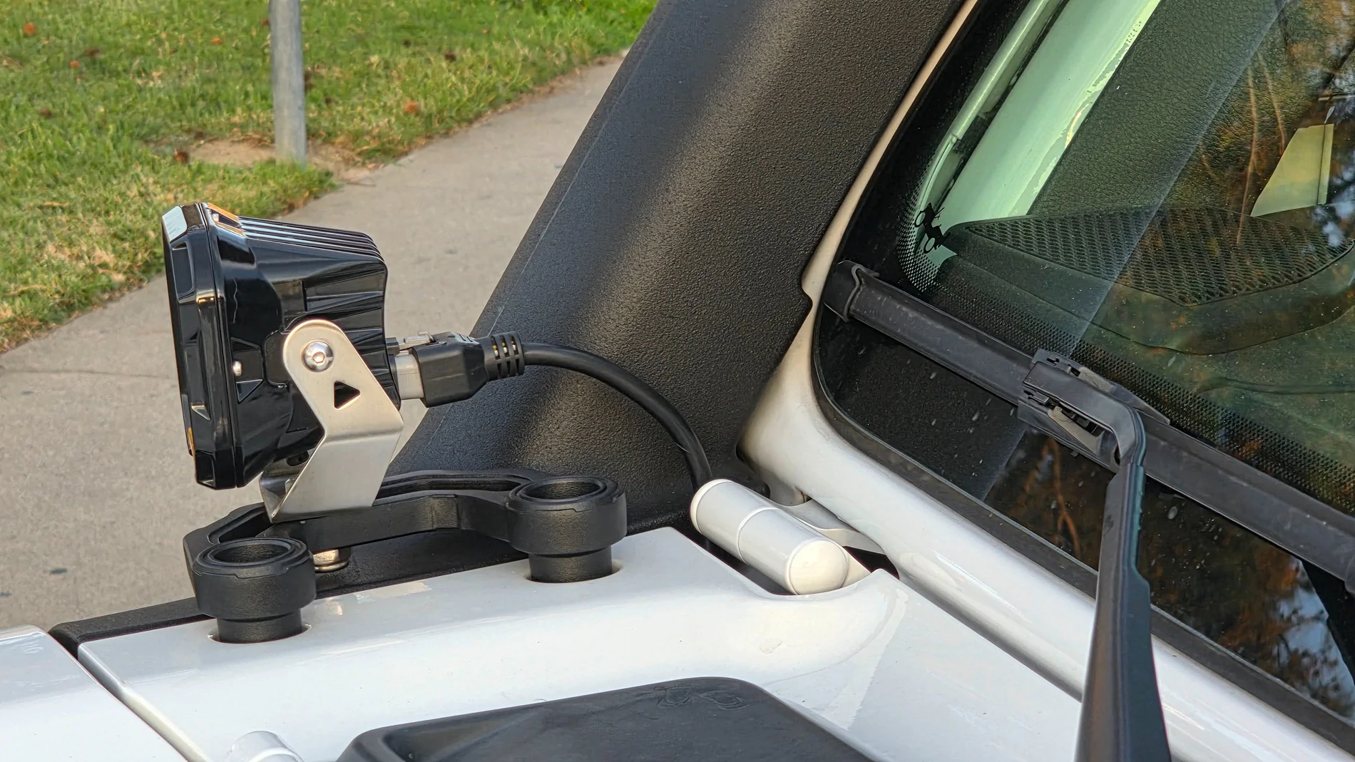

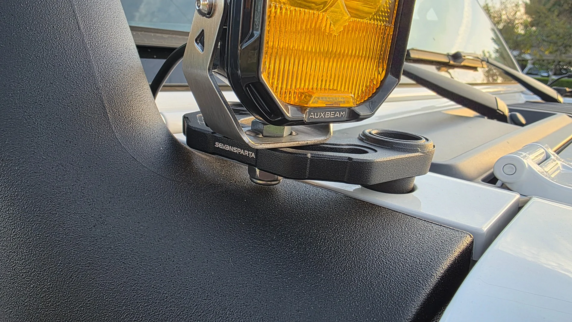

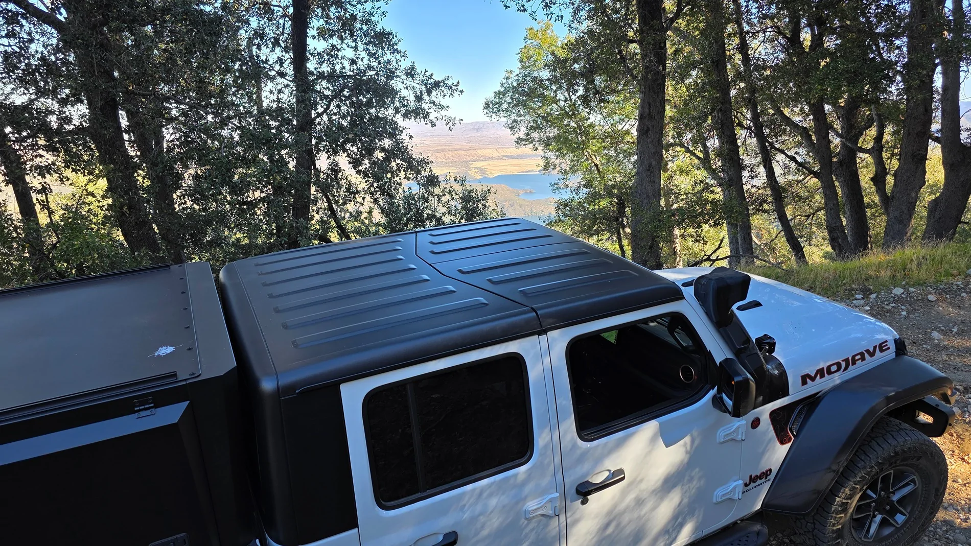

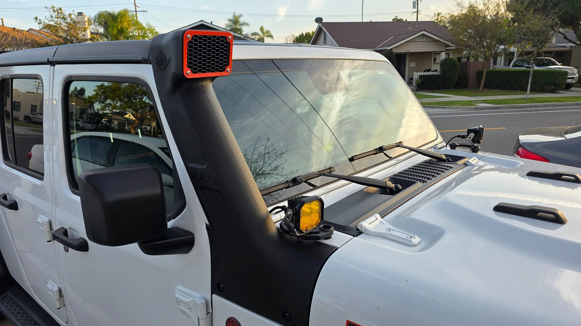

I have this aFe snorkel. Had it about 4 months now. It works great, looks good. No cutting! And even more amazing it fit with my ditch lights. I have a SevenSparta light mount I got on Amazon, and it fits just under the mount. That was a bonus! I think my gas mileage also improved by about .5 or 1 MPG due to the way it rams air down the snorkel on the highway. I'll take whatever I can get!

And the ditch light mount was my only worry. Thank you!
edit: do they have one that is a double light mount, top and bottom? *crosses fingers*

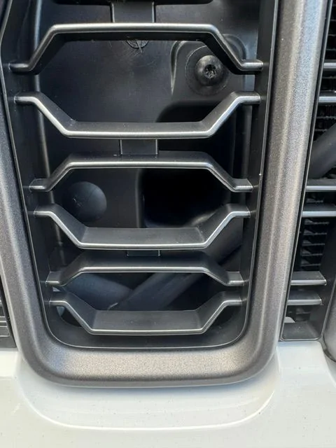

I had an AEV snorkel on my JKUR with the AEV hood. It was quiet but didn't realize any performance benefit since I didn't follow others kicking up dust off road. My factory stock 2025 JT MojaveX with the 3.6 engine already draws cool "ram" air from an air inlet opening in the grill (passenger side) to the filter airbox (see pic below). Your JT with the 3.6 motor is probably the same airbox. Chasis dynometer tests of an aftermarket cold air box on the JT showed a loss of power over an unmodified factory airbox which is well designed and efficient.
I haven't looked in awhile, but as far as I know it's only a single light mount.
