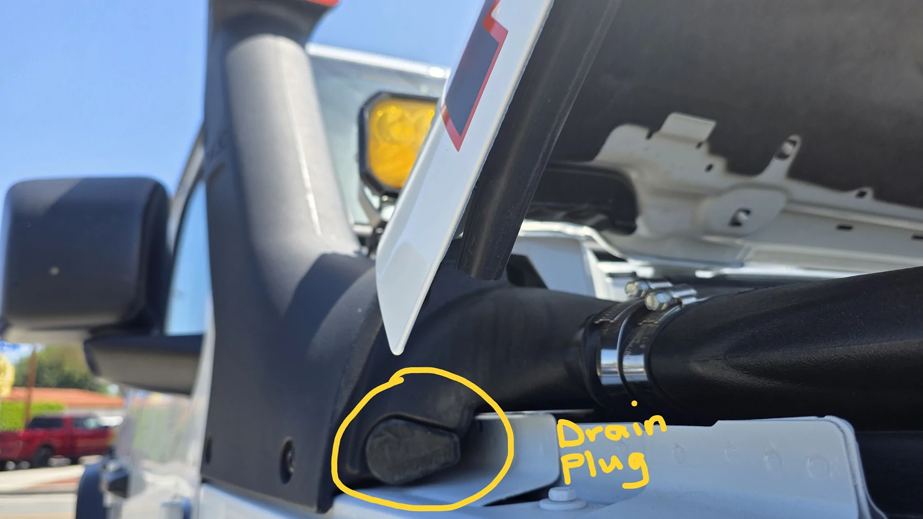

The aFe snorkel has a grill covering the opening. I've never had anything get stuck in it yet. Only thing you have to watch out for is too much water going down it, like if you were driving in a heavy rain storm, or while washing it. But there's a drain plug you can leave open if you know you're going to be in prolonged rain. Otherwise, I've had no debris getting in, and regular rain has not been a problem either.

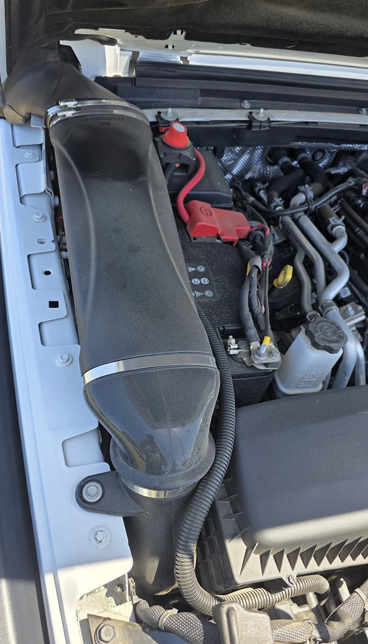

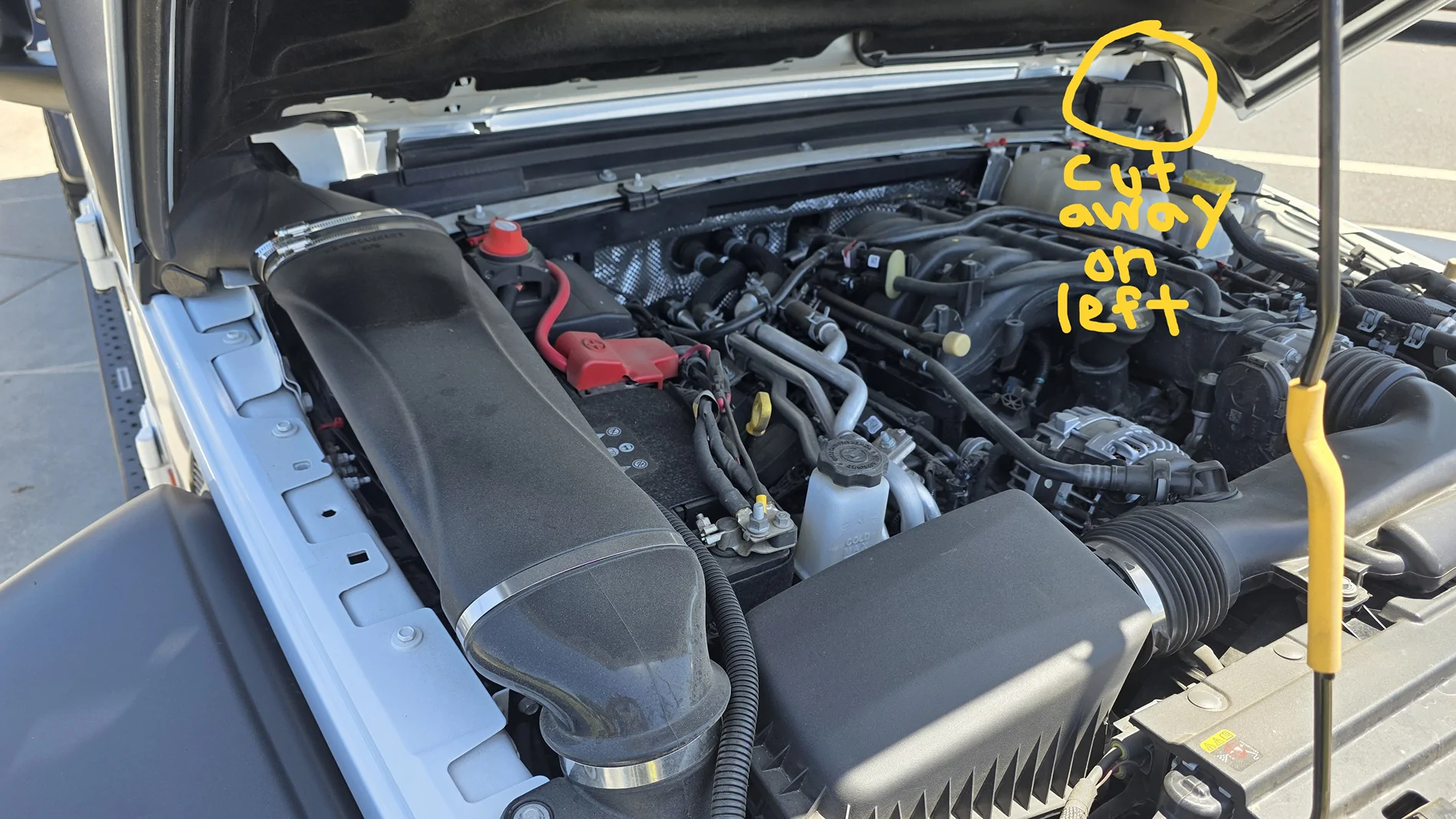

Well, I didn't actually install this. Long story short is, I got invited to pilot a prototype for the Mojave, and then they installed a final product for me when it was done. So I didn't really have to do anything. But from what I got from the guy I worked with, it's not too hard. You do have cut out one piece of insulation from under the hood (I attached a picture of the right side so you can see the piece that has to be removed). The rest goes in fairly easily, and ties in to the existing airbox.
It is NOT waterproofed for deep water fording at this point yet though. You still have to seal some things around the airbox to make it ready for deep water fording. I have not done that part.
Anyway, hope this helps!

It does look well thought out with the use of the cowl side piece and the use of the gap in the cowl for a pass through. Looks like it will take longer to get out a screw or nut driver to undo the clamps than to remove it to access the battery and stuff. It feeds air from what is usually a cleaner or dryer location than the stock intake maybe it will help a bit by allowing more air if the existing intake tube is a restriction point and the flow is inadequate. It is not going to increase MPG since the air and fuel are kept to ratio by the computer it would be a good addition to increase air cleaner life, fording level if everything could be sealed and it does look like it belongs it does seem a bit expensive although i am sure they spent a lot to develop it and set up the manufacturing process.

Yeah, it is a bit pricey to be fair. Also, if you see in the pics where the two adjustable hose clamps are, you can loosen these and pull that whole middle section out to access the battery. It is LITTLE bit of a pain in the butt, but it's not too hard to get it out and back in.
