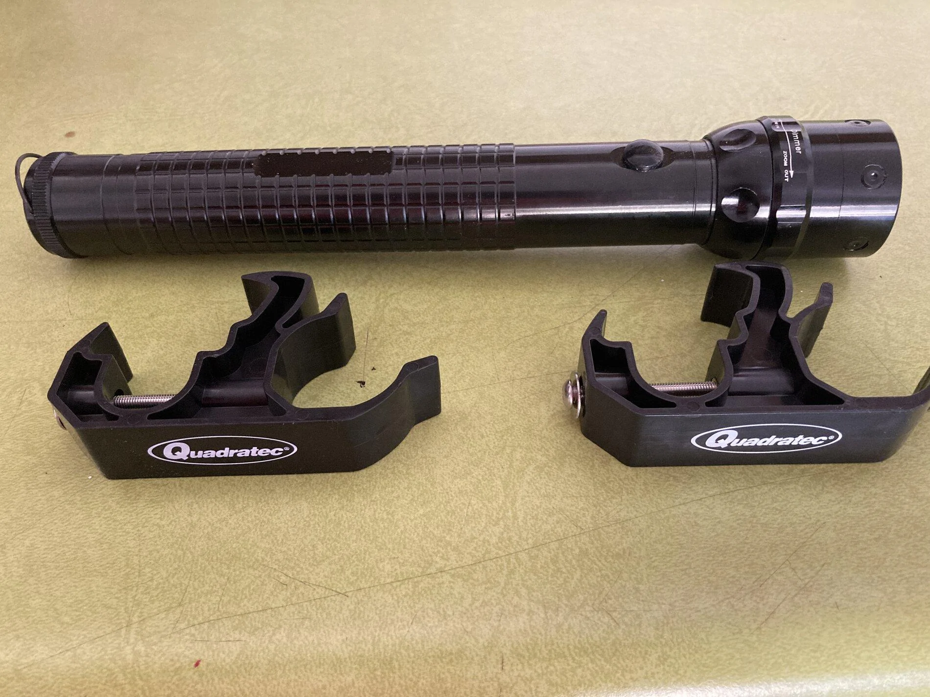

For those of you with the quadratec flashlight holder, I chased a rattle for a week, turns out one of the screws came loose, so the screw and washer were clanging together. Just thought I’d pass it along. ?

Will it let the flashlight become a projectile in an accident? Just curious. Haven’t purchased one yet.

Will it let the flashlight become a projectile in an accident? Just curious. Haven’t purchased one yet. Lol. , don’t think so, it’s actually a nice accessory, just informing fellow keepers that if a screw comes loose, it will begin to rattle. Took me I week to locate the rattle ?

Never thought about it becoming loose, I guess I'll check mine. That would have never been on my list of things to check for a rattle.

We need a picture of this flashlight holder in this thread.

That’s cool too ! Gotta pay to play ?. It’s all in what ya want for sure. My only reason for posting was tha rattle I I cured, I drip of thread locker will resolve that. Overall, a good quality fit and nice look ! ?

I would also add that there is very little margin in gaging how tight to get the mount screw before the insert pulls and cracks the mount. It is not the best use of materials as it relies on spring tension of plastic.
