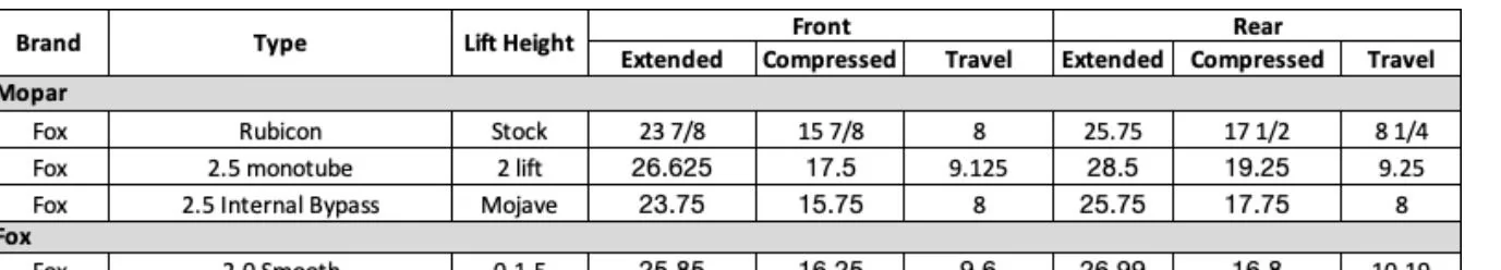

You could probably get away with less bumpstop with that kit if you’re willing to tinker. That lift comes with very modest travel shocks and I wouldn’t be surprised if you’re not using all the available up travel with that size bump.
Find a ditch, loading ramp, fork lift, or rti and take some measurements - go from there.

I take that back, though the travel is not great, it appears the 2” bumpstops are inline with the difference in compressed length.
Jeep Gladiator Question about Mopar 2” bump stops AE3EA113-A7B7-4C5B-B17E-9B97F2022A24
super lame. thank you though for the information - not sure where you found that table..
I wonder if Fox has other shocks outside of the MOPAR kit that have a shorter compressed length and a longer extended length.

They do. You can get standard Fox 2.0s with better specs. I have a table saved but it on my work laptop so I can’t post it at the moment. The info is out there though.
