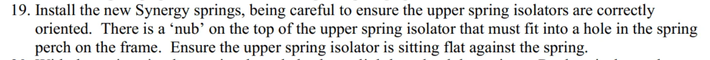

This is out of the instructions booklet:
The new Synergy springs are stamped with a part number. The last two digits of the part number indicate which side of the vehicle they go on. The -01 is the driver side (left) spring. The -02 is the passenger side (right) spring. The flat end of the spring is the bottom.
Are the springs on their respective sides? The full part number will be on the coil. While not expressly stated, I also aligned my springs so the part number faced outward as shown in their figure 2 example. This may or may not mean anything and just my OCD to some degree.
While he has that back there for the bow correction - that should be checked (although it wn't cause the bow if they are switched)
Shouldn't matter with their springs - flat on each end, the way the coils are made, but I did the same or as close as I felt like getting after wiping the sweat off.
I never bothered looking to see if the part numbers are always, consistently, on the exact same coil section of every spring they make or if there's some deviation. I'll have to open up my 1" synergy springs and take a look.
Anyway, while it's back for the bow problem, good idea for them to check correct left and right placement.

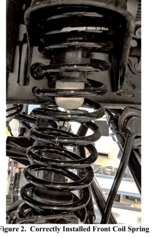

Correct - at least for gas powered.
Jeep Gladiator Synergy front springs 8863-10 question/ BUMP STOPS 1712012904281-ek
Jeep Gladiator Synergy front springs 8863-10 question/ BUMP STOPS 1712012987483-v7
And referencing Hootbro's comment - they don't say, but............ implied by picture???
Jeep Gladiator Synergy front springs 8863-10 question/ BUMP STOPS 1712013092263-fv

My luck , both stamps are rotated inwards and not visible but I did tell them 3 times and handed them 2 copies of instructions. One I printed and 1 that came with them.
