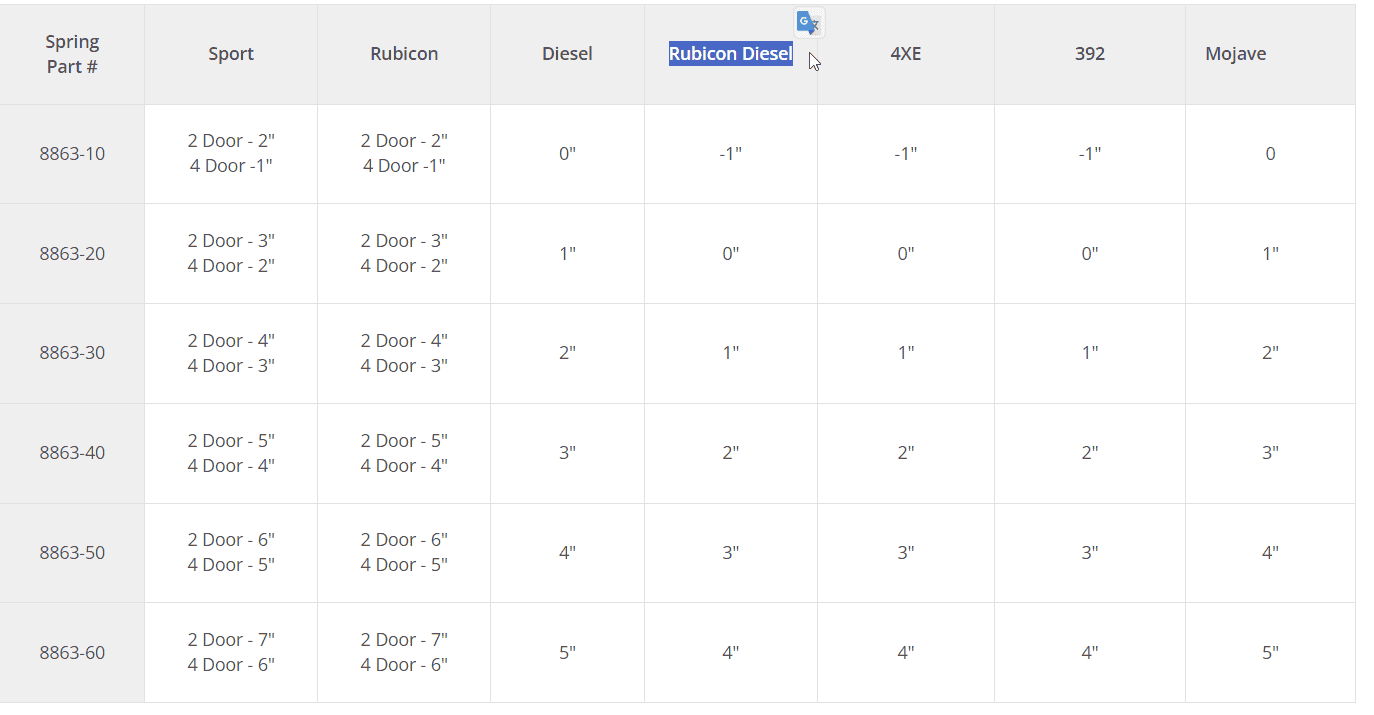

Looking to find someone who has used the Synergy 5" or 6" springs on the front of the Rubicon Diesel. They only rate them at 4" (table from their webpage below) for the tallest they have when used on the Rubicon Diesel. I am trying to go taller then my Evo 4.5" springs that were installed in 2021 with the Evo enforcer kit. Would be great to compare a few measurements with someone that has these installed.

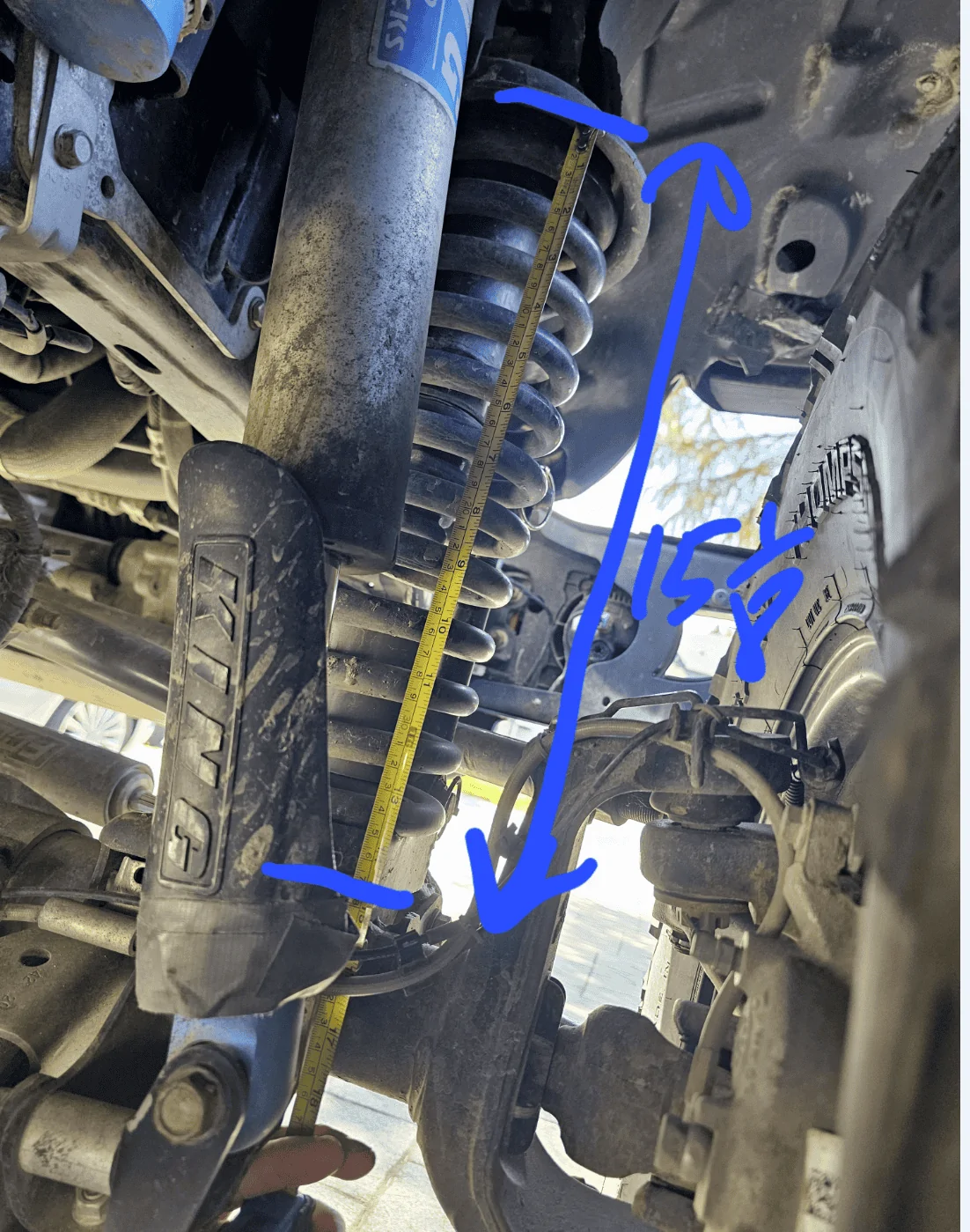

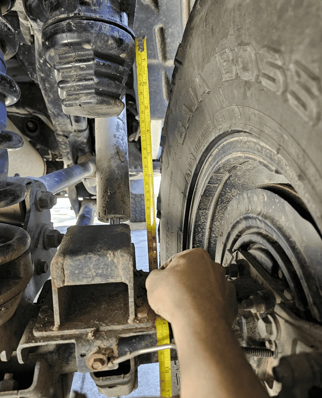

@deserat Any chance you could take a couple pics/measurements for me with your current setup?
Front: upper lip (flat face)of the spring seat bucket to the metal base the lower rubber isolator sits on (I measured from the rear right corner of the lower spring seat straight up)

Rear: Upper lip of the bump stop to Lower metal flat sheet the bump stop sits on (center of both)

Same as you in the front, 15 1/8. In the rear, 8 7/8, with about 150 lbs in the bed. My rear looks to be a couple inches lower than your, interestingly given you have twice the weight.
I do have coil bow, front and rear. That's with about 7 degrees castor and long arms front and about 4 degrees pinion angle in the rear and adjustable arms.

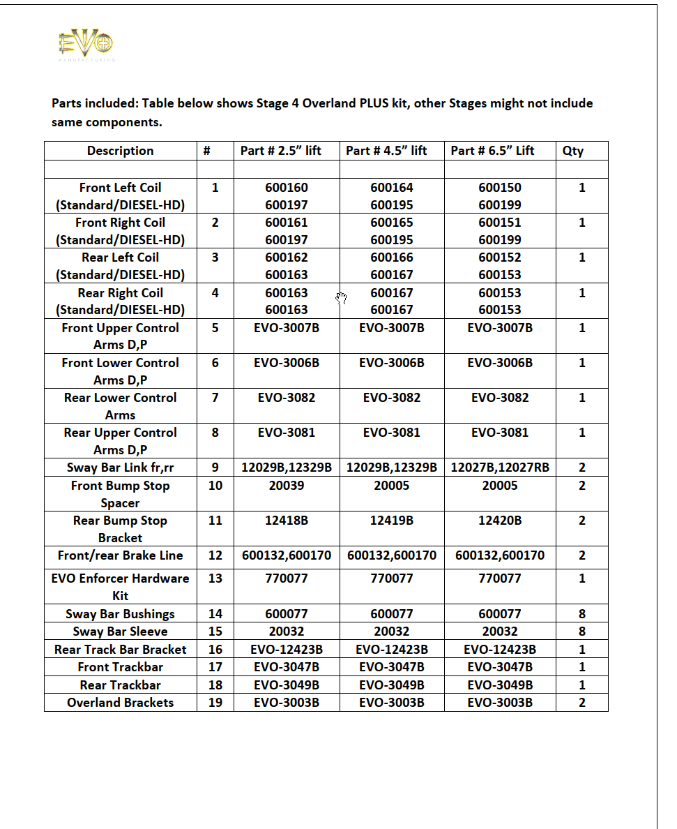

Looking at that I guess I could go with the EVO 6.5" HD fronts and then look for a stiffer 4.5" rear. It's too bad EVO won't divulge their spring rates, makes it's hard to know how different another manufacturers spring will be then theirs.
From the install pdf for the EVO Enforcer kits:
https://www.dealer.evomfg.com/technical-docs/EVO-3060-3061-3062-3063-3064-3065.pdf

Would love to hear from someone who has gone from EVO HD diesel springs to Synergy to get an idea if the synergy are a stiffer rate.
