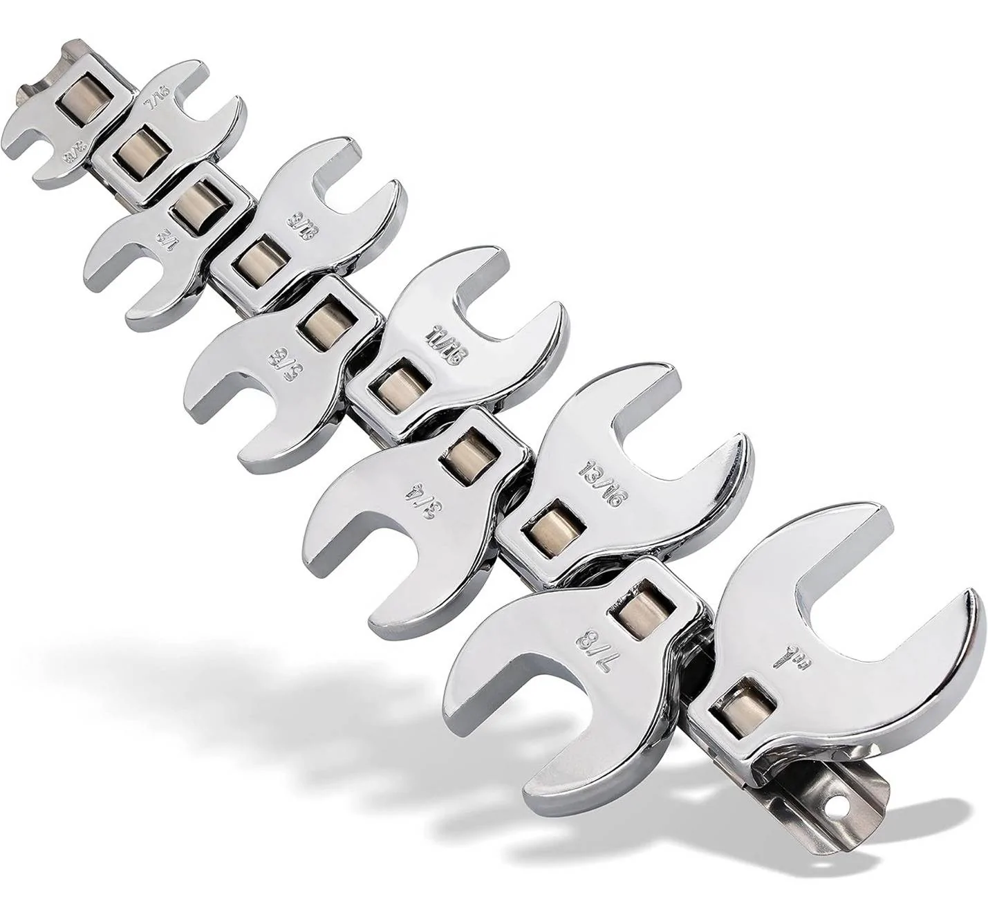

Definitely support the axle with two jack stands and remove the wheels. For bolts that need to be torqued and can't be reached with a torque wrench, you can use a crow's foot on the torque wrench.
This is the way
