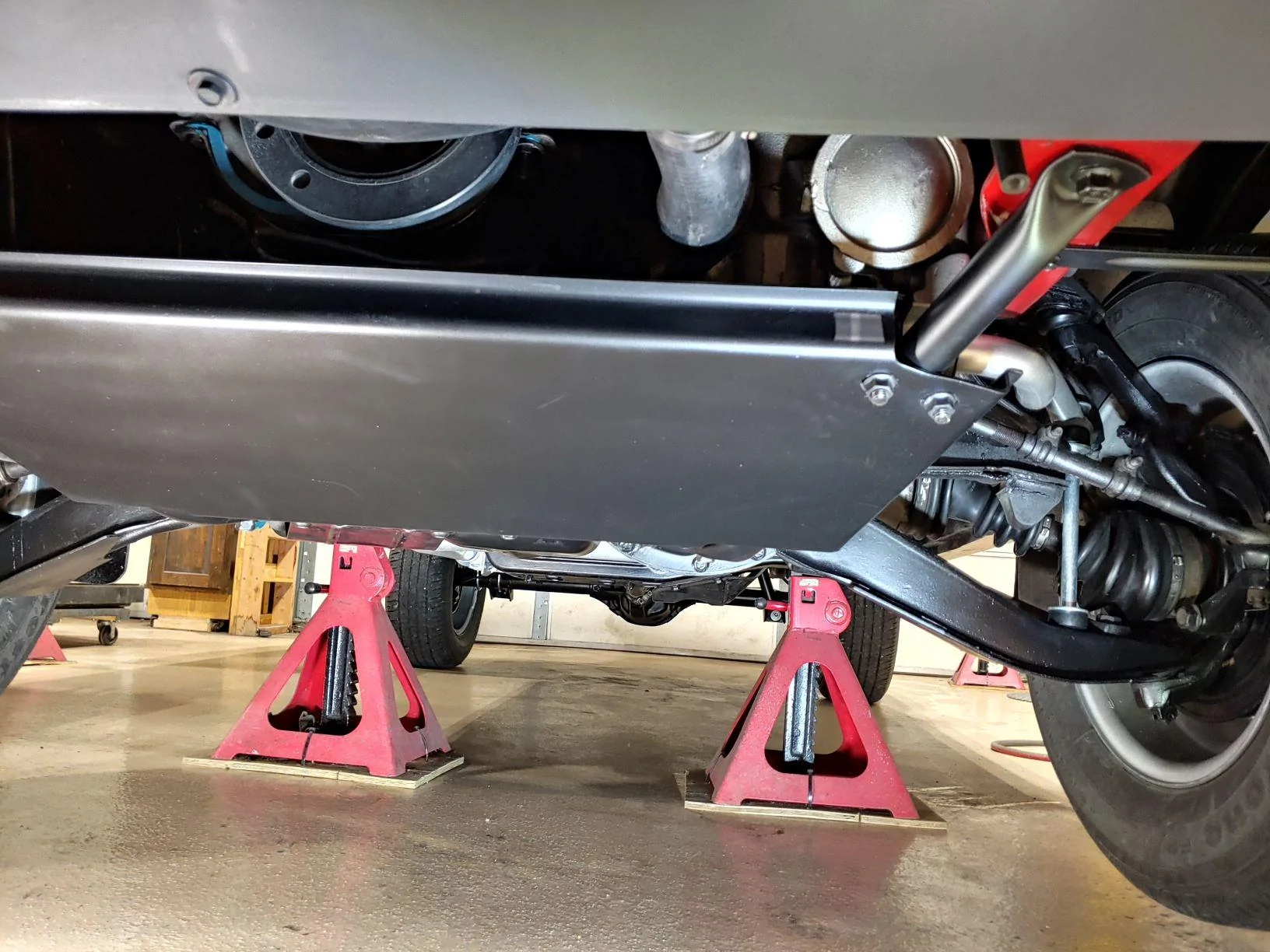

I can assure you that you're not knocking a properly supported truck with a 2ft torque wrench unless you're doing it wrong. Good jackstands make a difference (e.g. pin instead of ratchet and overrated for your vehicle) and bonus points for some with axle cradles if you're supporting something round.

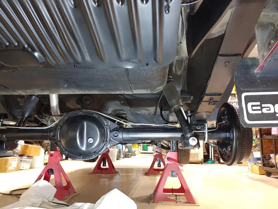

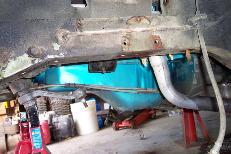

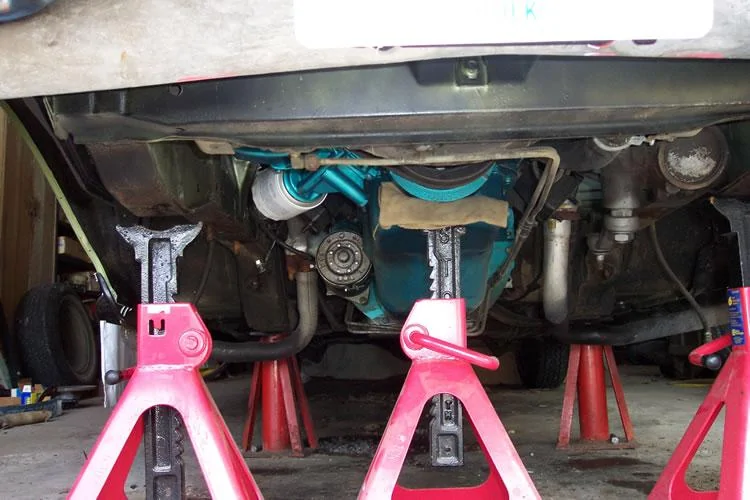

My stands are capable of 4 times the weight of the truck. I have a set of 4 of NAPA's best from 25 years ago. Yes, they are ratchet but they are built like tanks. As long as you ensure the dog is in the rack properly, it can't go anywhere. The frame of the stand is heavy gauge steel and welded properly. I've had then that long and there's still no rust to speak of - the finish is good, the welds are great and I've had straight trucks supported on them.

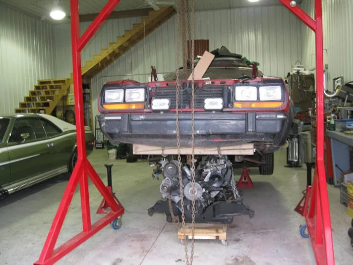

I had a pair of them under the rear axle of my car while I lifted the front end with a gantry crane - that meant that more than just the weight of the rear of the car was on them - the car for a while was over 30 degrees in the air. The stands have a nice curve to the top and hold an axle tube securely. The axle tubes rotated nicely in the stand cradles, never climbing out.
I use those stands when I need to put 250 pound/ft of torque on the rear axle to hub nuts as that axle can't move, it has to be on something solid. .
The stands I made sit on a steel plate, are heave gauge pipe (not water pipe) and I use a 3/4" pin through holes in the inner pipe to set the height. The outer pipe is braced to the steel plate with heavy angle iron running from the top of the outer pipe to the outer corners of the plate. Those are what my tractor sat on - I made them for that purpose. My bet is that they'd each hold up 10,000 pounds.
