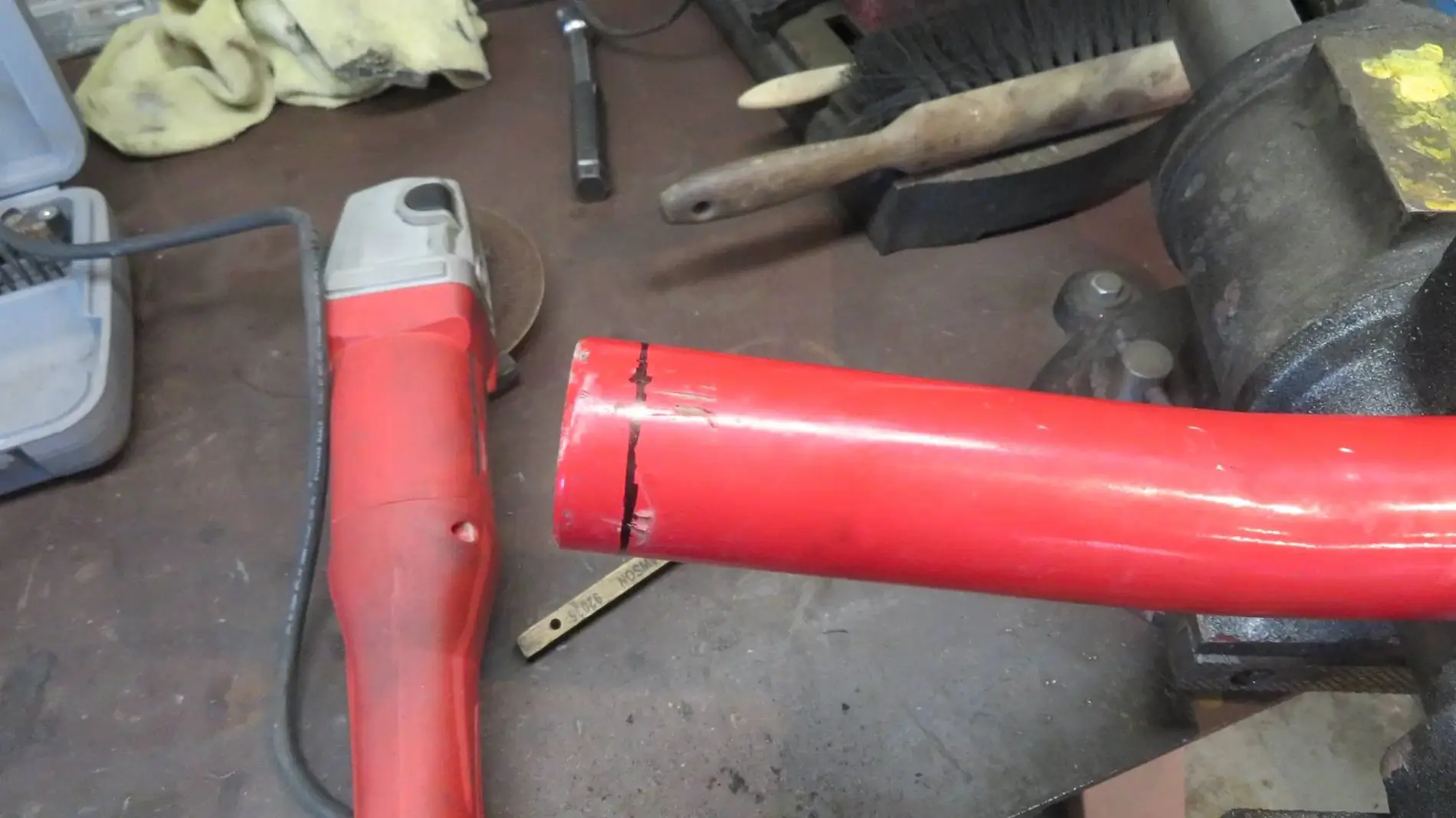

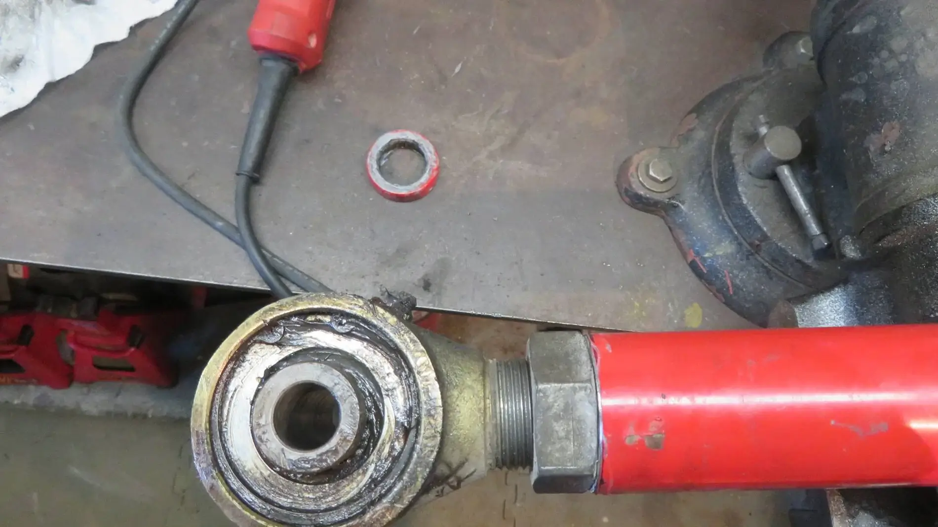

I have the Crawl series. Using Teraflex geo brackets. Had the same issue with the coil spring hitting the Steersmart brace. I cut about 1/4" off of the lower control arm to get it to the length I wanted.
Grease fittings. On the lower arms, I have mine pointed up so that they don't get ripped off. The upper arms are pointed down for easy of getting to them. I bought a Lock & Lube grease gun just for greasing the joints. Love the coupler that comes with the gun. I use Johnny Joint grease from RockJock. I also bought the 2 different size tools to work on the joints.
