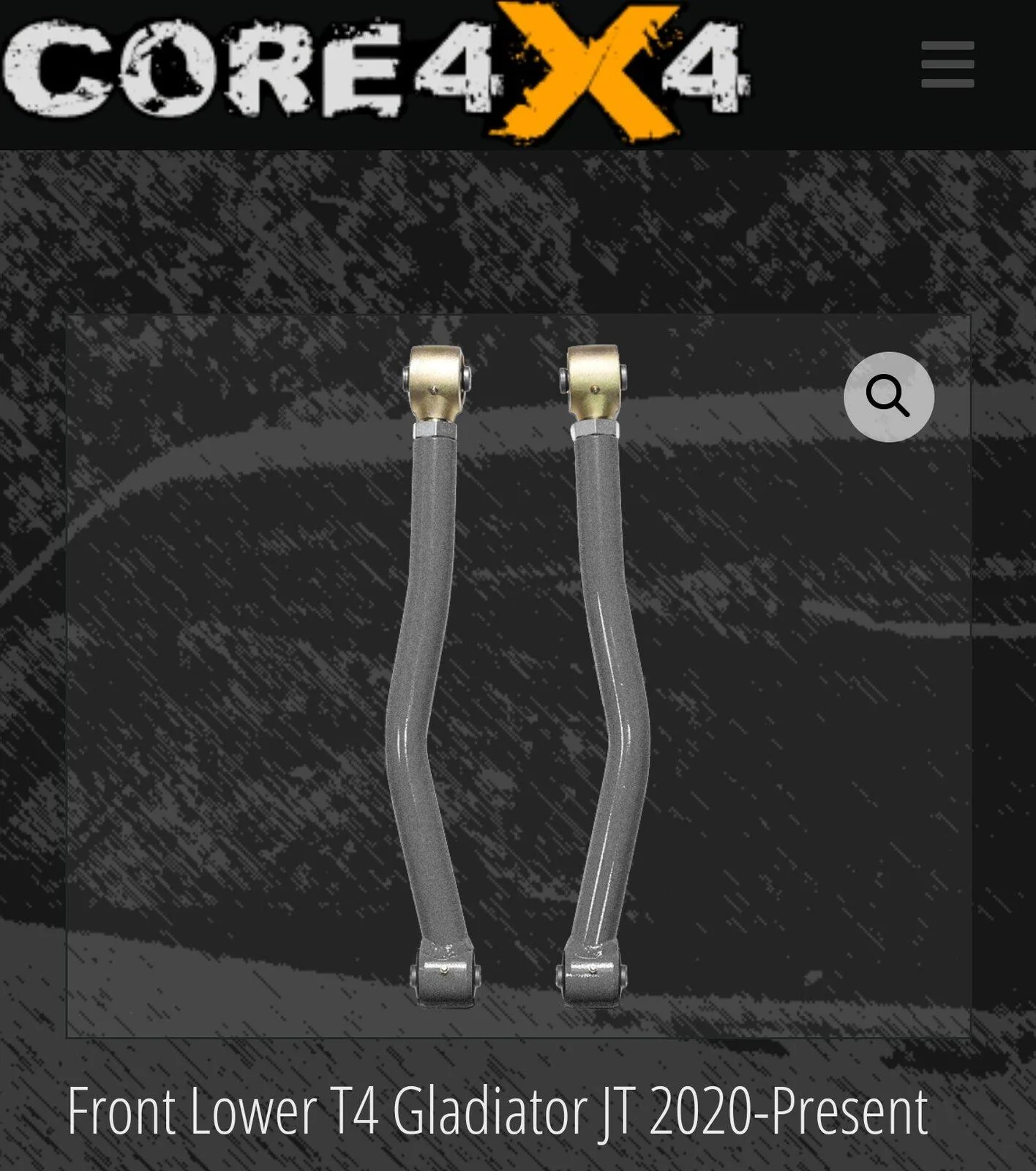

Deleted member 30519
I was wondering if it's worth upgrading the lower front control arms with core 4x4 adjustables and waiting to do the rest later. I've been running a 3.5" coil lift right now with a rubicon express rear adjustable track bar and front adjustable track bar.

I just ordered the core 4x4 t4 front lowers. Thanks for the help guys. I figured charcoal would be the closest thing to my billet silver and silver shocks and coils.
Jeep Gladiator Worth upgrading the lower front control arms with core 4x4 adjustables? Screenshot_20210221-200142~01
