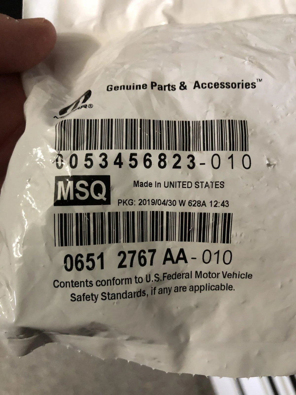

‘Got the rails today and they are quite beefy!
Unfortunately they didn’t come with any screws/bolts. Do you happen to know the part number for those?
Thanks!
The bolt part number is 06512767AA.

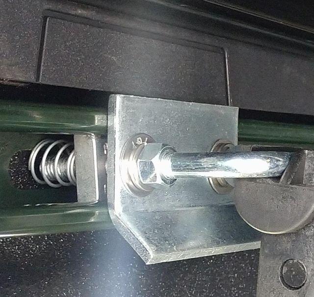

I originally had low-profile unistrut, painted it black.
The anchor nuts slide easier in regular height. Regular is also more flush with the bed sides.
Unistrut clamps used as anchor points for the tonneau.

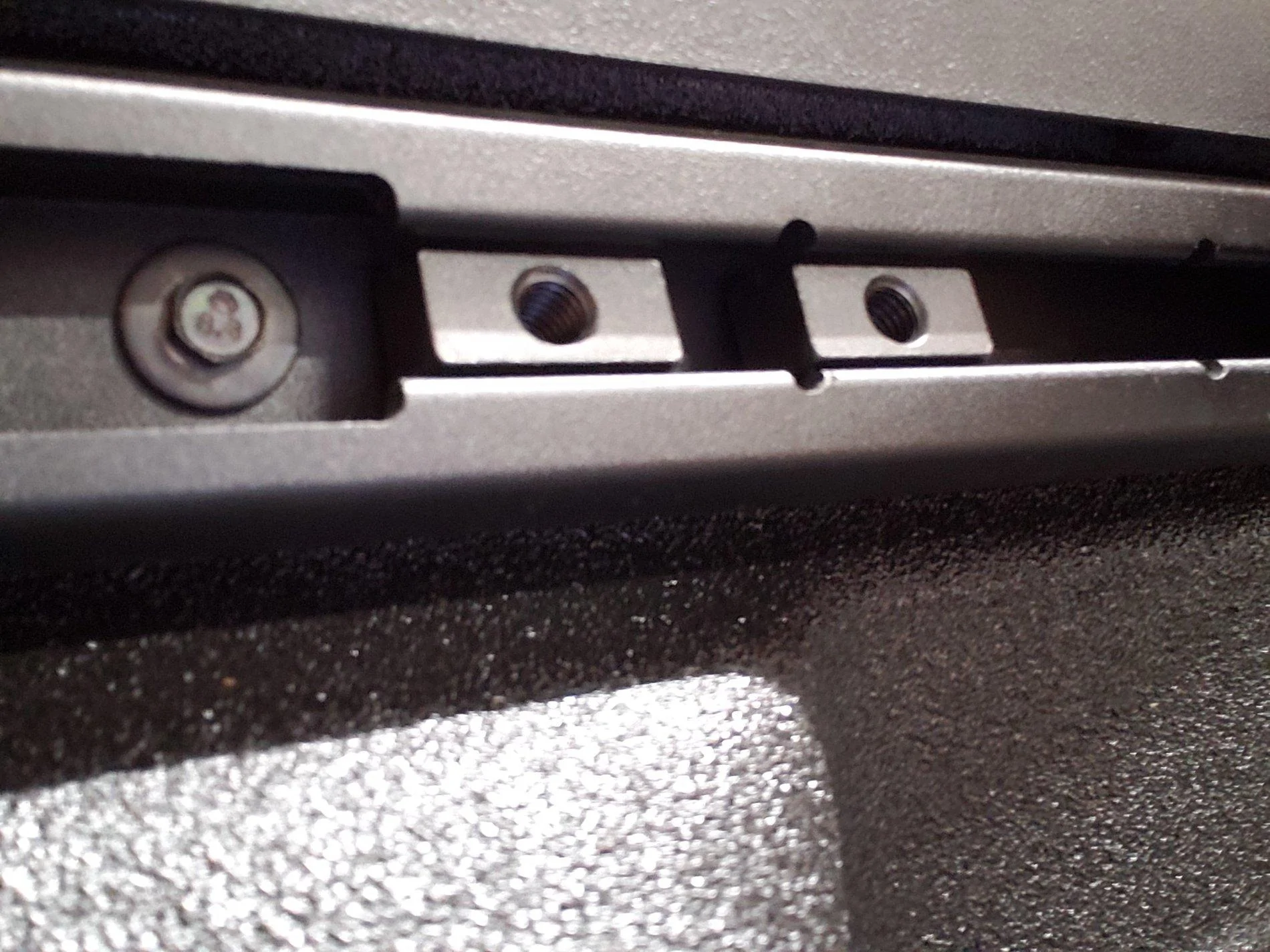

I found out that the Alu-Cab requires the trail rail rack in order to use their clamps and I’m trying to find a replacement without having to buy the rails from Jeep.
If anyone who has the trail rails could measure the depth and width of the rails I would appreciate it. I have found several possible alternatives but want to match the OEM ones if at all possible.
Thanks!

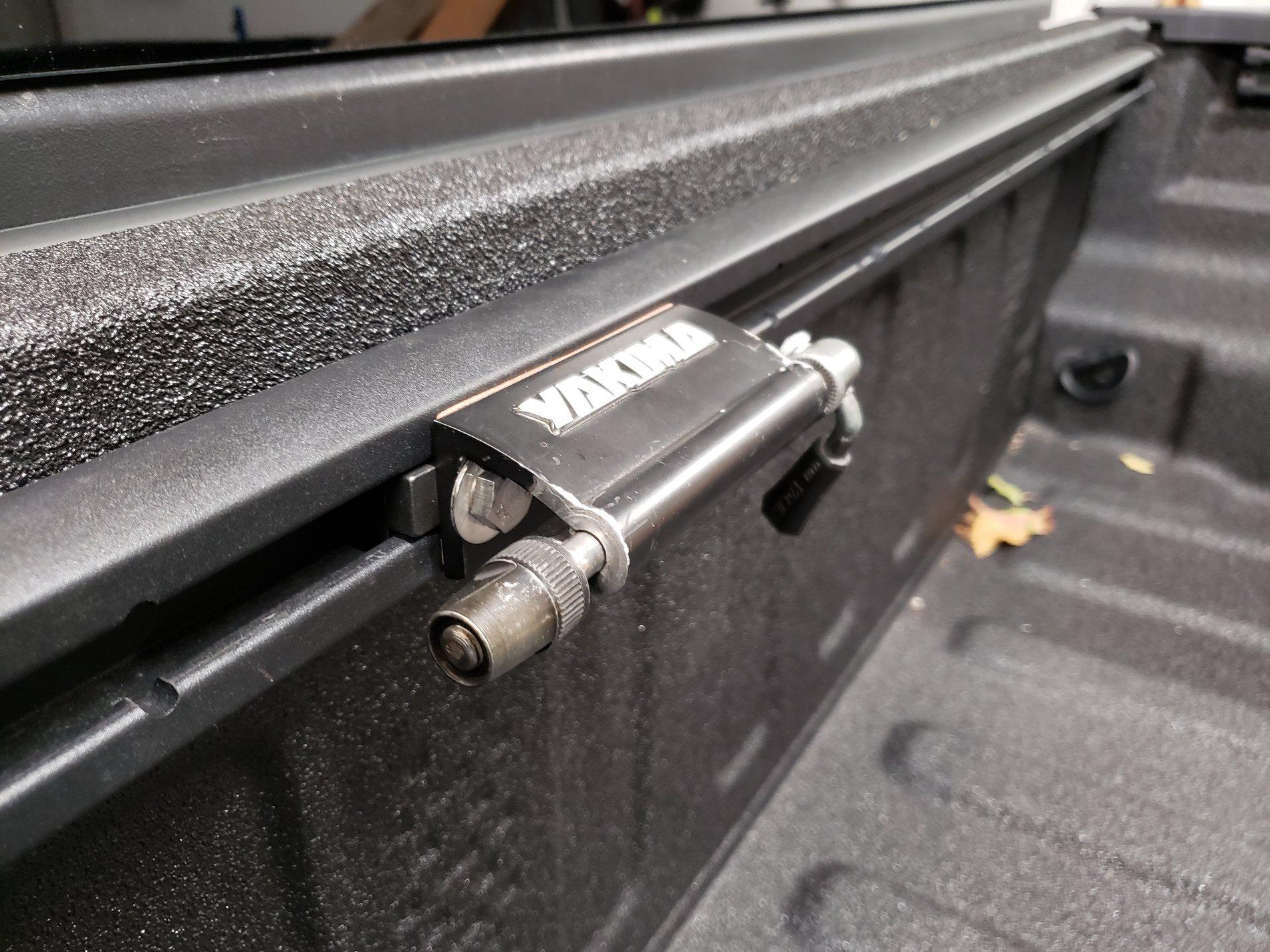

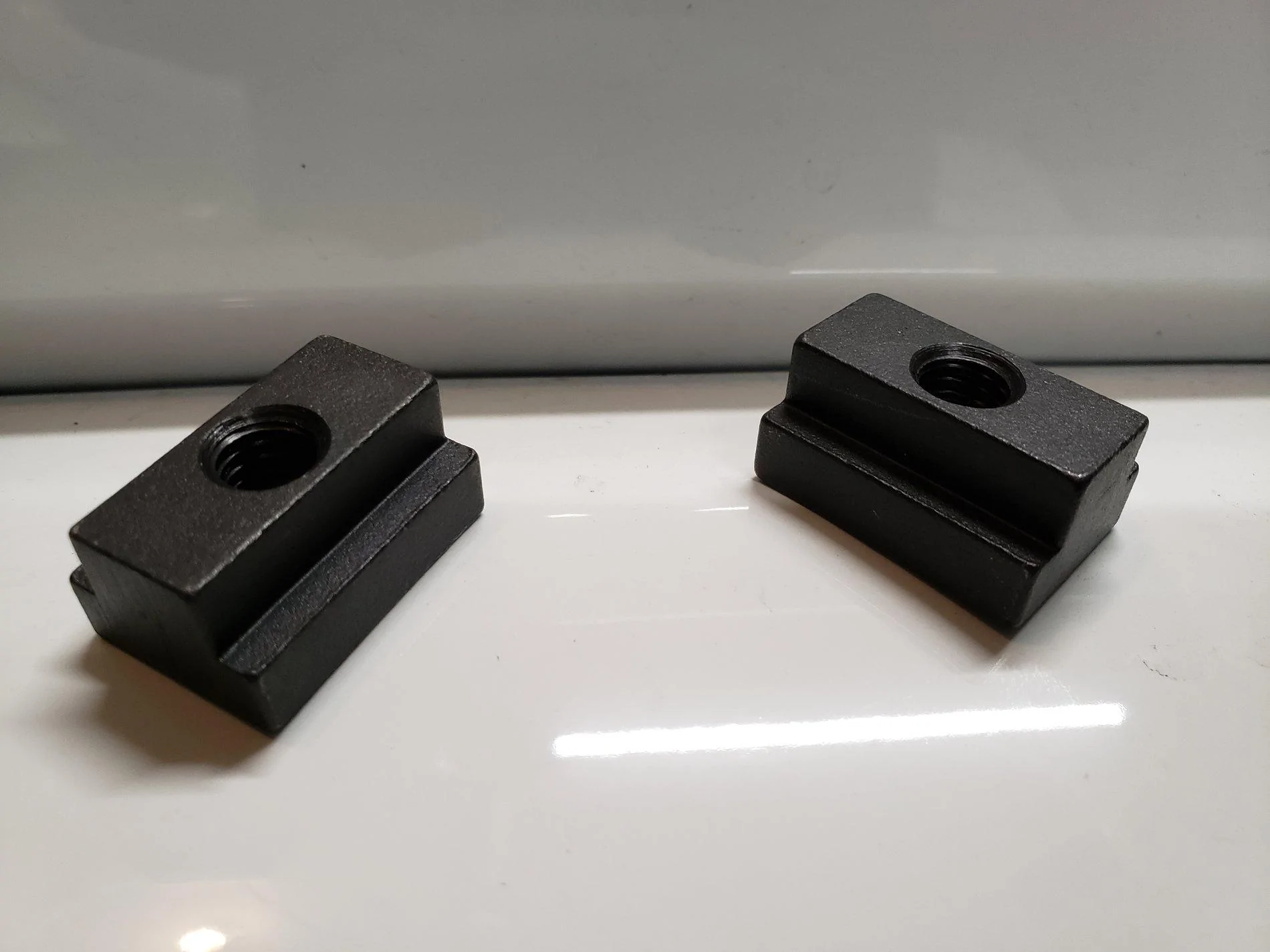

IDK if you're interested, but the Tacoma and Tundra rail systems have the same inner dimensions and many accessories designed for Toyotas will fit the Jeep Trail Rail. This is a fork-mounted bike rack I added to mine using these T-bolts from Amazon.
