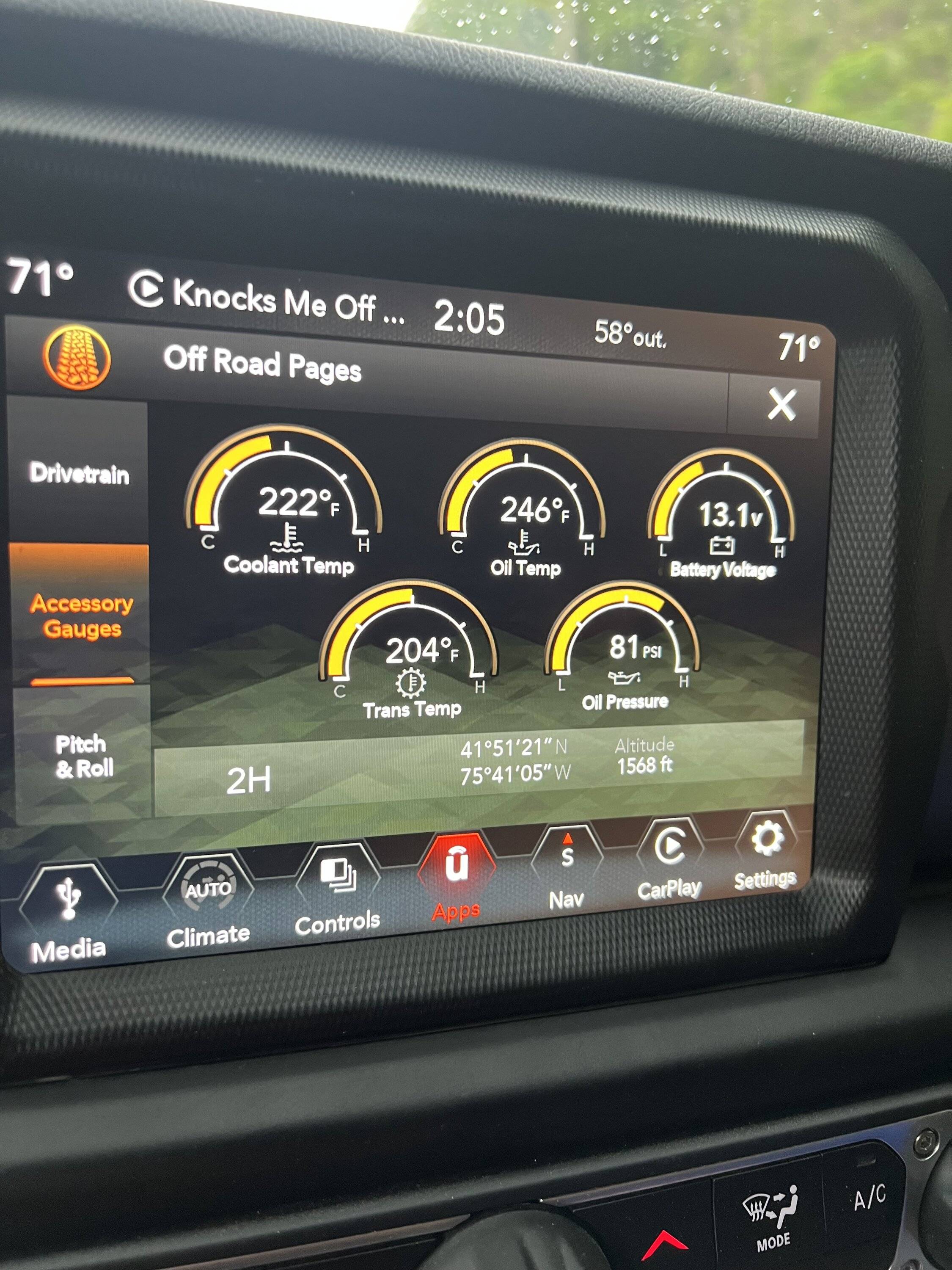

I have been using the 850 watt fan with a 220 amp and have had zero issues while towing a heavy camper.

No one said you'd have obvious issues, however:
Under heavy load, with an alternator working at capacity and the loading being a bit over what's needed, the voltage will be low, potentially not charging batteries as needed
and
Operating an alternator at over 80% load rating for extended periods, especially in a hot engine bay, greatly shortens its life.
Can you do it? Sure! And you won't see a problem pop up in your face.
I'm not saying the above will happen, but it's a risk. Get where that fan is needed for an extended period, in traffic, at night, lights running, charging a camper battery, operating electric trailer brakes and so on..........
Maybe watch your voltage. Keep check that the batteries are fully charged after a long run in hot weather with an electric load to see how things look.
Might be just fine - but there's a reason for the larger alternator, we know Jeep won't throw stuff on when something cheaper will do just fine.
