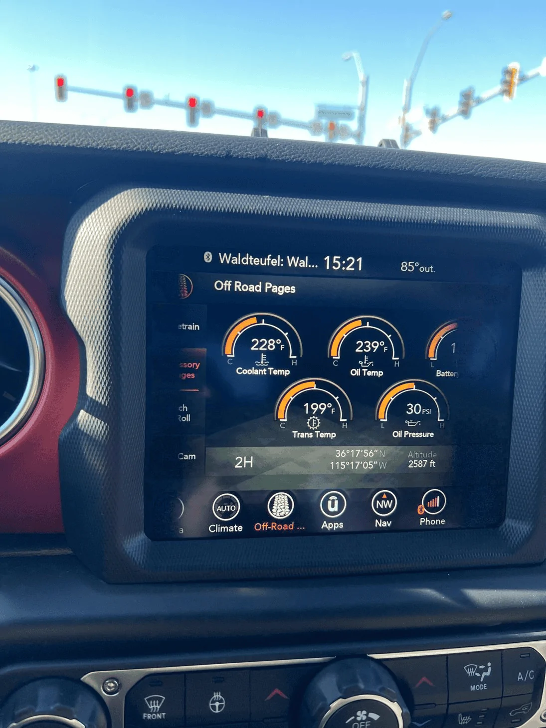

I’m curious because on a normal day just driving around town my temp is anywhere between 195 and 215. And that’s not towing anything. What is the upper end of the spectrum with oil and coolant temp?
Pretty normal and under spec.
Prior to my Gladiator, I had Xtreme Recon Wrangler Rubicon and those run much hotter.
This was in normal driving taking an exit after climbing a short hill in Wrangler XR. No towing, no payload...
Normal and healthy readings. I've never been afraid to see temps like that. My first Jeep ran in the 210s consistently.
A typical thermostat from a few years ago wasn't even fully open until into the 220s.
