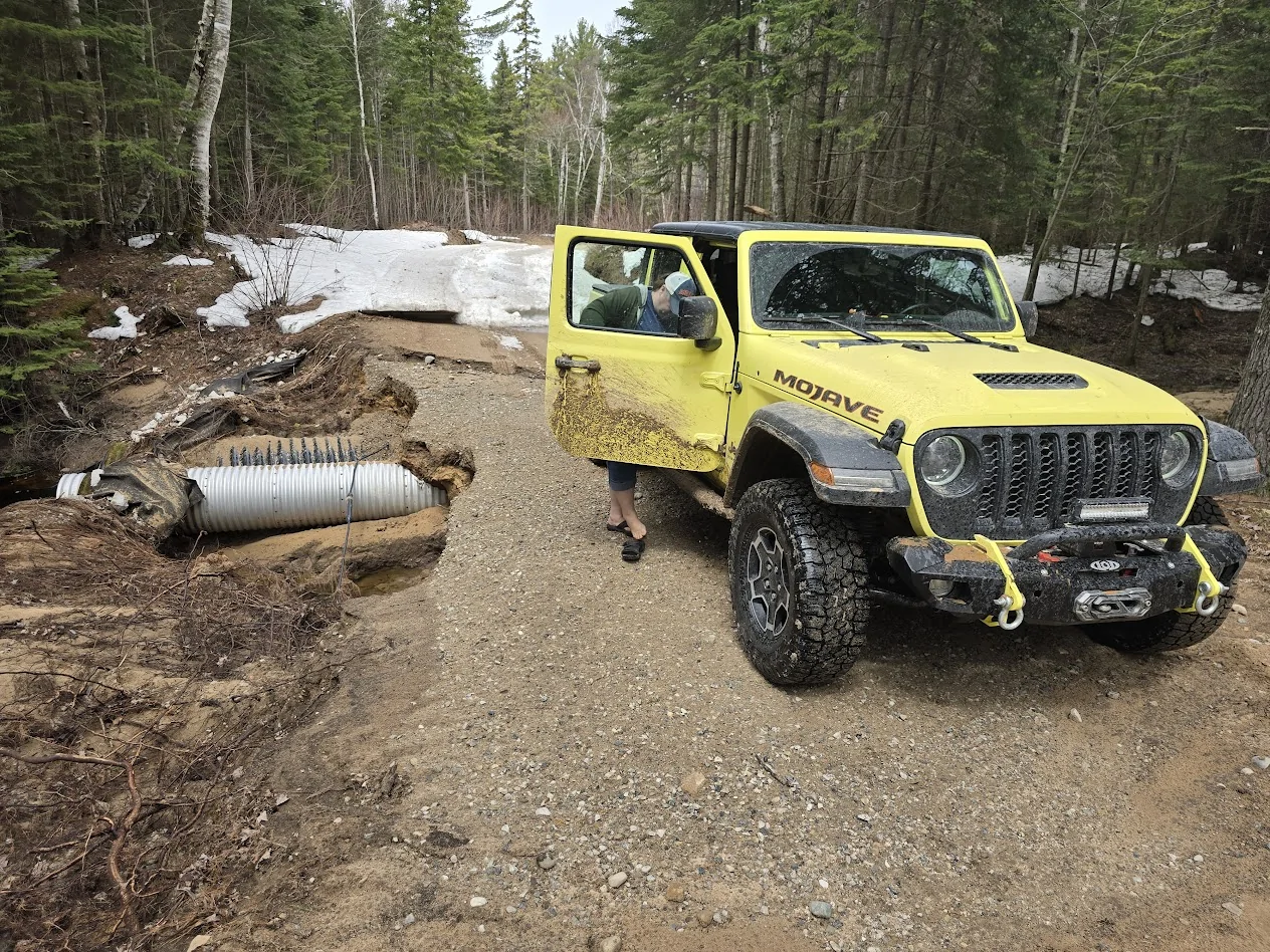

Driving a '23 Mojave and undergoing a very modest build (steel front winch & rear bumpers, etc) for 10-20% touring (mild terrain - dirt road & trails) and 80% daily driver/homestead utility. Will have ALU contour cab, roof rack - kayaks, eBikes & camp gear for touring and bed rack & roof rack as daily driver. Have installed PowerBrake kit, 2.5" springs, 2" lift kit - too much lift! Wife threatening divorce. Considering 2 options: 1) install 1.5" springs, keep 33" tires, install lower hanging side steps 2) keep factory springs and avoid all but mild touring terrain. Option 3) Divorce - not an option.
- How have Mojave owners addressed need to bolster suspension to accommodate added weight for touring & overlanding?
- Not all side steps hang the same - some appear to be near level with cabin floor, others appear to hang lower than cabin floor. Any recommendations for low er hanging side steps?
Works fine for me the way it came lol.
Steel bumper, 9k winch, tent, pad, fridge, camping gear, 2 adults... Works fine.
