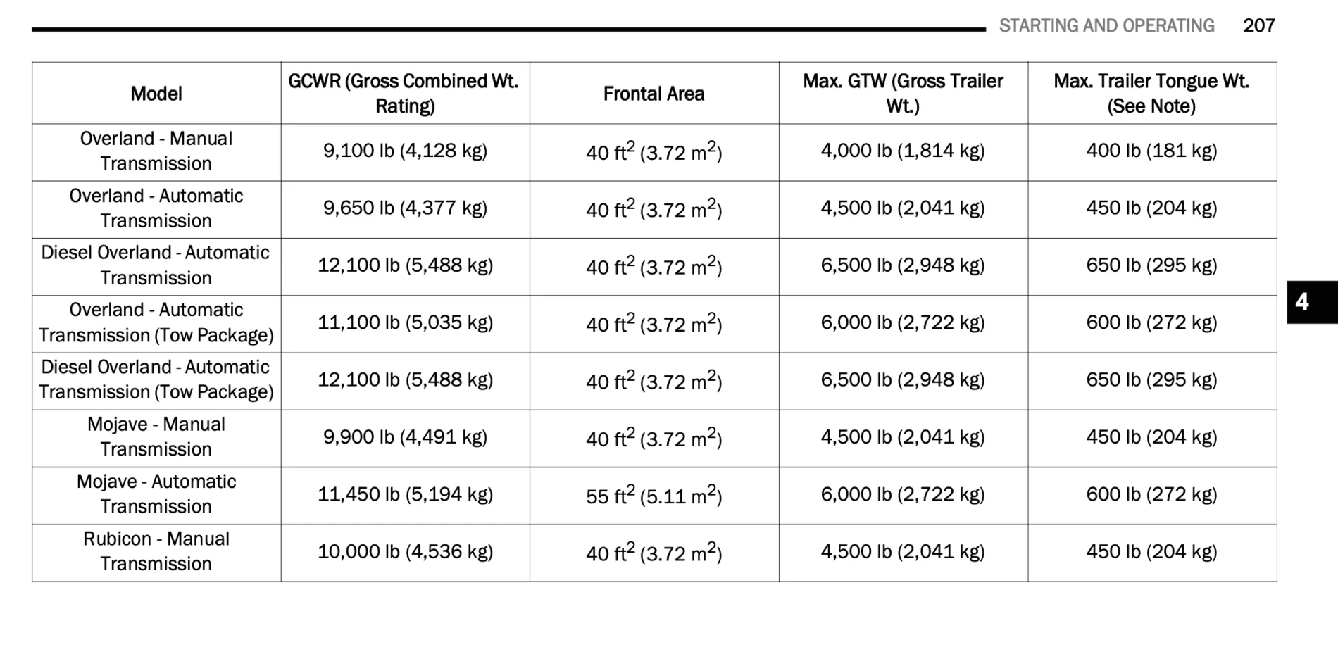

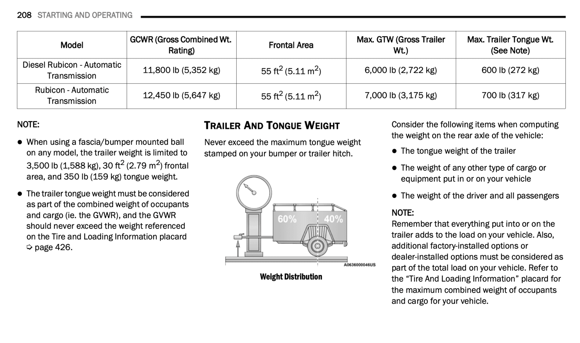

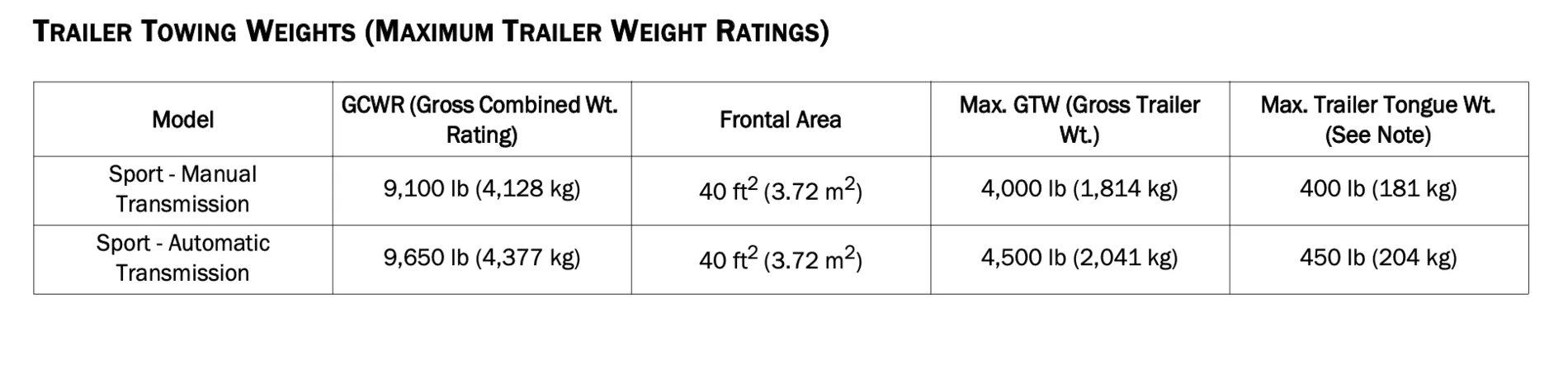

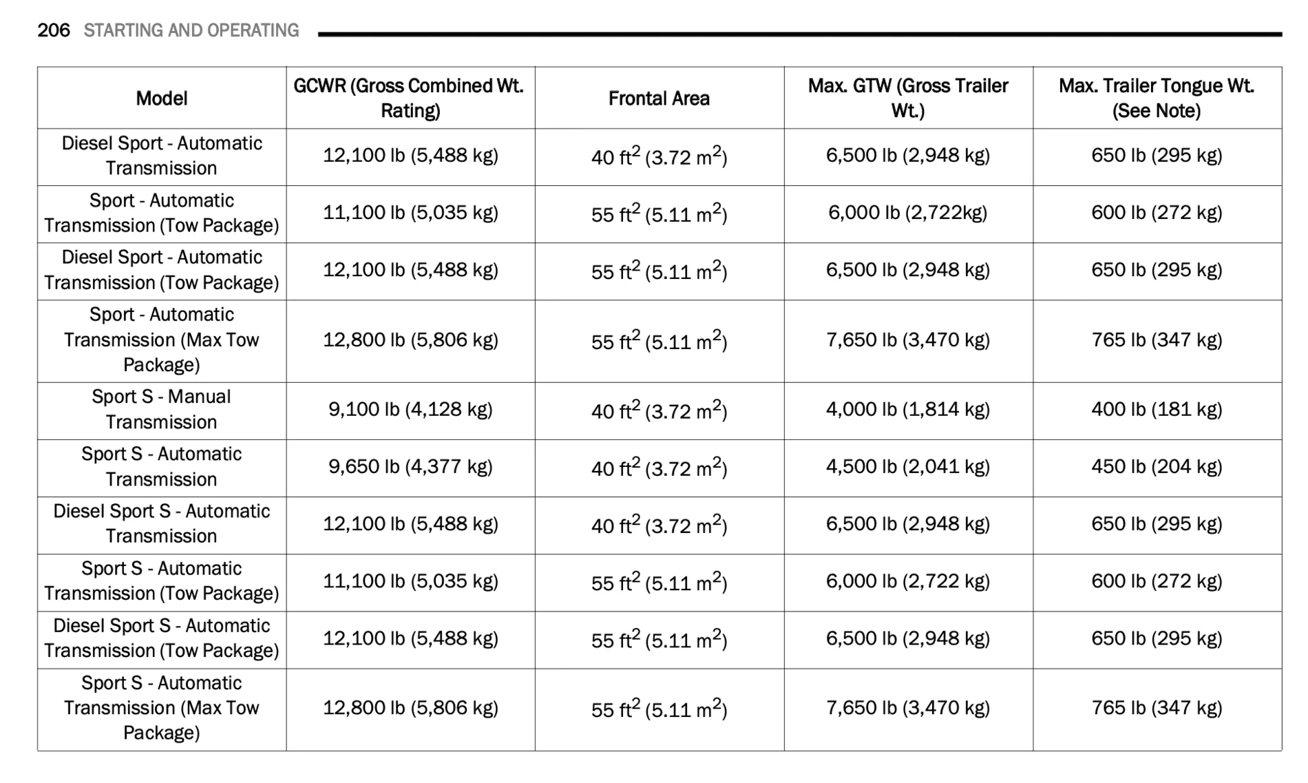

The max towing weights and max tongue weights for each Gladiator model for each transmission type are in the owners manual. In the 2021 manual, the table starts on pg 205 (screenshots below).
(In the 2020 manual the table is on pg. 263, but the 2020 manual doesn't have the Diesel engine listed).
It's a shame they don't also have the max payload for each model in the same table - that would be useful.
