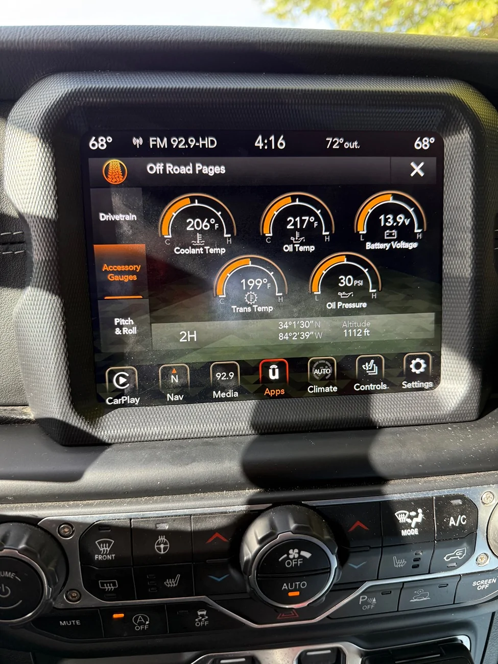

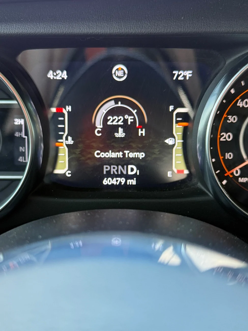

I just read through all of this. I noticed when stuck in bad traffic the other day that it was hitting 220 degrees and the fan wasn’t coming on. It never went past 221-222. Is it really true that the fan doesn’t come on till 225? It runs 190-195 going down the hwy. I guess that’s normal?
Those transmission and oil temps ok?
2020 Overland with factory tow so it has the HD cooling.
The @#$% thermostat doesn't even fully open until around 220.
It begins to open at over 200 degrees. (most say the rating for the factory stat is 203 - so far I've not seen anyone counter that)

IMO, your oil and transmission temps are plenty low.
We're talking modern fluids and a good oil handles a lot more heat than things from the 1980s.
The temps are fine.
This whole "200-220 is too hot" sentiment needs to die. It isn't too hot. Modern vehicles seldom run at 180 now.
Amen.
people are stuck in the past, or, not having seen actual temperature numbers before do some internet digging and find stuff that is just wrong or OLD.
You should see what AMSOIL says their oil will handle without flinching.
Others aren't far behind.
