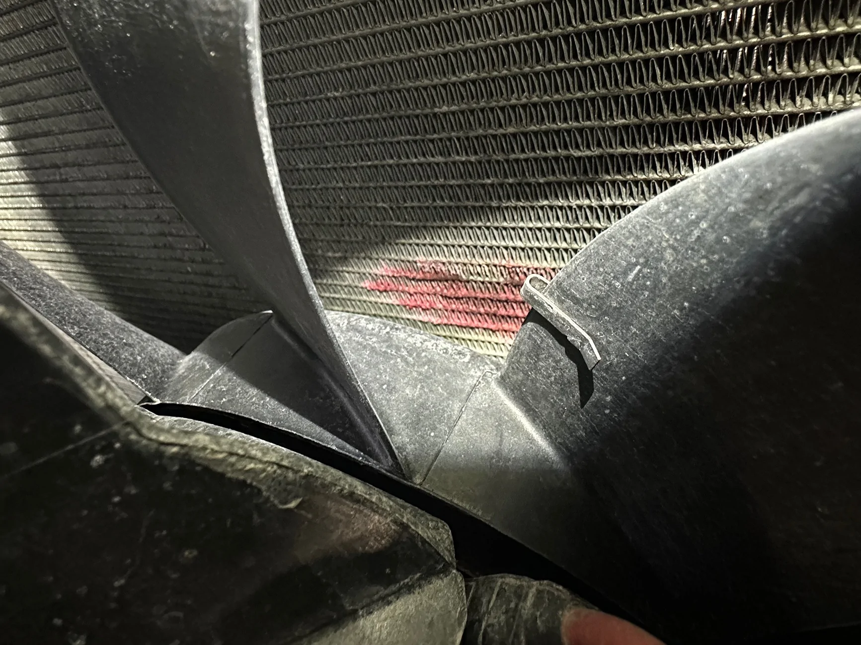

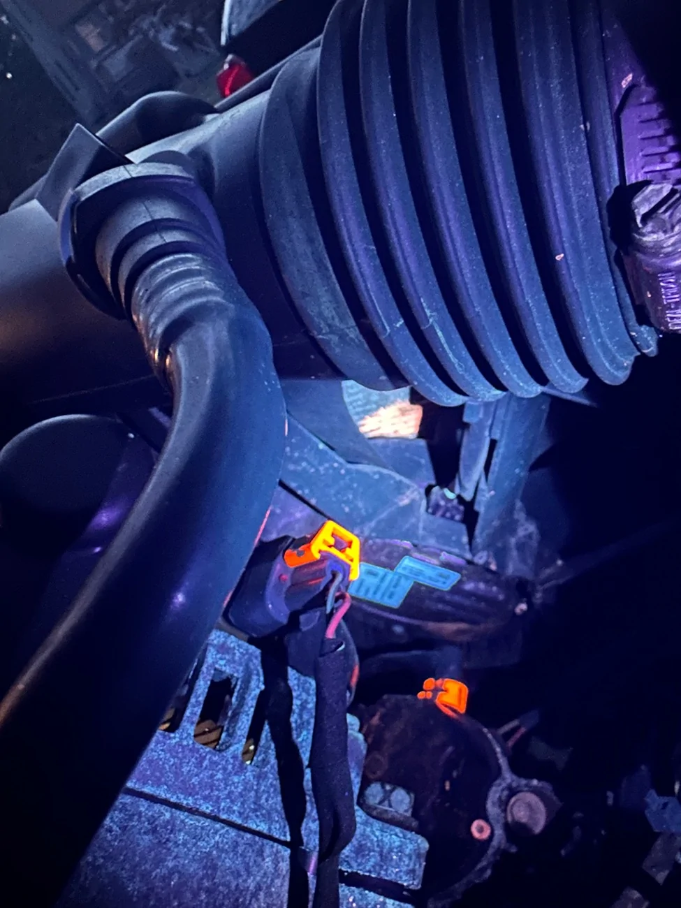

Truck had passenger side cam and head replaced. Coolant was replaced during that repair. Immediately after there was a slow leak. Thinking rough handling or something else during the repair may have contributed to the issue. Then again the truck is 6 years old.
I found a leaking hose and a spot in the radiator. Brought it in they replaced the hose. I told them about the coolant scab on the radiator but it passed the pressure test so they figured it sprayed on another way. I disagreed but I’m not a technician so I waited to see.
2k miles later the coolant is low again. I have since washed the spot on the radiator away and watched it slowly reappear.

That does look like they damaged it. If you had it documented and returned once for a leak, dud you try and take it back and tell them it is still leaking in the same spot.
If you do it yourself, just get the oem.
