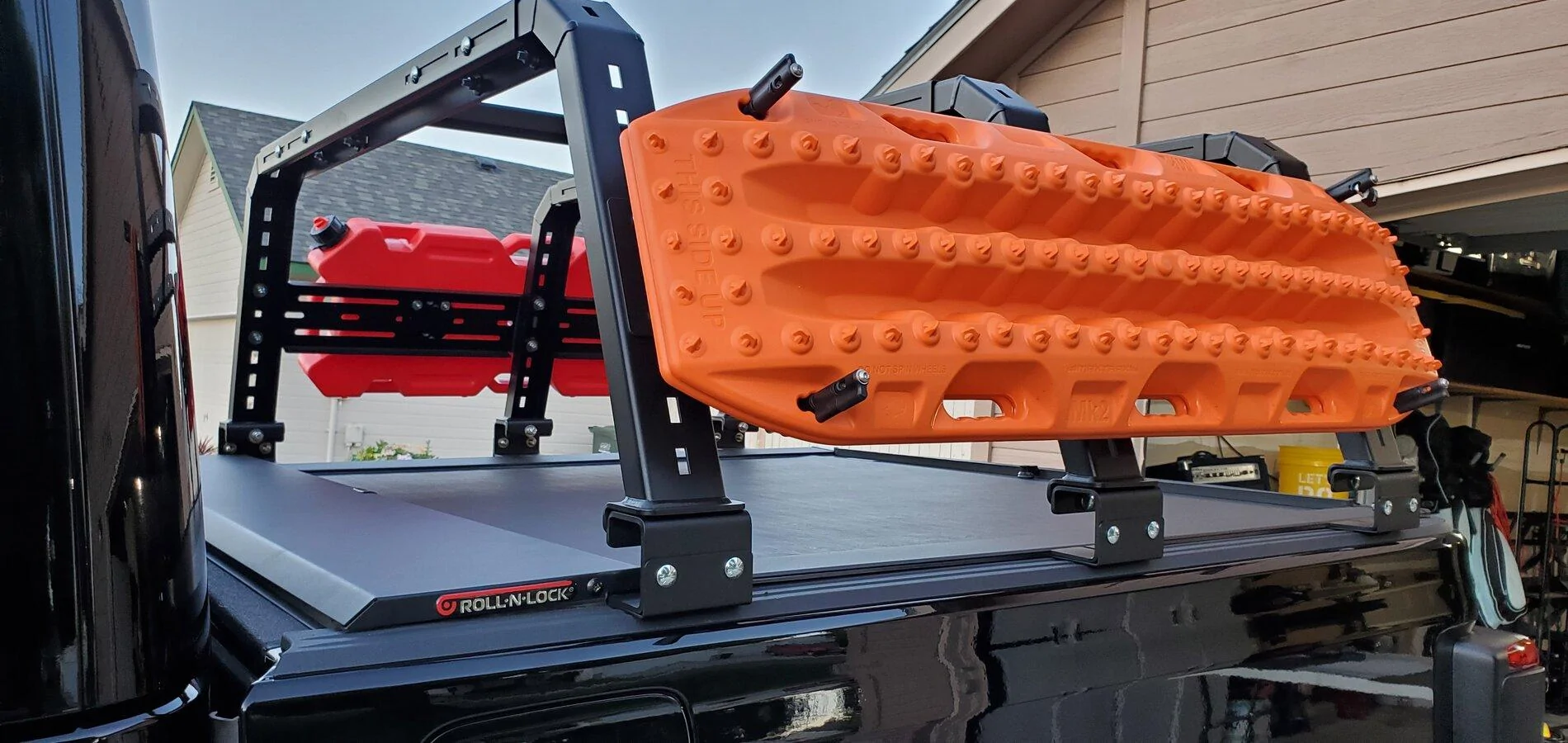

I’ve been overthinking the combo of the RCI or a similar tonneau compatible bed rack with a truck cover USA tonneau. You mentioned minor modifications. What was required?
2 things: I filed the back edges of the roller cover because the front most brackets kept it from seating fully, and I cut out the inside edges of the plastic bed siderail covers just enough to allow room for the heads of the carriage bolts used to secure the tonneau adapter brackets to the Trail Rail.
