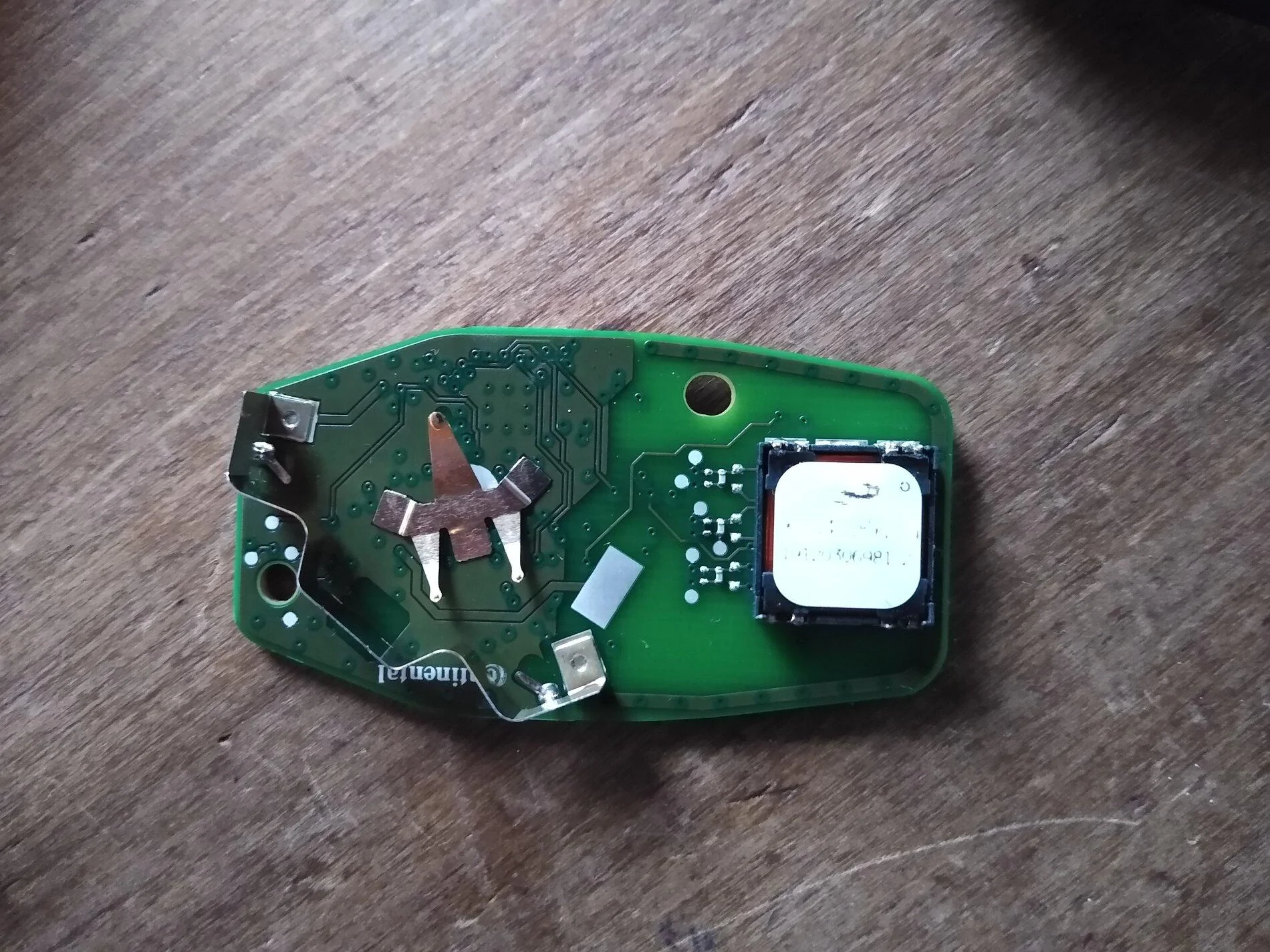

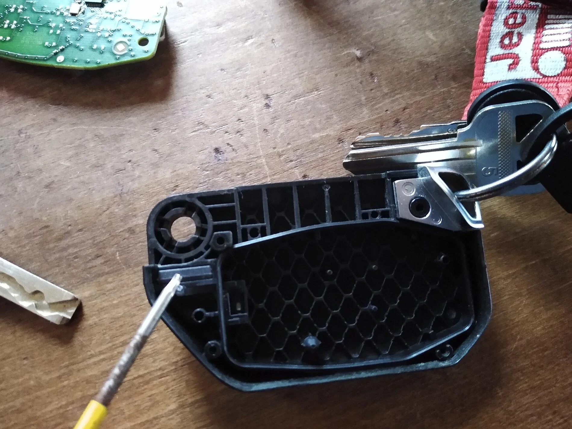

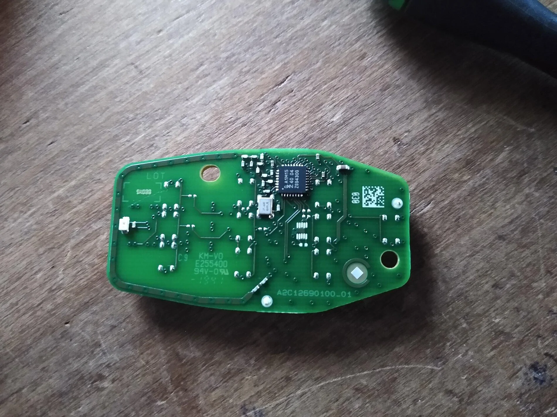

I thought I remembered someone on here asking for pictures of the circuit board from a non-keyless Sport key fob.
Also, I experimented and took the keyfob out to the JT without the circuit board in it, and it starts, but only when I held the transponder chip end (pointed out in the 3rd picture) right up to the pushbutton. So I'm assuming that the battery and circuit board act as a range extender, allowing you to keep the fob in your pocket and start the JT. I was really hoping to eliminate the whole fob thing, but the only way I can see to do that is to have the transponder chip surgically implanted into my index finger...
<snip>
Get a key blank cut and glue the transponder chip to it.

Just curious, did you try starting only with the control board with a battery installed without the transponder chip in proximity of the Jeep?

No, I only tried it with the transponder chip near the start button, while the circuit board was still in the house. I'm 99.9% sure it wouldn't do anything without the transponder chip present. The circuit board is merely a range extender for the chip. I can try it once I get home. For science, of course.

The transponder chip is not necessary to start the jeep. Its essentially a passive RFID chip in the event the fob battery fails. Since the RFID is passive it requires very close proximity to the sensor.
The jeep will start with just one or the other.
No, not at all, they are two totally different circuits and each can work without the other. I have a pile of NFC/RFID chips on my desk right now for a project, and have an NFC 14443 chip embedded in my hand. I've got a little experience with it. The close-range chip is an old-style passive RFID, which needs no power. Or more precisely, gets power inductively from the Jeep, which means being very close to the reader. The other circuit is an active system that requires power. It's able to provide far more range along with very good location/proximity detection. For example it knows if you're standing by the door or not, and decide whether to let you unlock it. You can start the Jeep with the key JUST inside the door, but not just outside the door. My wife's car will not let someone open the trunk if the person with the key is standing by the door instead of behind the vehicle.
I stand corrected. My apologies.
