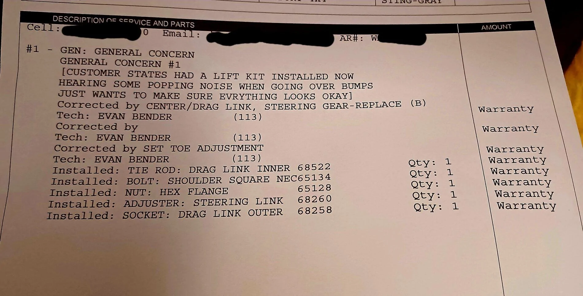

Took it to the dealer. They checked everything and told me that I need a new tie rod and drag link (I think he said drag link...I'm tired) Really??? At under 7k miles I'm surprised. It will be covered under warranty. Funny thing is on the way home I didn't hear anything. They must have tightened some things up.
Edit-I didn't get any sleep so now I'm second guessing what he said. Anyways, they're replacing 2 things ?.

Covered by dealer not bad, better now? Getting any more sleep?....jack
Seems all good up front. Even drives better. But I'm still getting an occasional popping sound from the rear end when slow moving over uneven/bumpy terrain. Gee wiz...my old Colorado did the same thing. It had leaf springs though.
