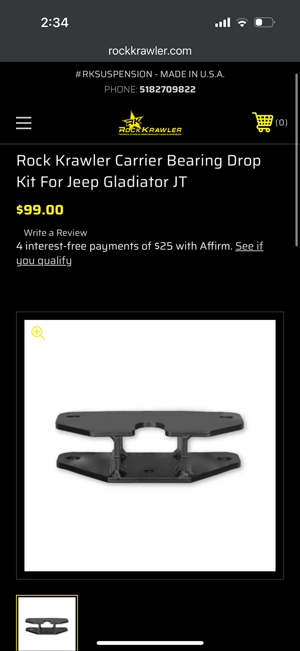

I have the RK 4.5 rear springs. Went with the RK drop bearing. I ran without for awhile without any issues. Recently installed it and it becomes very noticeable how much it straights out the two driveshaft.
