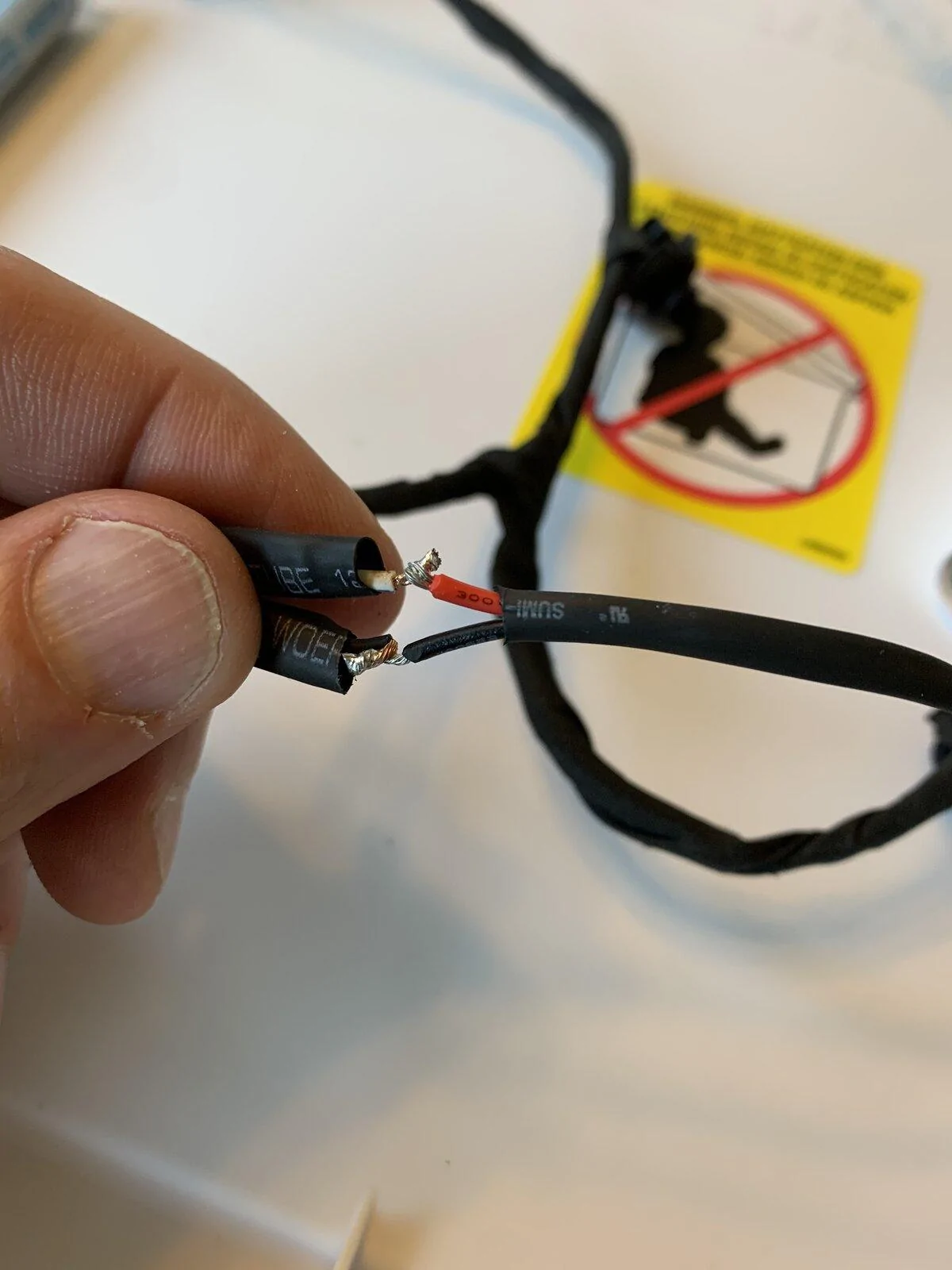

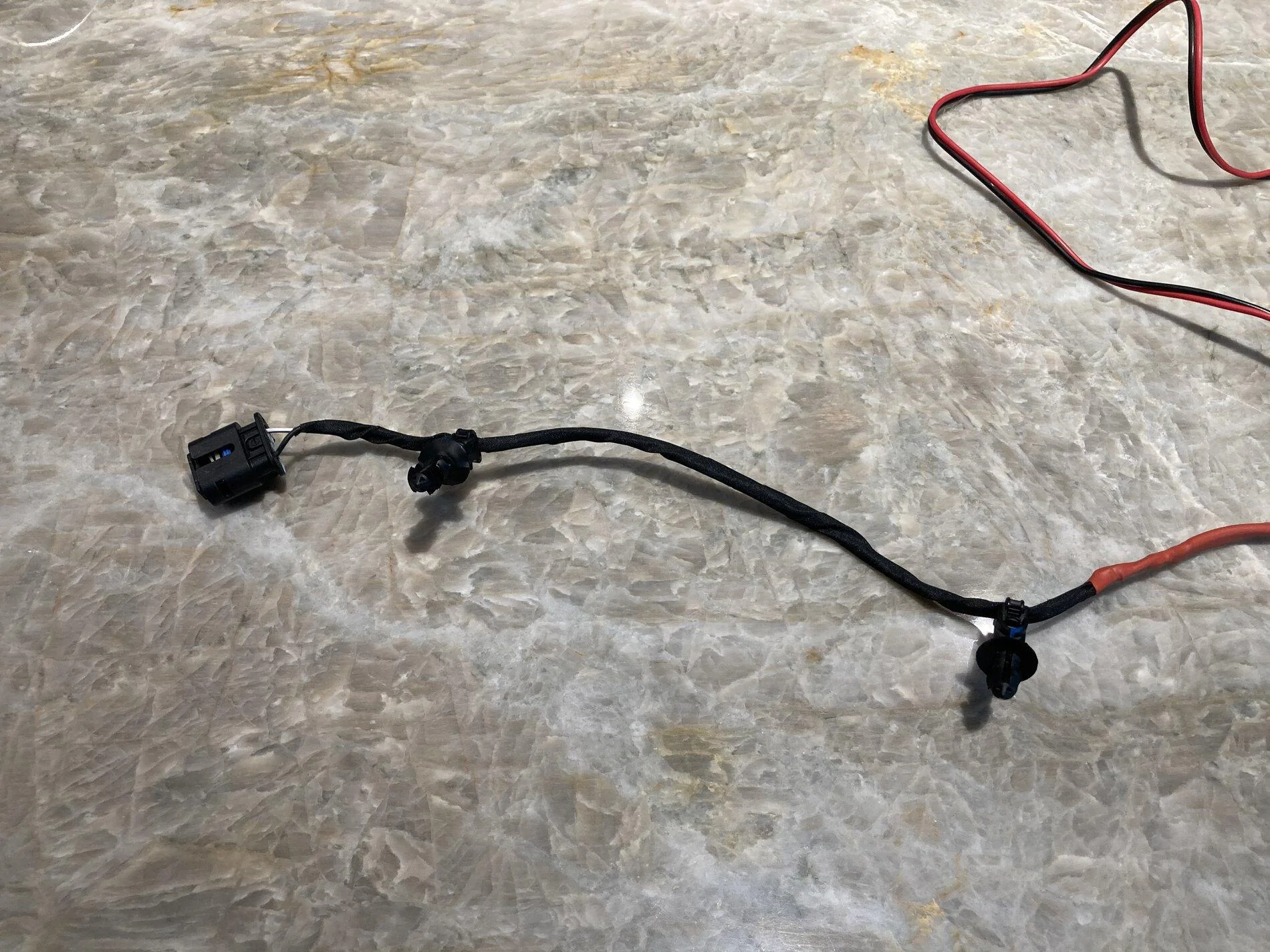

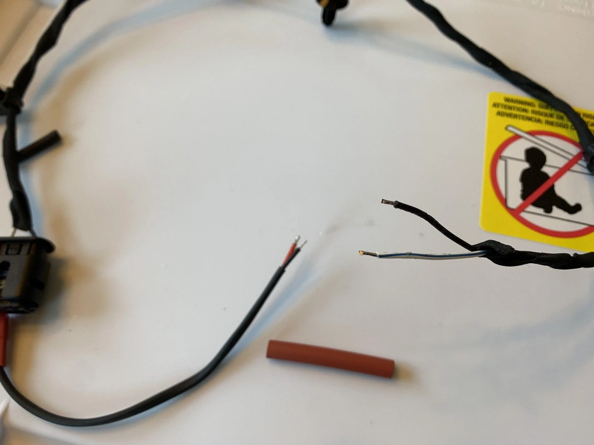

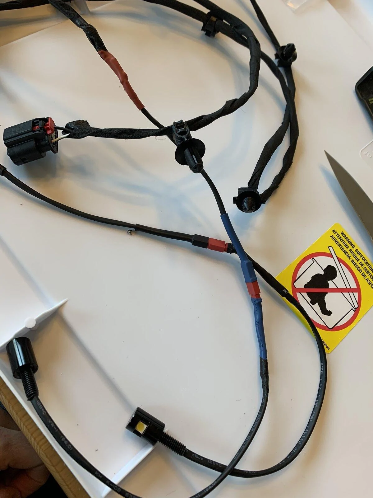

So after some digging around I found the cheapest option was to purchase a new rear wiring harness and wire my new LED license plate lights into it for the new bumper. I strip the plugs, solder the new lights onto the new harness and properly shrink wrap the wiring.
Total cost for the new harness is $25 (part number 68349976AC); be aware that my truck does not have back up sensors nor any active lane avoidance sensors.

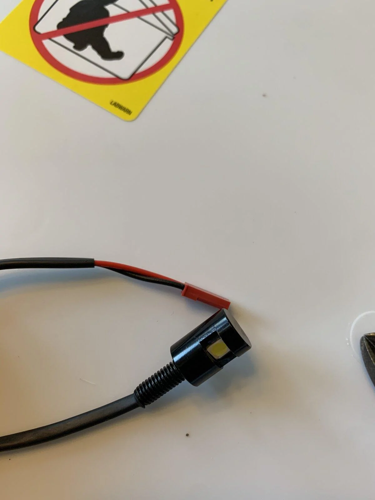

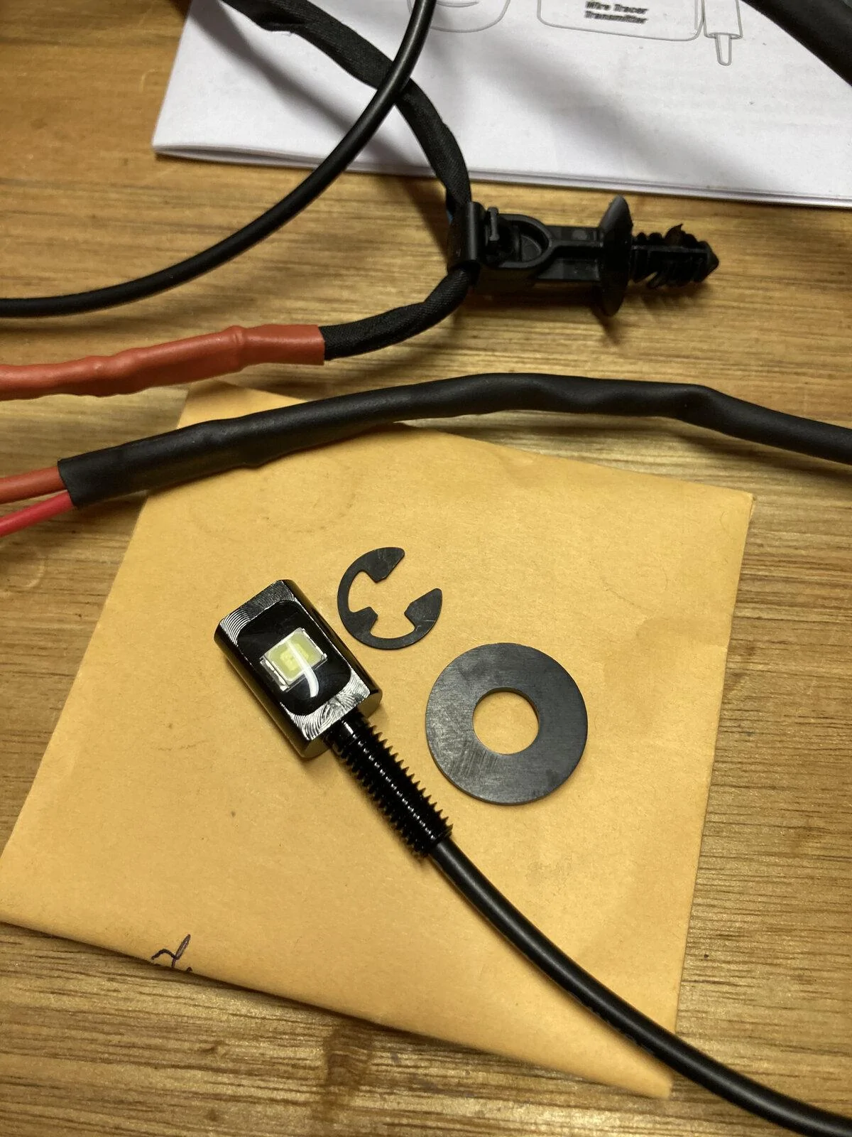

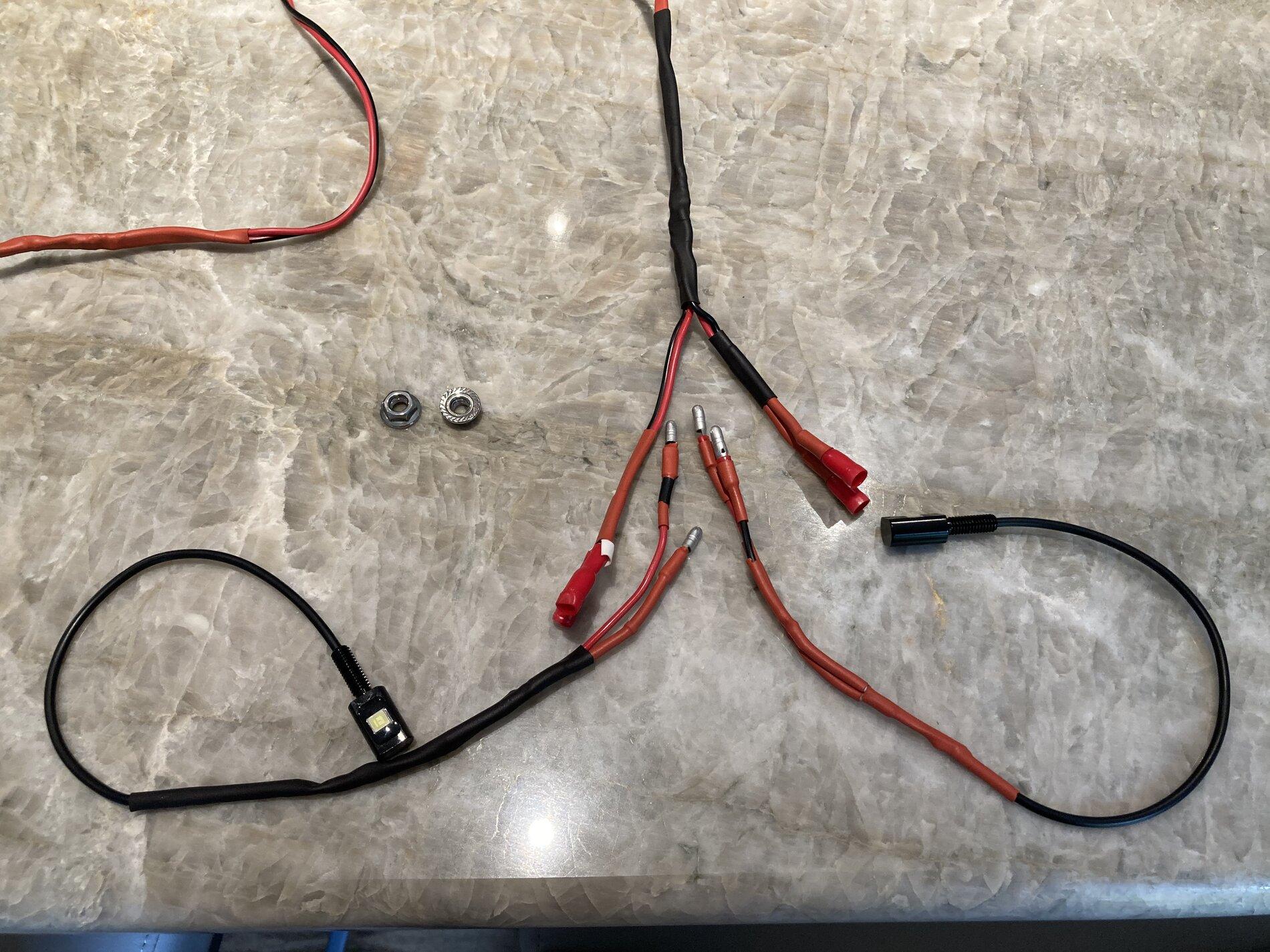

I ended up going with a new wiring harness and wiring new LED lights on it. Final results are excellent! I’ve also used some dielectric grease to keep water out of the connections.

A new wire harness was only ~$25ish. I was able to remove the old bumper and kept the wiring harness intact so that I can reinstall the bumper and lights without a lot of hassle.

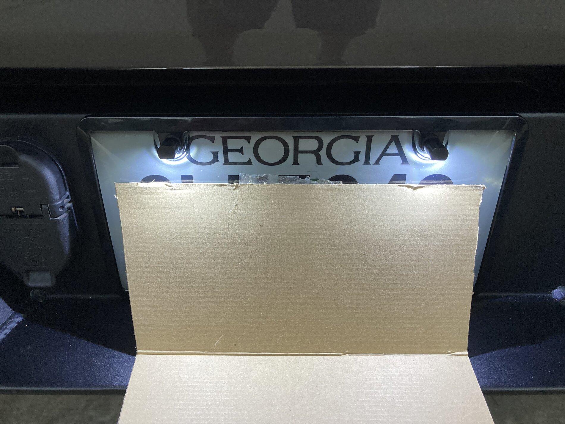

E-bay. Motorcycle tag light.
on the RR HD Rear.
