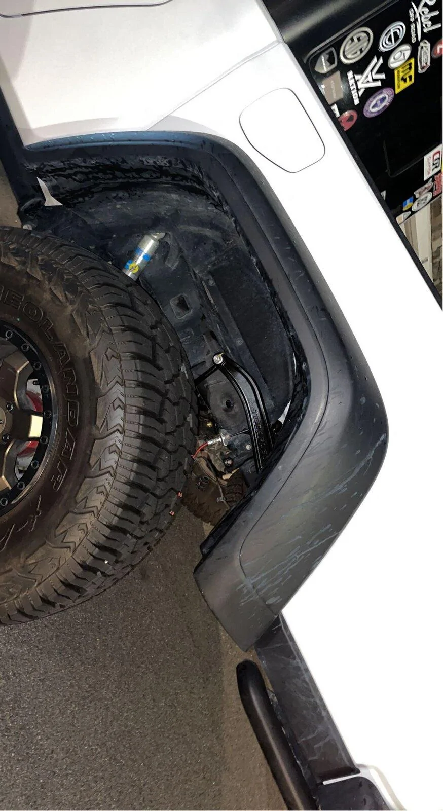

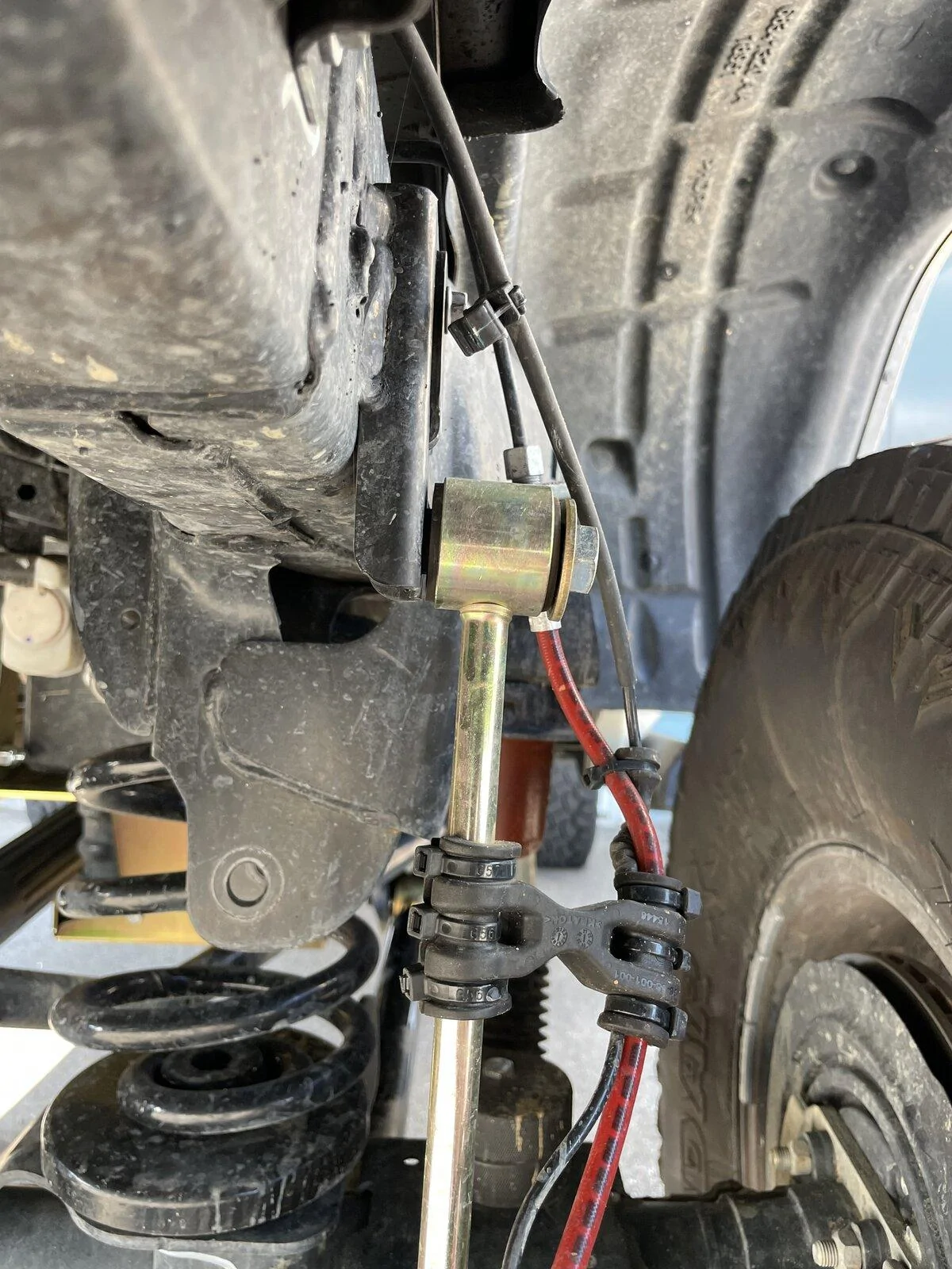

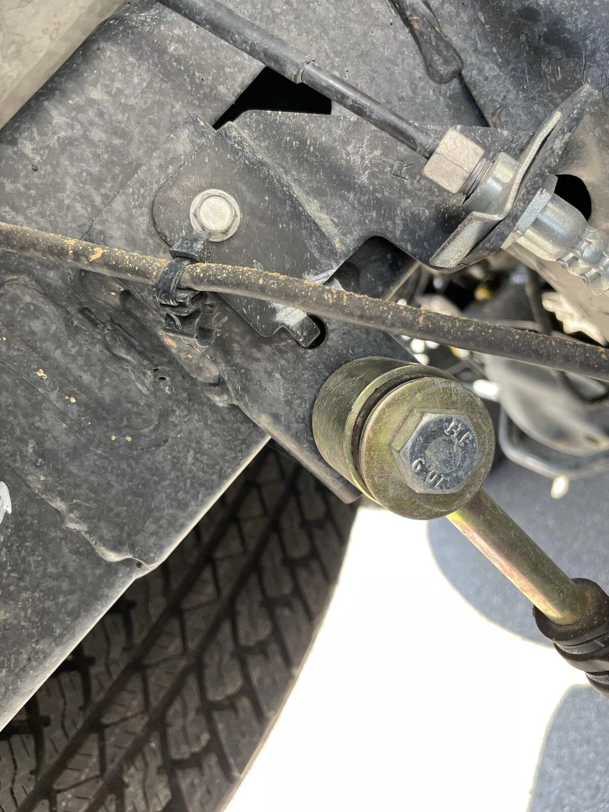

The dreaded rear frame-side end link is starting to go bad. You can see the bolt starting to sag in the photos. My question, has anyone found a solution for this? I am thinking of getting some steel bar and making a doubler plate for it. I cannot justify spending upwards of a grand for a swaybar relocation from antirock or teraflex.

Search the forums, it's a common problem. I have my endlinks at the right length for my shocks but it still happens due to the inferior thickness of the metal at that location. I wouldn't say metalcloak, bilstein, and clayton offroad are inferior... lol

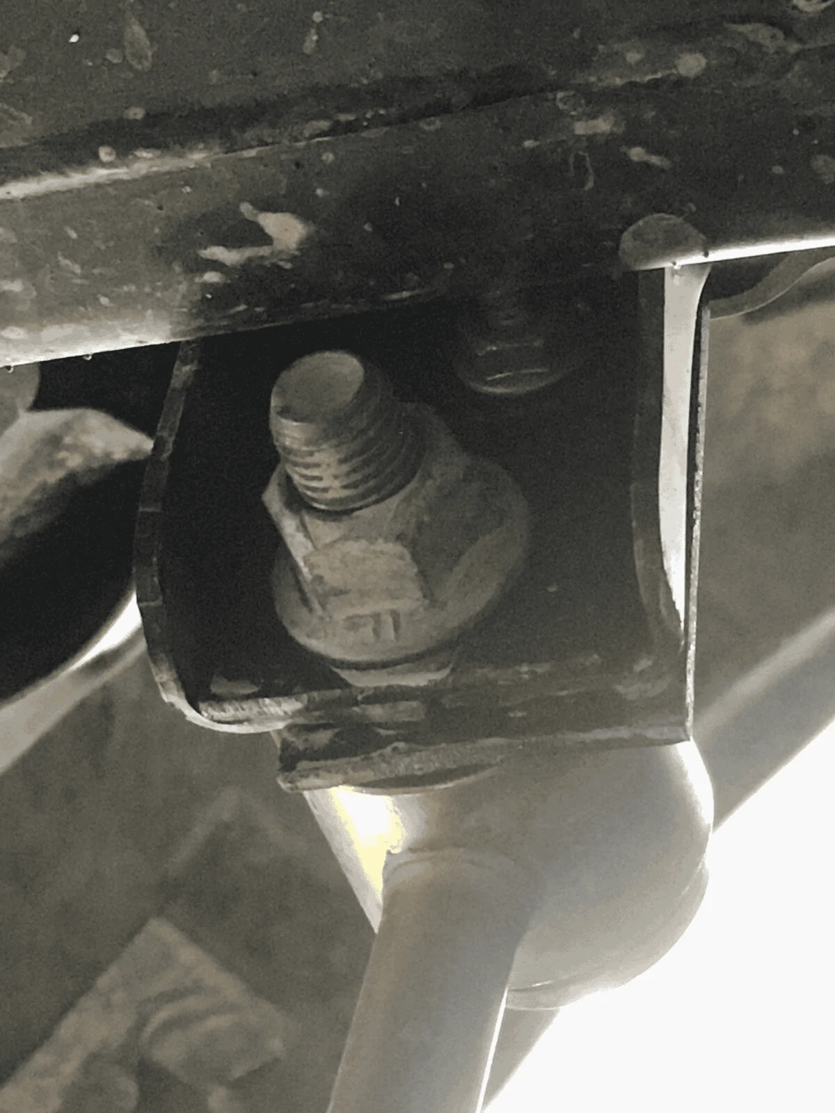

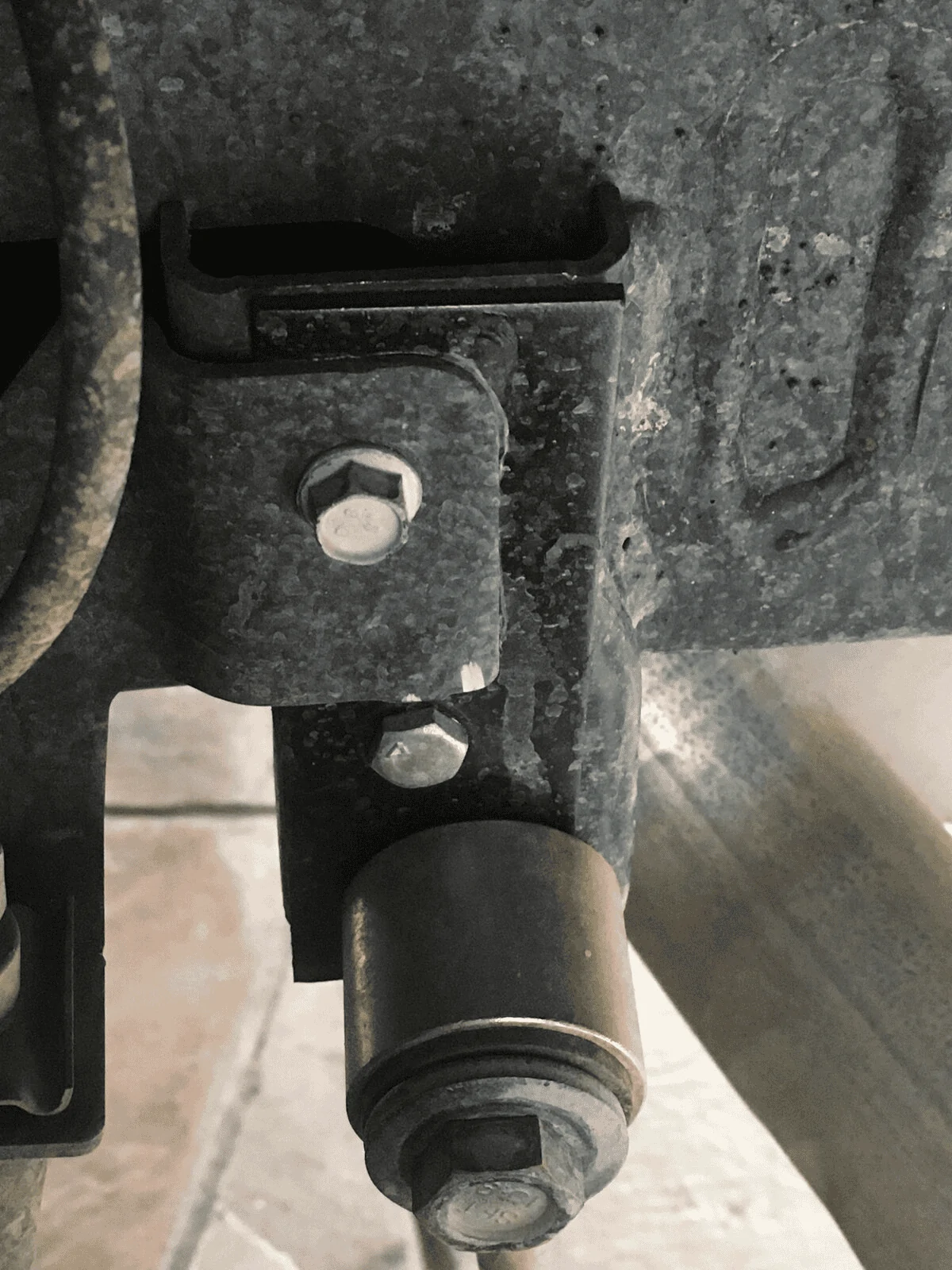

I bought some steel bar from Lowe's and made a sandwich. It's a bit crude, but it's been working.

That’s one way to do it…
I was gonna do the method you suggested, and actually had the steel plate in my garage! And then I realized my end links were not long enough for the falcons I ordered anyways. So… here we are lol.
