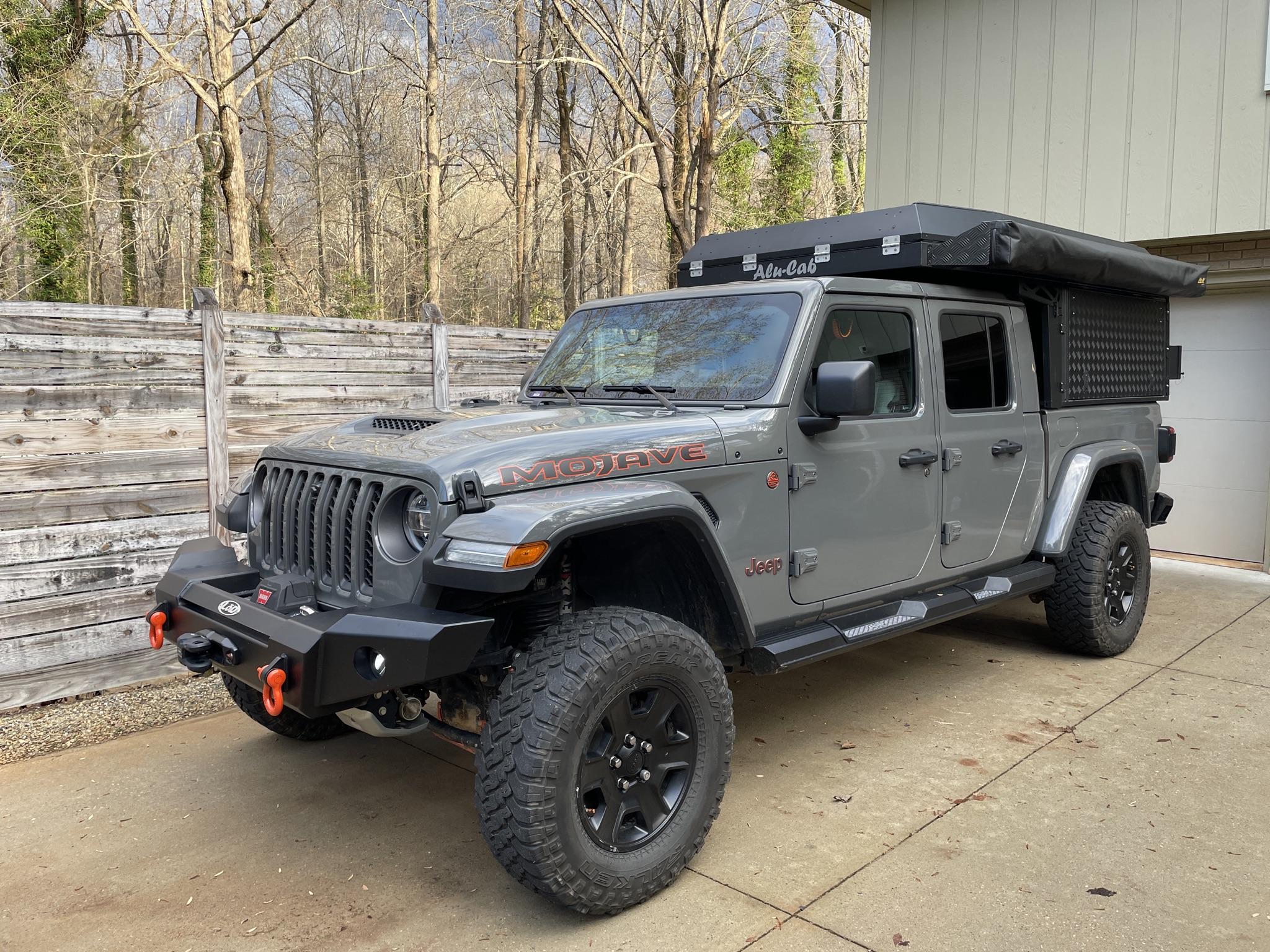

I do not know the answer to your question, but if you figure it out, please let me know. My Hellwig did not help much.
