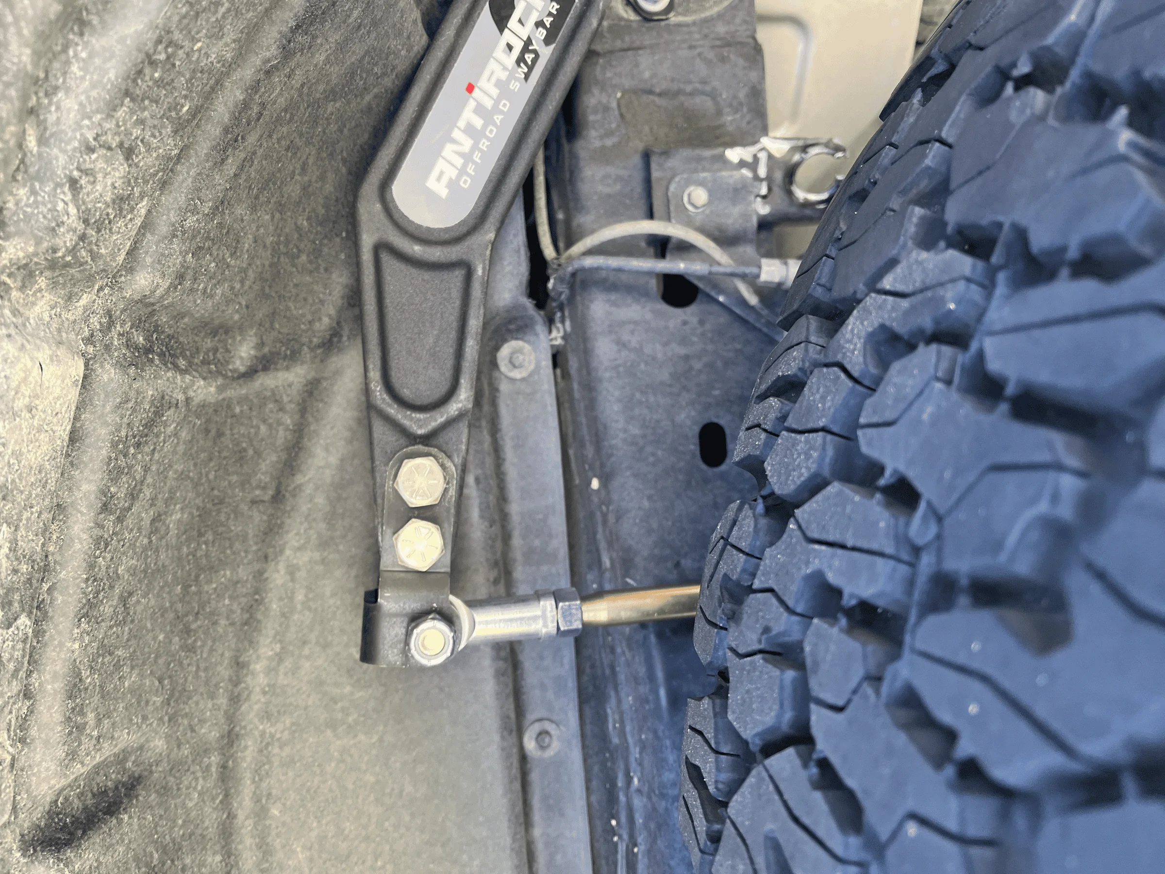

yep..I just had a link tear out of my frame so I pulled the trigger for the anti rock. Simple install only caveat is that I have a 2.5 inch lift and they send the kit with links for a 4+ inch lift so if you are going to order and you have a short lift then let them know when you place your order..they are sending me out the correct ones. solid quality product

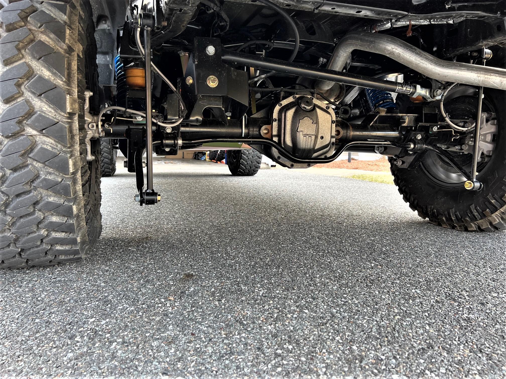

The rear sway bar looks like the next most vulnerable area for damage. Has anyone made changes or upgrades? I found this: https://www.rockjock4x4.com/RJ-256200-101 , but I do not know if it would work to get it up higher and away from damage. Here is a picture of how mine is now.
Those endlinks are WAY to long. Your swaybar should be parallel with the ground.
