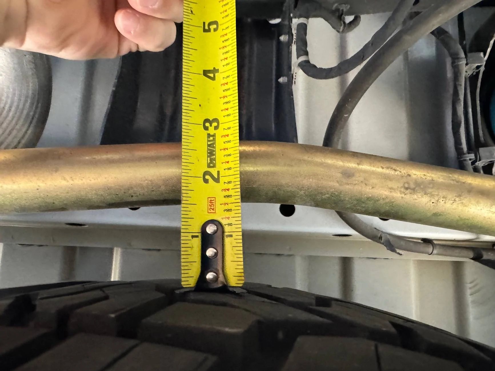

I run a lot of Metalcloak products on my Jeeps. Never been disappointed yet. I am running a Toyo Open Country RT 37X12.5-17. They run pretty true to size for a 37. Fully inflated I have a full 1 1/2” of clearance.
Jeep Gladiator Rear track bar for 37" tires IMG_8278

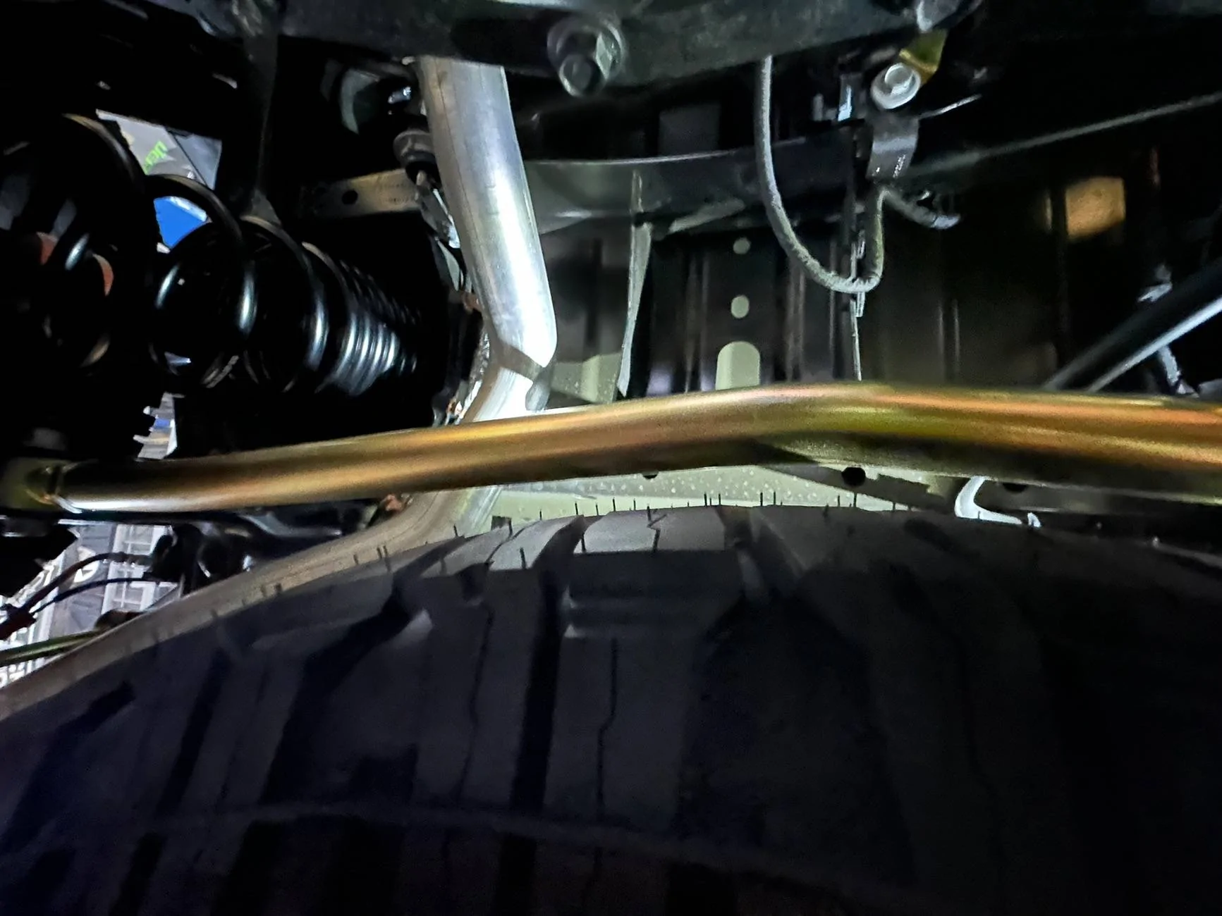

Yes and no.
My 38” Milestar Patagonias fits under the heat shield and it isn’t hitting the tow hitch area, but on the sides….
it is over the frame of the Jeep. Simply too wide. But it still kinda sortaworks with one side over the frame. Doesn’t look great but it does fit in the spare
As and when I go off roading, I’ll probably put it in the truck bed and strap it down.
Please note that the spare is currently at 40psi As and when I do the 5 tire rotation, the tire that will be in the spare will be ~30psi or less.
I have my portable inflator in the Jeep bed all the time + my tires are set to 30psi anyhow al going to 25 psi will be fine
Hopefully it fits within the steel frames when it is 25psi
Jeep Gladiator Rear track bar for 37" tires IMG_1373
