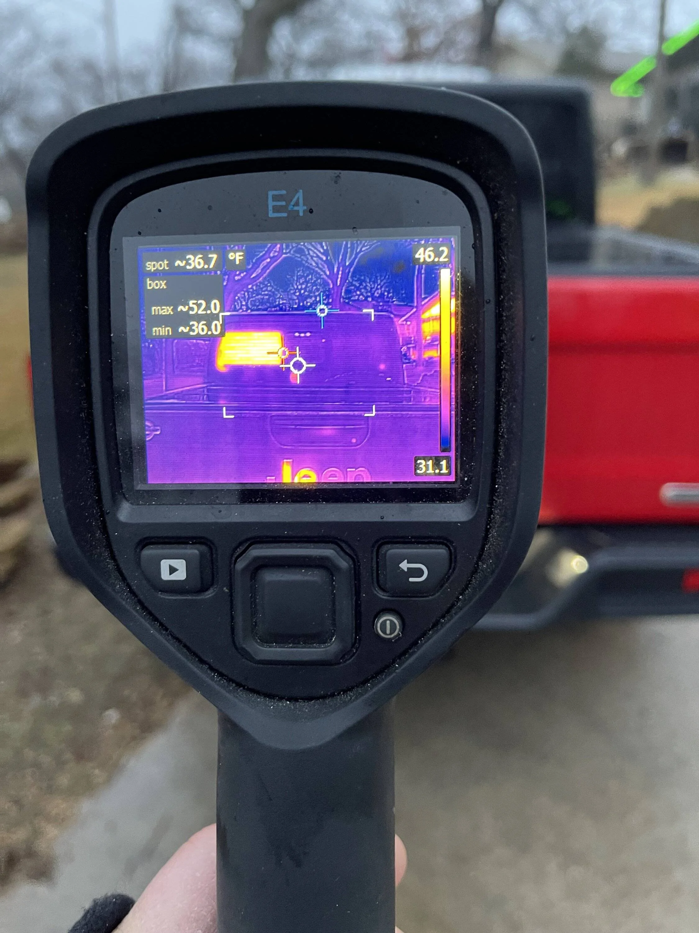

Building Engineer
Haven’t messed with it much. Likely just let the dealer fix it, don’t what them denying warranty.
Jeep Gladiator Rear window defroster 1/3 working IMG_6197
Chris A
Feb 12, 2024
64
49
Dallas, TX
Gladiator Overland
Building Engineer
Sorry about the second picture! Somehow my phone wants to attach a bunch of pics.
Could have been worse, way worse.
