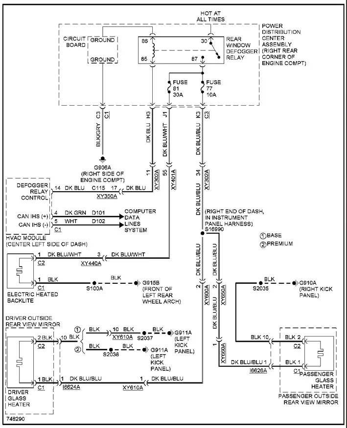

Check fuse 81 first. If the fuse is good, see if you're getting power to the window grid at the dark blue & white wire, and that you have a good ground at the black wire. If your power and ground are both good, look for a break in the heating grid.

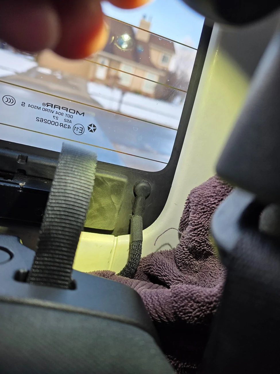

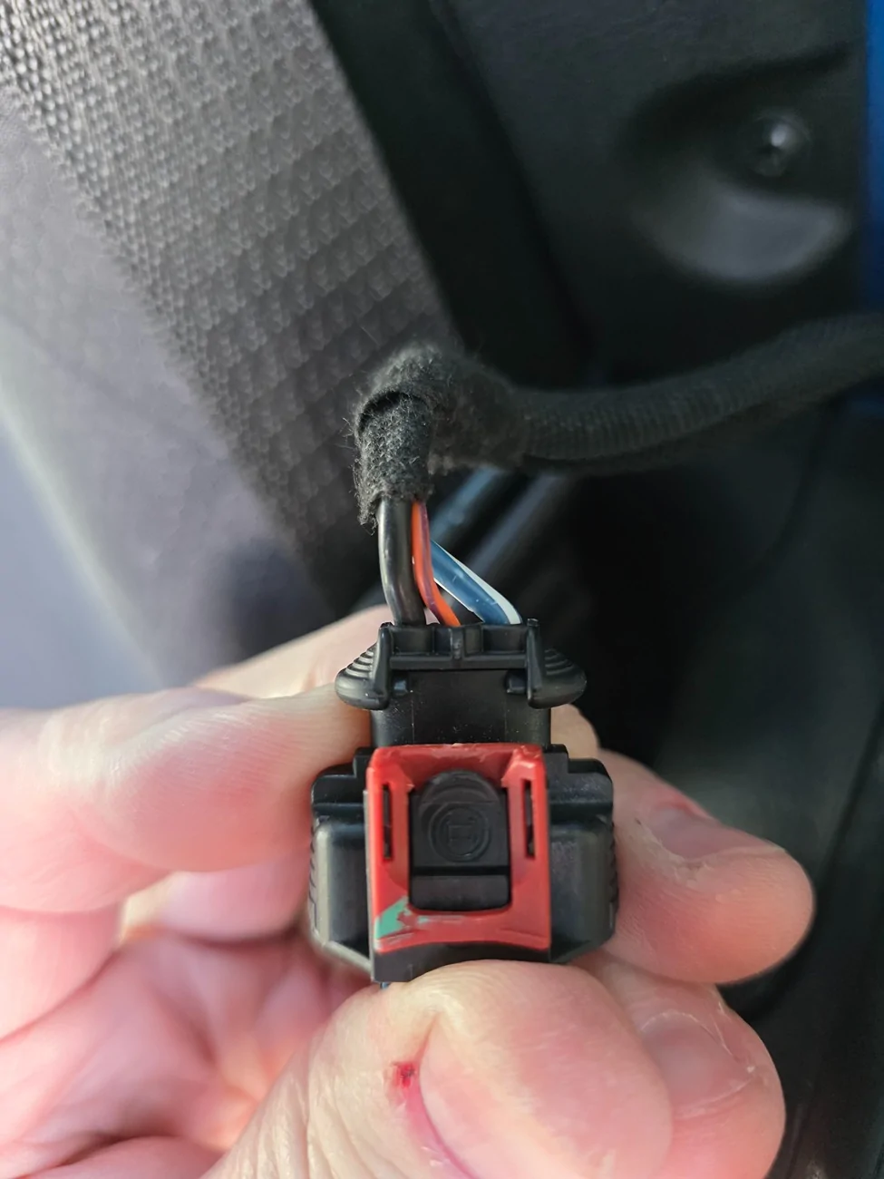

The fuse is good, I have power on the blue/white, continuity on the ground to the back. I don't have continuity between the blue/white and black coming from the back window. I do between the grid on the windows though. What's the orange/gray wire for? Also, should this black connector be loose at all? One side is, it turns, but doesn't come off. The other side isn't, but it was off once a while ago, and i had to use some adhesive to put it back on. My defroster worked since then though.

Does anyone know what the orange wire is/does?
