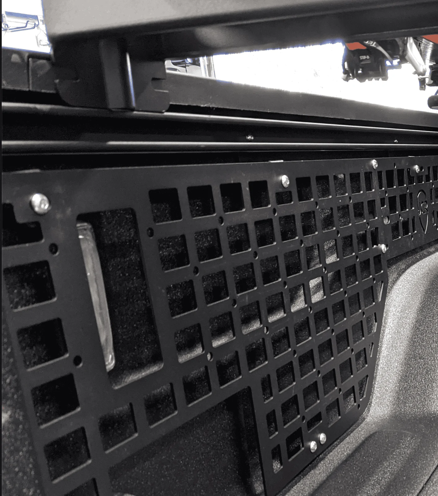

I tried to install all three together, and found they don't fit. Specifically the JCR Molle Panels have a bracket which is supposed to sit between the bed, and the bed rails. This pushes both bedrails inwards 1/8" and causes the bed rails to be 1/4" too narrow to fit the Artec Cross Members.

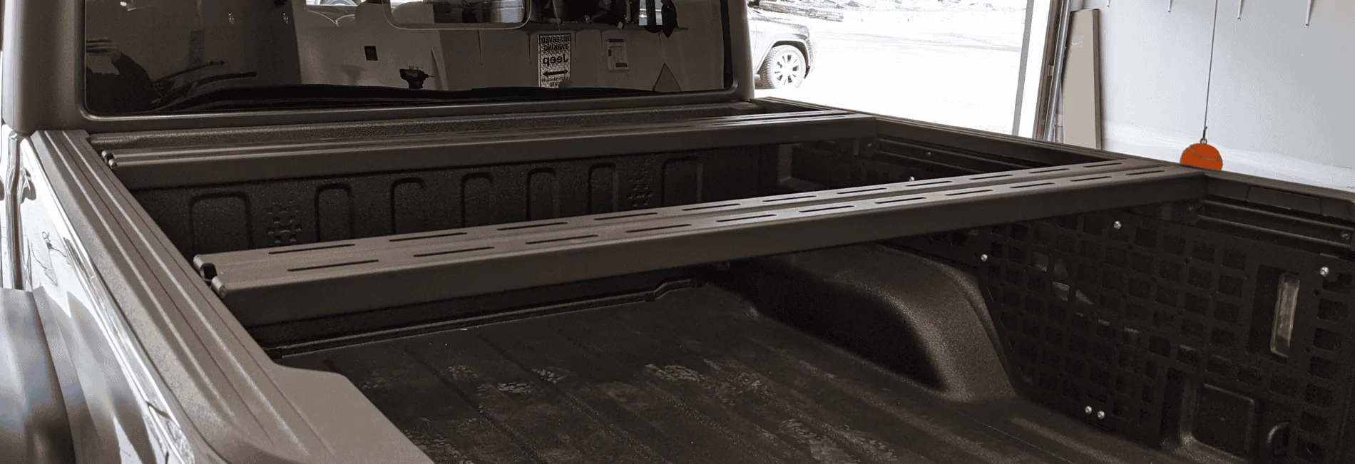

This picture shows the cross members can't slide between the bed rails:

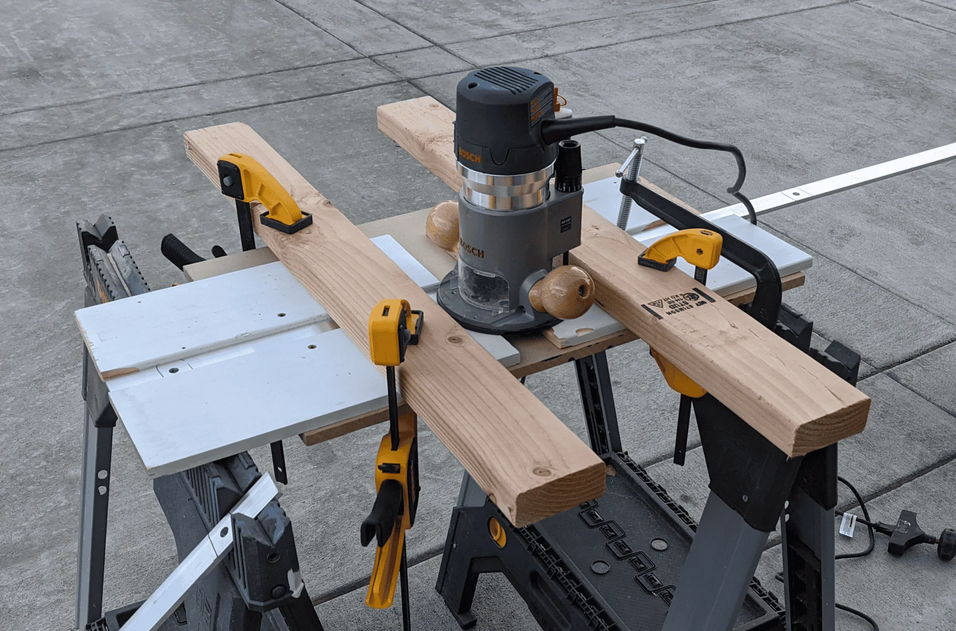

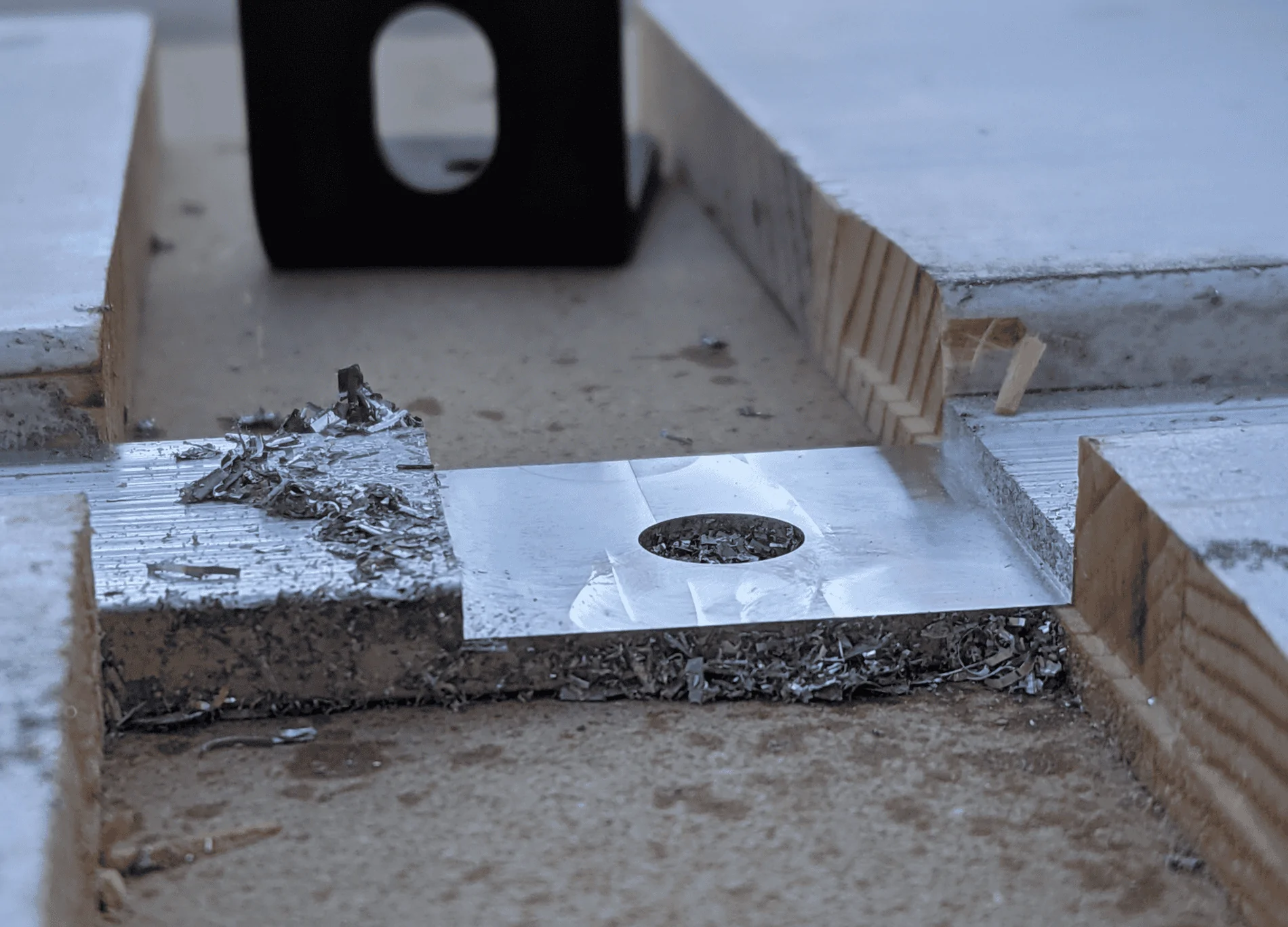

So I created a jig, and used a router + carbide bit + cutting oil to notch out channels. The brackets are 1/8" and the aluminum flat stock is 1/4".
Jeep Gladiator Rebel Offroad Bed Rails + Artec Industries Cross Members + JCR Molle Panels Screen Shot 2021-02-07 at 7.05.49 AM
Jeep Gladiator Rebel Offroad Bed Rails + Artec Industries Cross Members + JCR Molle Panels Screen Shot 2021-02-07 at 7.05.59 AM

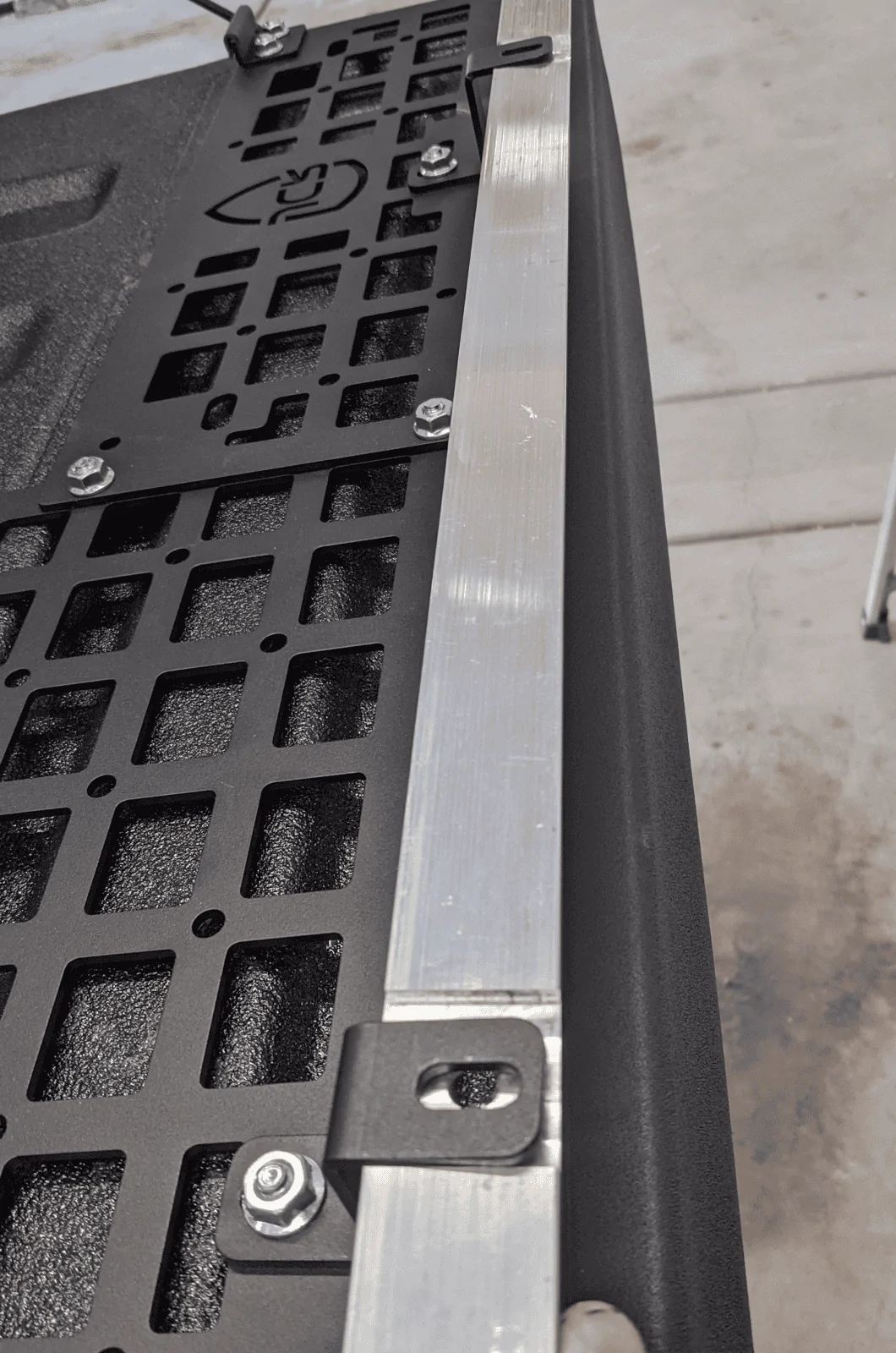

The result allows the brackets to sit within the flat stock channel and everything to work together:
Jeep Gladiator Rebel Offroad Bed Rails + Artec Industries Cross Members + JCR Molle Panels Screen Shot 2021-02-07 at 7.06.07 AM
Jeep Gladiator Rebel Offroad Bed Rails + Artec Industries Cross Members + JCR Molle Panels Screen Shot 2021-02-07 at 7.06.16 AM
