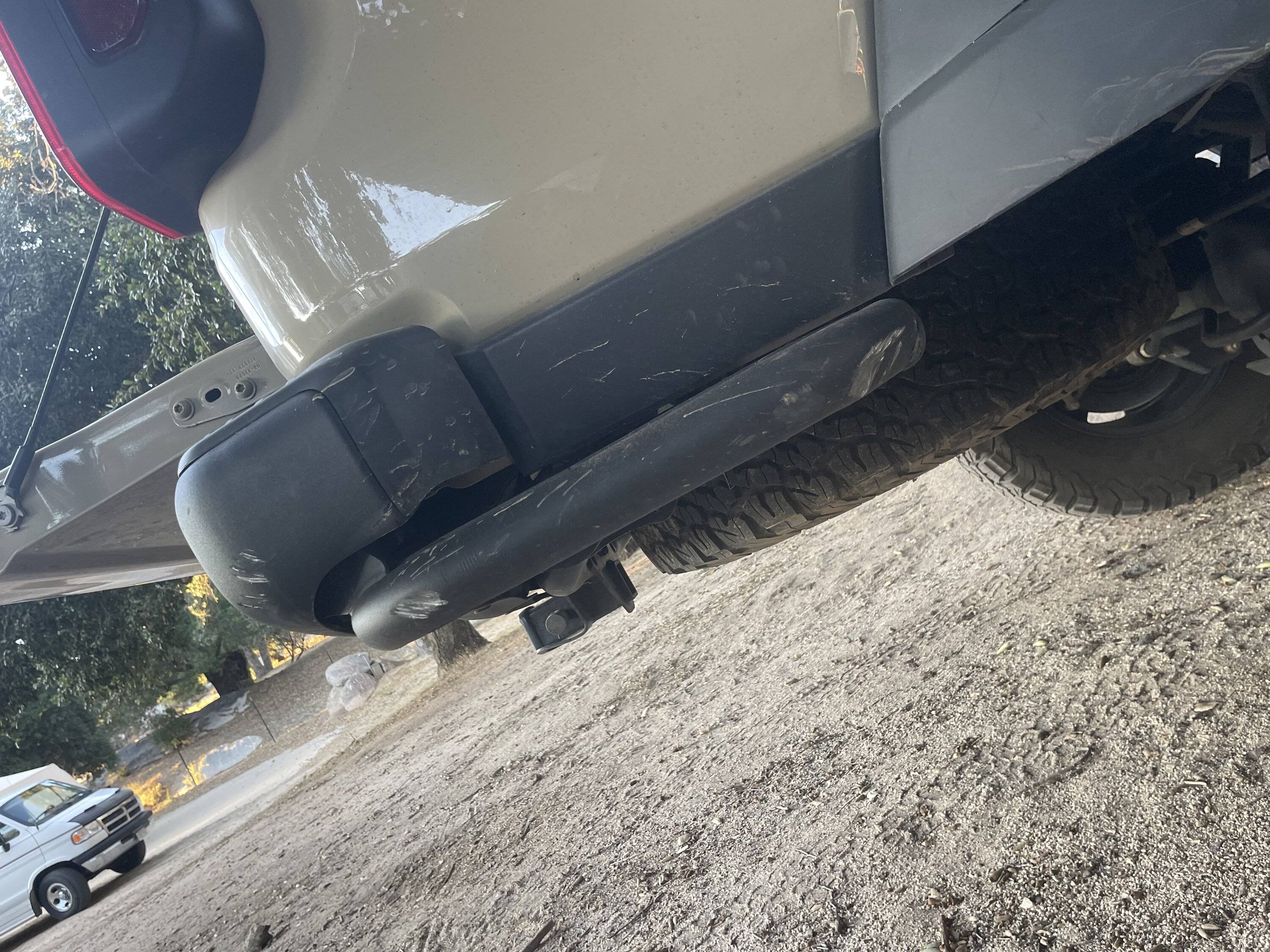

Installed these about a year ago and last month they saved my rear end. Came down on a rock (didn't realize til after) and as you can see I got some scuffs on the fender flare, bed slider (also dented), and the Rubicon steel bumper. Some minor denting on the bed slider (none on the bumper) but I'll take that over body damage. Other than the dents and small scuffs, the bed slider had no other damage and was not tweaked. It did its job.
