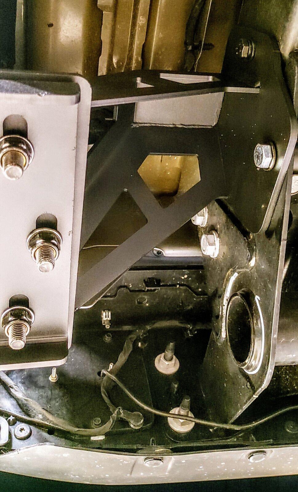

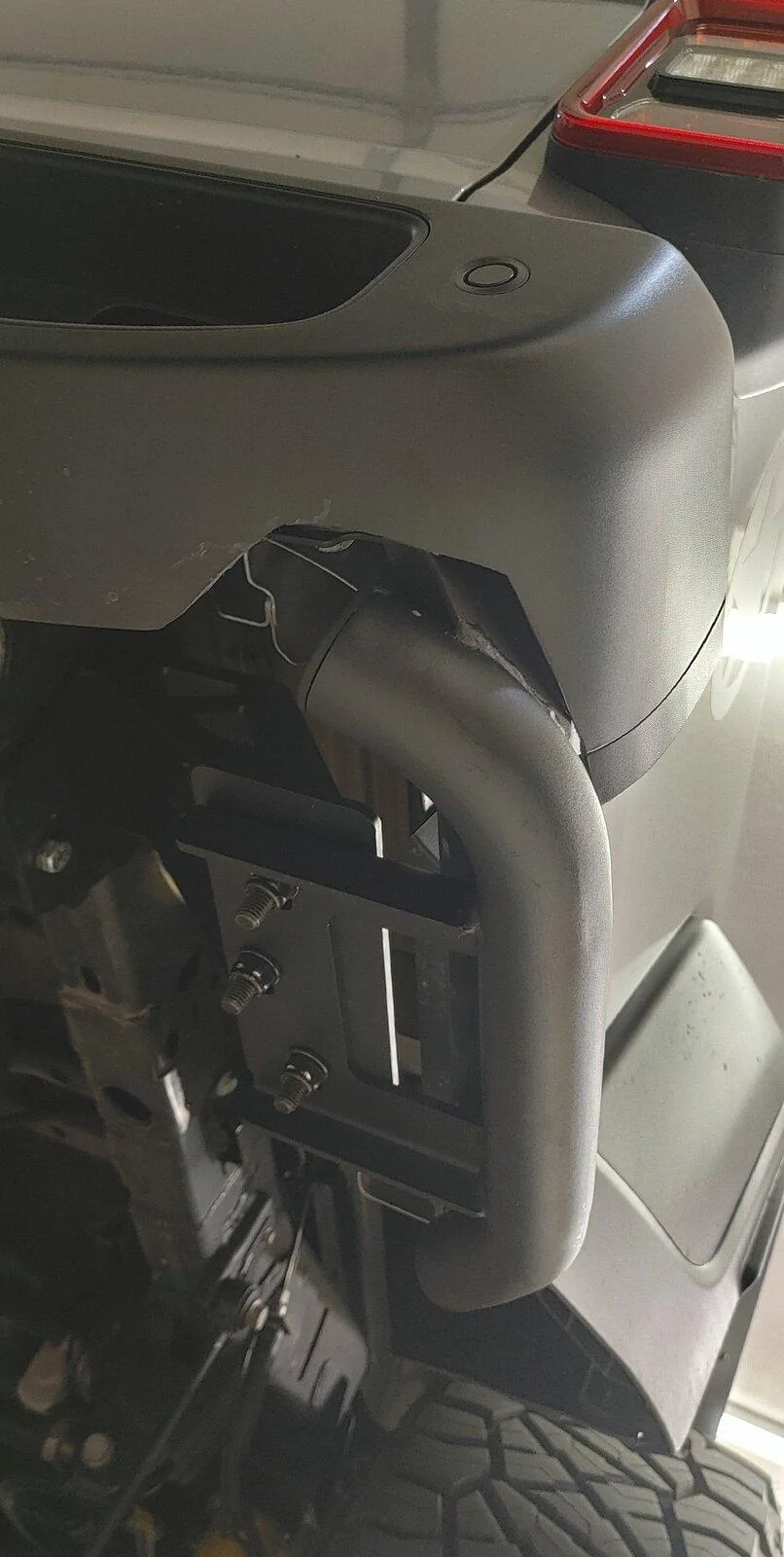

Thanks John...got them installed and I'm happy with the sturdiness overall. I haven't tested them out yet, but they seem to be more heavy-duty than some of the competitor products I reviewed. The heavy-duty structure and wider mount of the bracket appears to be a big plus.
I'm a little worried that a hard hit could push the DV8s up into the body, but I do think it provides much better protection than nothing at all. Before installing, I realized I had some damage to my passenger bedside from some previous trail runs. I do think that these DV8s will definitely protect from further damage.
@johnparjr....was curious if you got the 6th bolt inserted on the driver side that competes with the exhaust. Like the youtube video, I found installing the last bolt was not possible w/o completely removing the exhaust. Probably not a deal-breaker, but will want to get the 6th bolt in if I ever get an after-market exhaust (not likely any time soon).

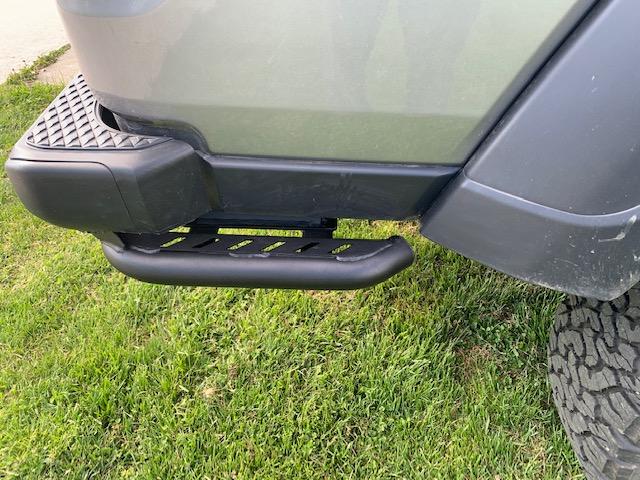

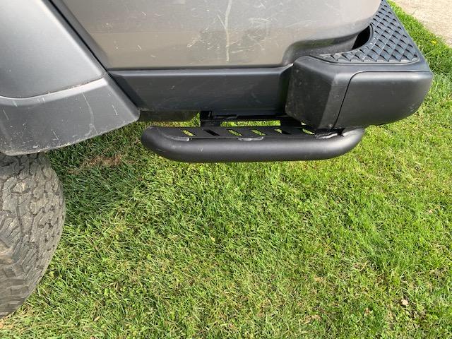

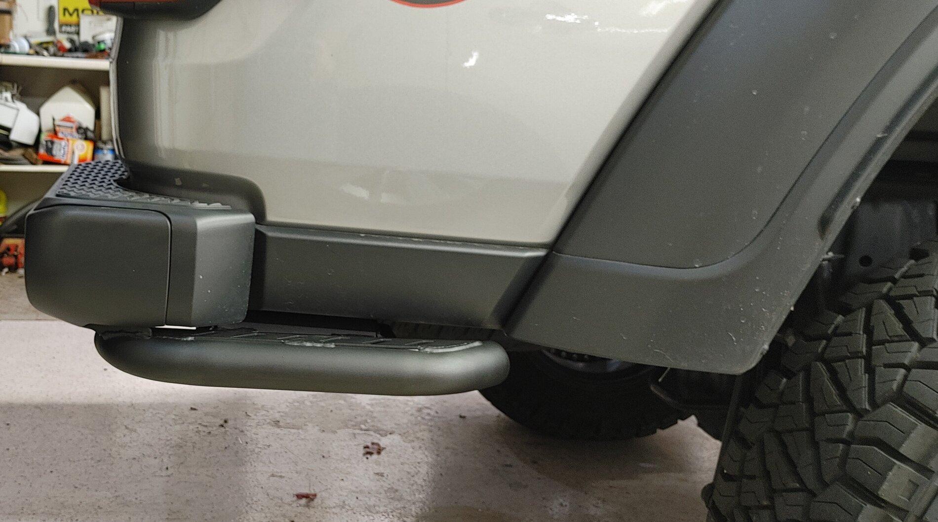

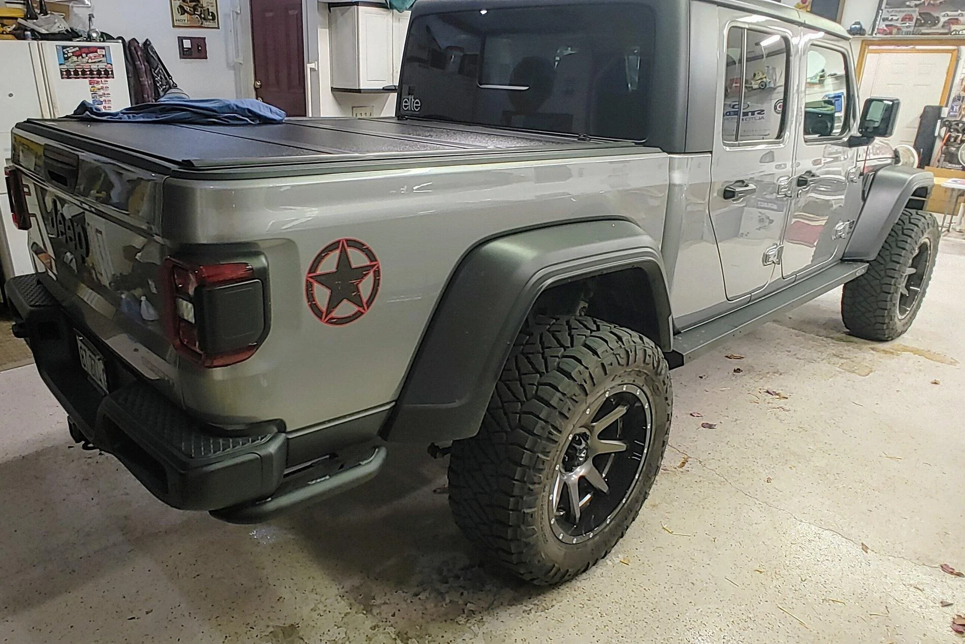

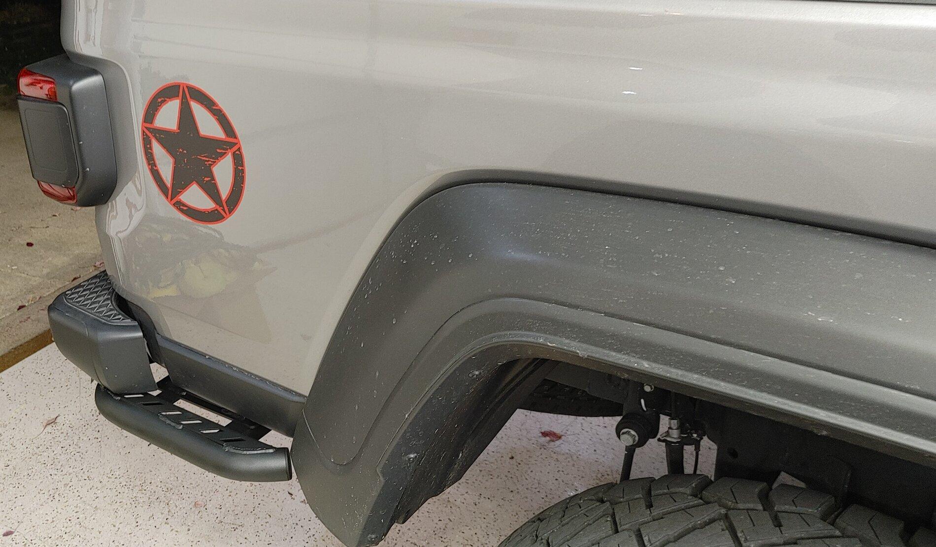

Bought and installed. PIA install. don't rush. I love these damn things. Big Savings, good protection. I have not added the bumper edge trim they supplied, wait for a warmer day. Don't ( do not) use a 4 inch cut off wheel. End result sucks and that plastic boiled and dripped. Be aware that the bed bars attach to side specific mounting brackets (supplied) Side specific! I wasted a little time before I had to unbolt and correct. Darn nice products at a great savings. 3 months to deliver 50 miles, so the back order will piss you off. Holds my 200 LBS and will save my knees for side access all year and deer season. 2 inch lift w 35s.

I ordered the Red Rocks about a month ago when I received an email from Extreme Terrain stating they were back in stock. I ordered on a Friday night and they were at my house Sunday morning. Impressive!

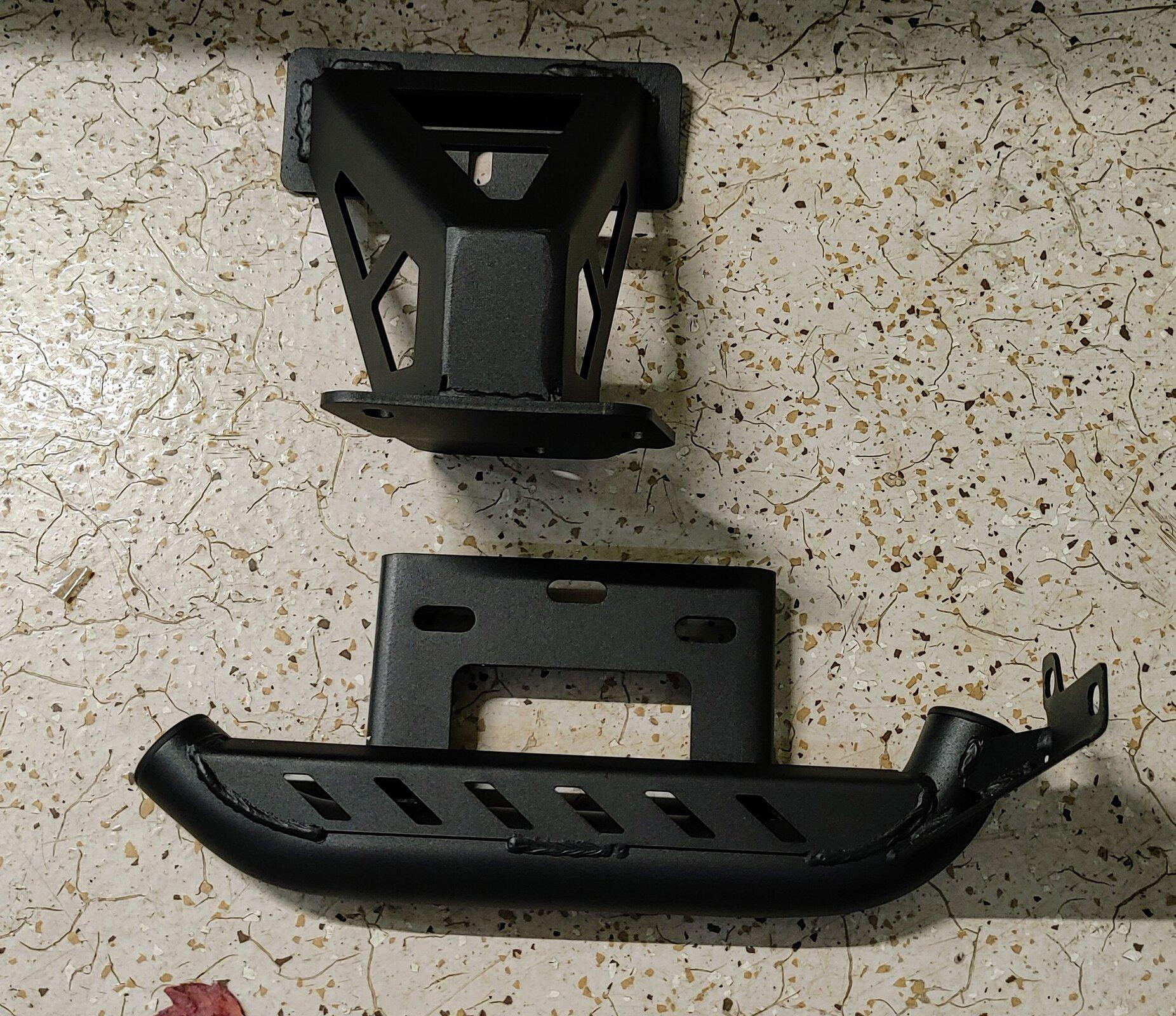

I was finally able to install them this weekend. The mounting brackets were incorrectly marked; the driver's side bracket was stamped with a P and the passwnger's side was stamped with a D. That didn't cost me much time because it was pretty obvious they wouldn't fit as marked.
The instructions say to mount the bed rail to the mounting bracket and hold the assembly in place to mark the section of the bumper you will trim. I found it a lot easier to not assemble the bed rail the the bracket and instead hold just the bed rail in place to mark the bumper.
The instructions also say to have the bed rail assembled to the mounting bracket when installing onto the truck, but I found it easier to install the bracket onto the truck first and then the bed rail to the bracket.
I am pretty happy with how they turned out. They are worth the price in my opinion and I really appreciate that they do not have their brand stamped on them anywhere.

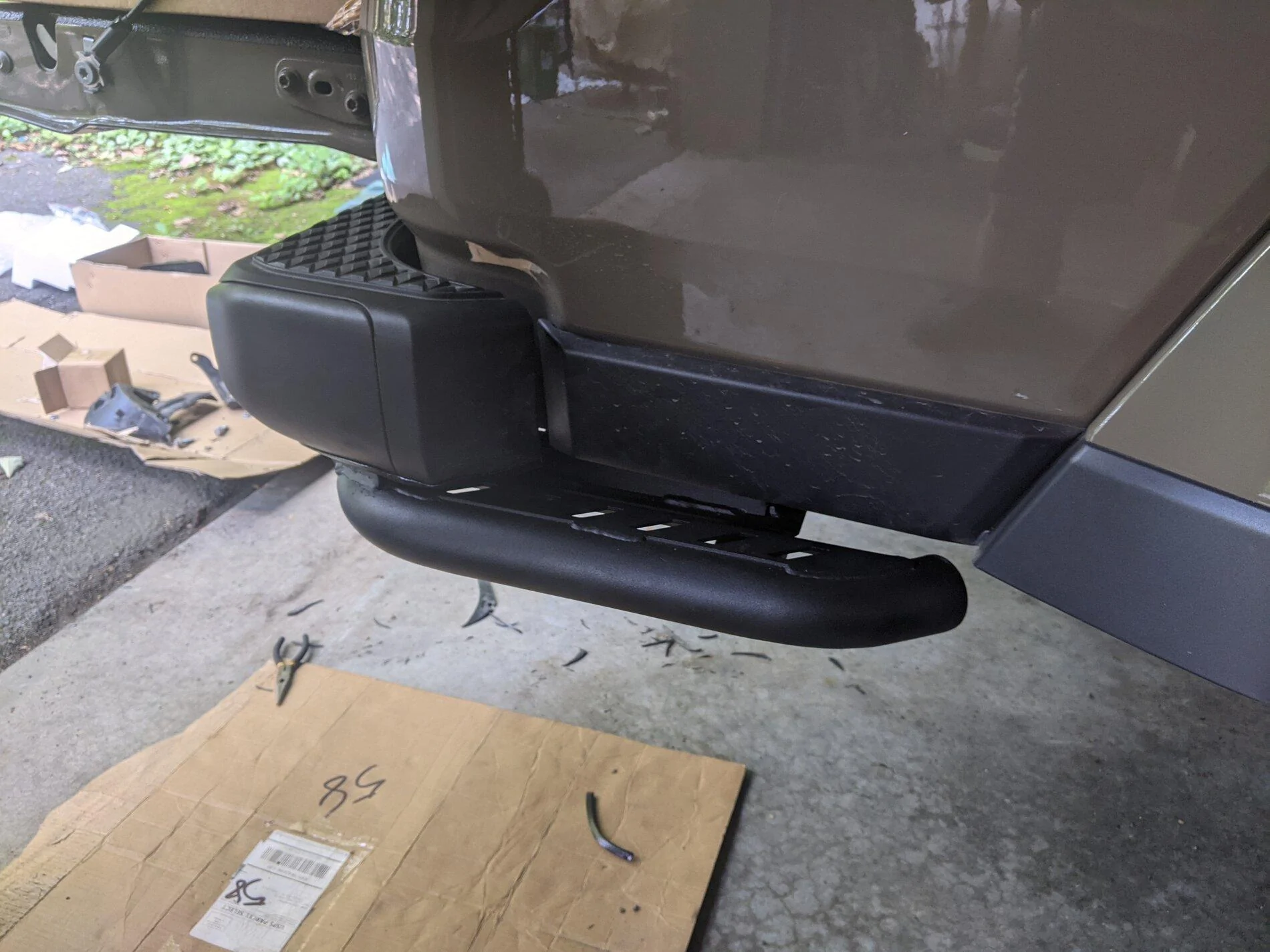

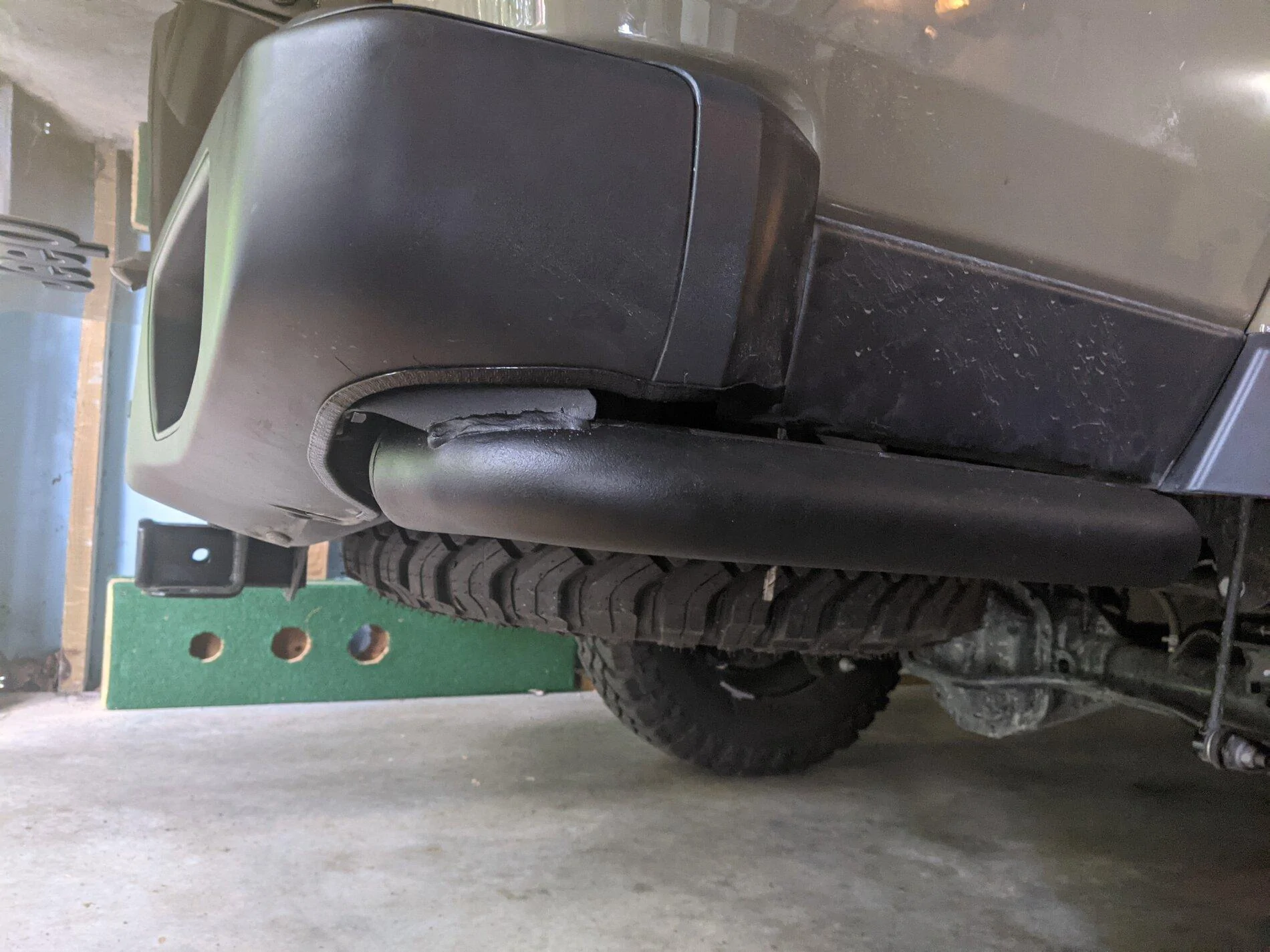

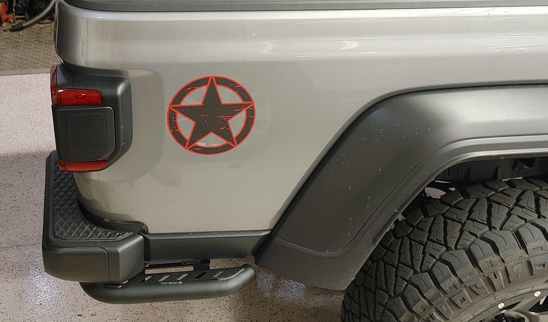

Added these yesterday, install really wasn't all that bad, just kind of time consuming. The most tedious part for me was cutting the bumper, trying to take off only what's necessary. I only used a razor blade which worked pretty well, though I did get one superficial wound.
Also the driver side install is a little trickier to work around the muffler. The mounting brackets were miss labeled as others have mentioned. Overall, love the fit and finish, and now I don't have to step on the bumper to get in the bed!

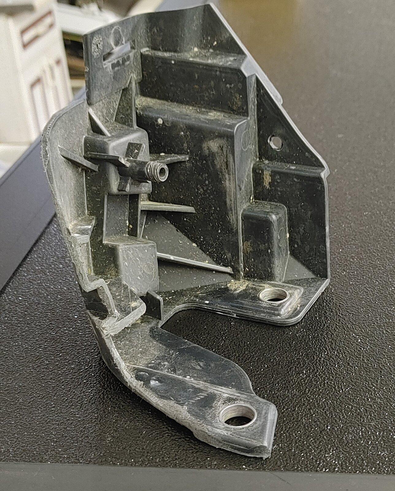

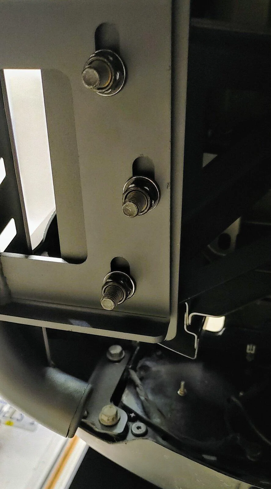

Well after seeing this post I pulled the trigger. I have a Max tow Sport S. I did have to trim the bumper bit it was not too bad with an air saw. The step bolted into the bumper nice and sturdy. The whole piece is decently made. The welds are a bit sloppy but not unsightly. This will help with some bed retrieval and the accidental whoops here and there.
Thanks for the detailed photos, now I'm not as nervous to take this one (I've had them a month now in the box). The last photos of the plastic piece you removed, does that require removal just to be able to cut the bumper, and did you cut it an reinstall, or does it need to be left out for the rail to be able to mount properly?
@DAVECS1 I'd like to know as well. I'm also curious about that last photo of the plastic piece. Does it stay off?
@Geo Jeep , By enlarging the pic, it appears that is the actual piece that was cut out, it looks to have been cut. So I'm guess that obviously stays off once its cut away. Does look rather large from the pic though which brought about my curiosity too. I may go ahead and go with these after all.
aqcjeepGlad
Tony
Jul 1, 2021
243
201
South
Mojave
That piece gets thrown in the trash and part of the slider is mounted to the rear bumper in its place.
So what supports the plastic bumper if that piece is throw in the trash? Also, the instructions say to remove the steel support bracket, but I did not see where they say to reinstall the steel support bracket. Thus, do you leave it off too? It appears the slider will not fit with the steel support installed. Just makes me wonder about the sturdiness of the plastic parts that are left hanging there without any support. Has that been noticeable for anyone that has installed these sliders? Other than these questions the sliders look great and the welds on mine are awesome as is the finish. I originally was going to buy the mopar ones but they are almost $500 where as these red rock sliders are only $195 and seem very sturdy. Thanks for the help everyone.
The slider supports the bumper. It's very sturdy. I installed my like a year ago so I don't remember all of the details, but pretty sure you will not need the steel piece you removed either.
