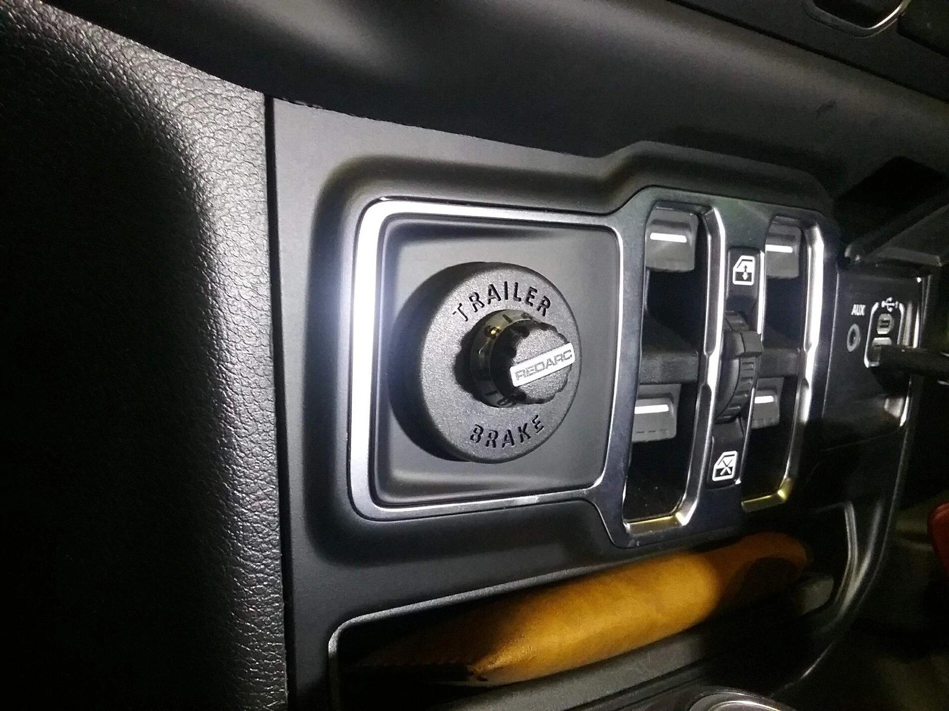

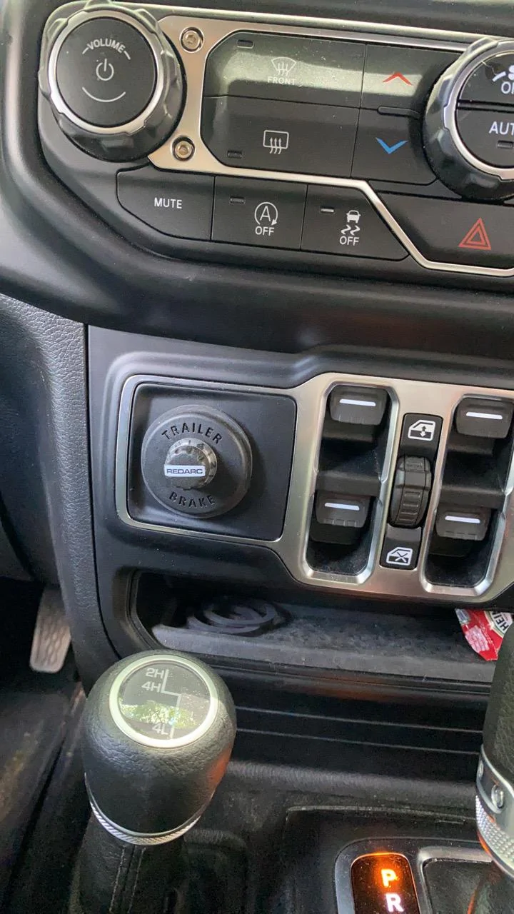

Going to install a Redarc trailer brake system. My question is where did you mount the remote knob?
I knows it's pretty small. Just looking for ideas.

If you put it in the factory location you will need this tool
Dorman 57450 Lighter Socket... https://www.amazon.com/dp/B01ID3H3SC?ref=ppx_pop_mob_ap_share
Lots of times Amazon will also have them used as it is something you use once and people use them then return them.

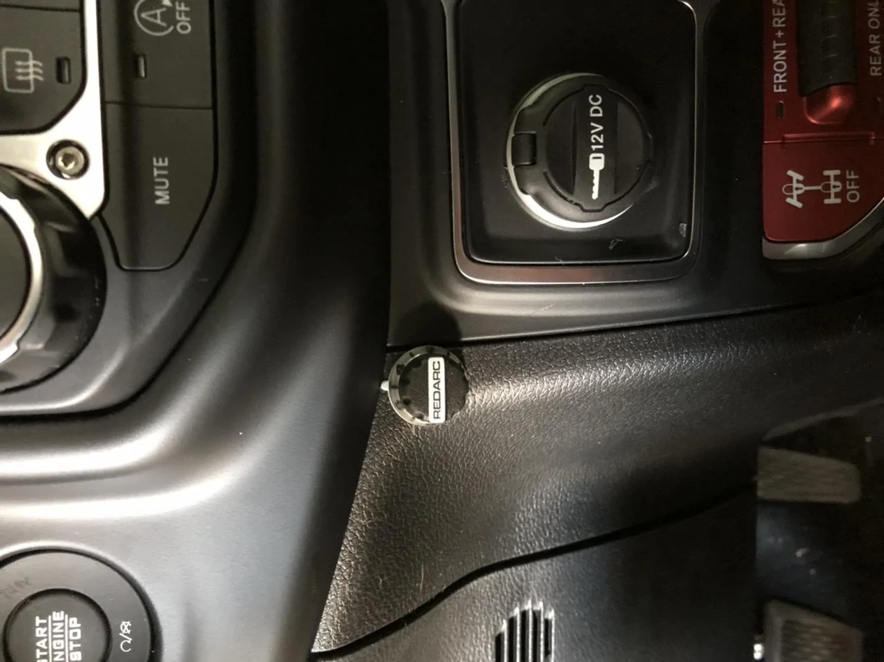

Thats good to know. But I use that 12vdc socket to power up different items. So I will have to locate iy else where. I think its going to be under and to the right of the push to start button.

Make sure you have enough depth for the rest of the button. I know there is a video showing where to put it in that location. I intended to eventually put my power outlet in the back of the console where it would be if I had the inverter. Quadratec (and Amazon ) carry a extension that makes the wiring plu and play.

I do have the inverter. I've had my dash all apart I had to add a front camera so I'll double check the space behind where ever I put it.
