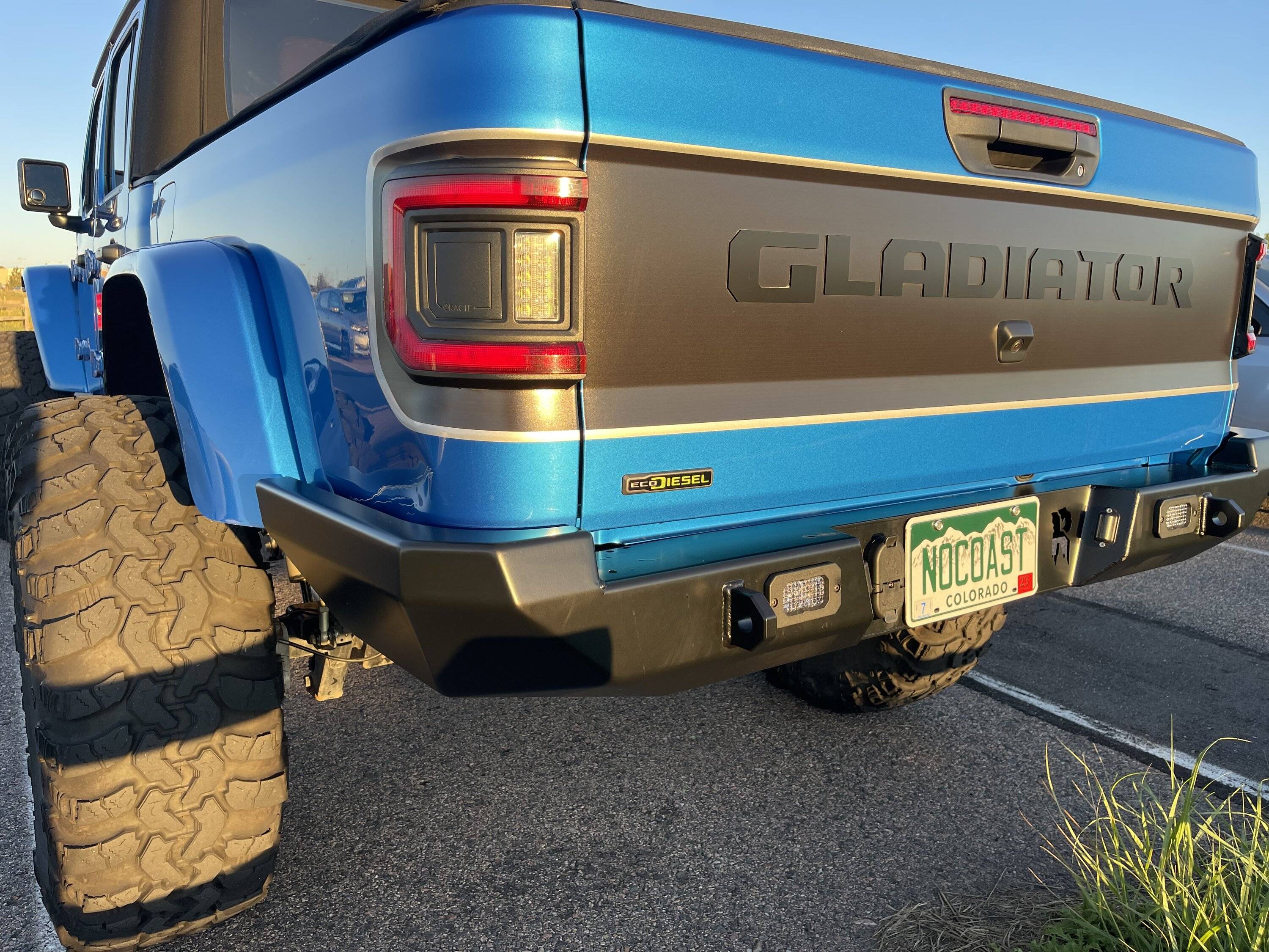

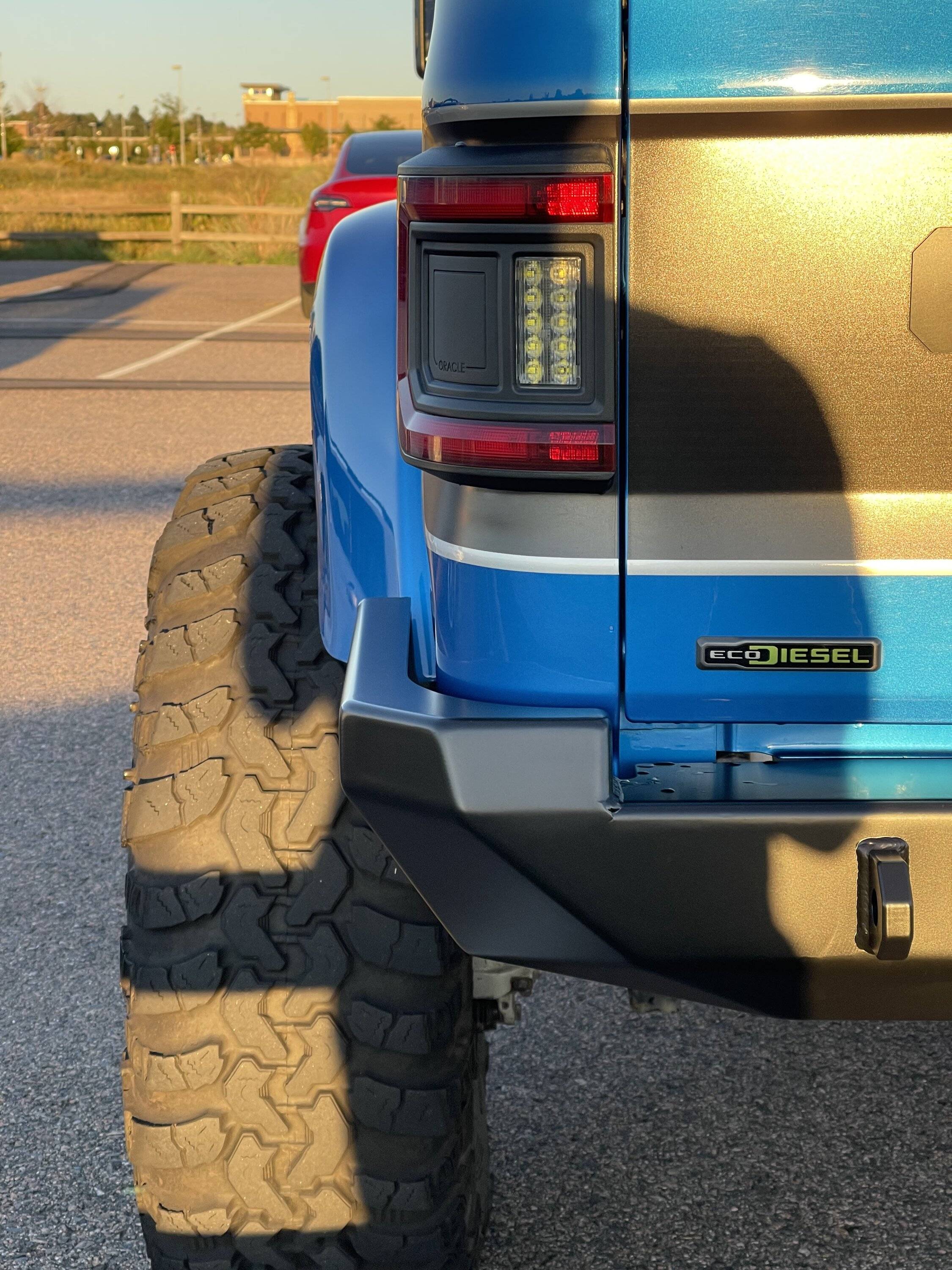

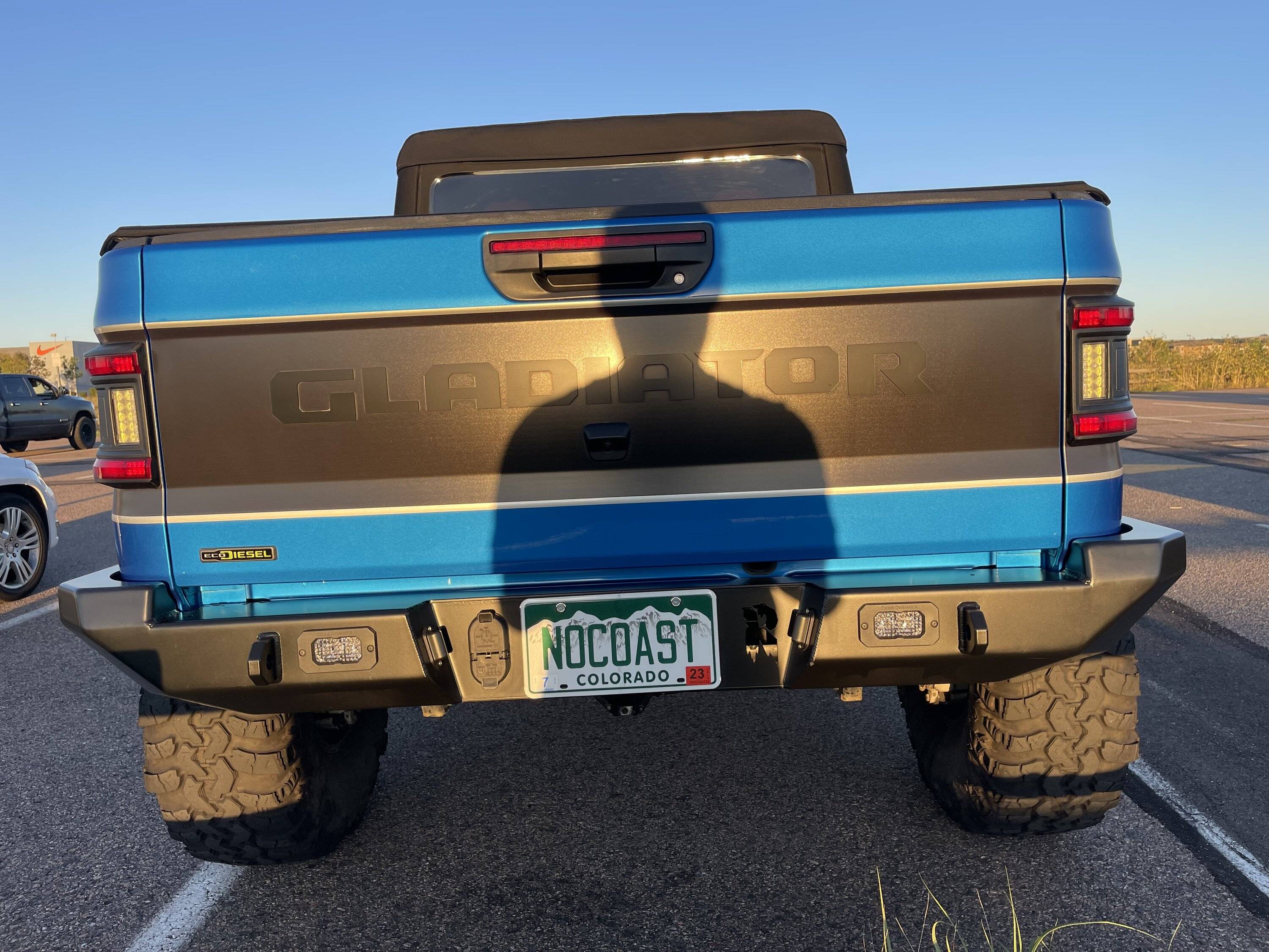

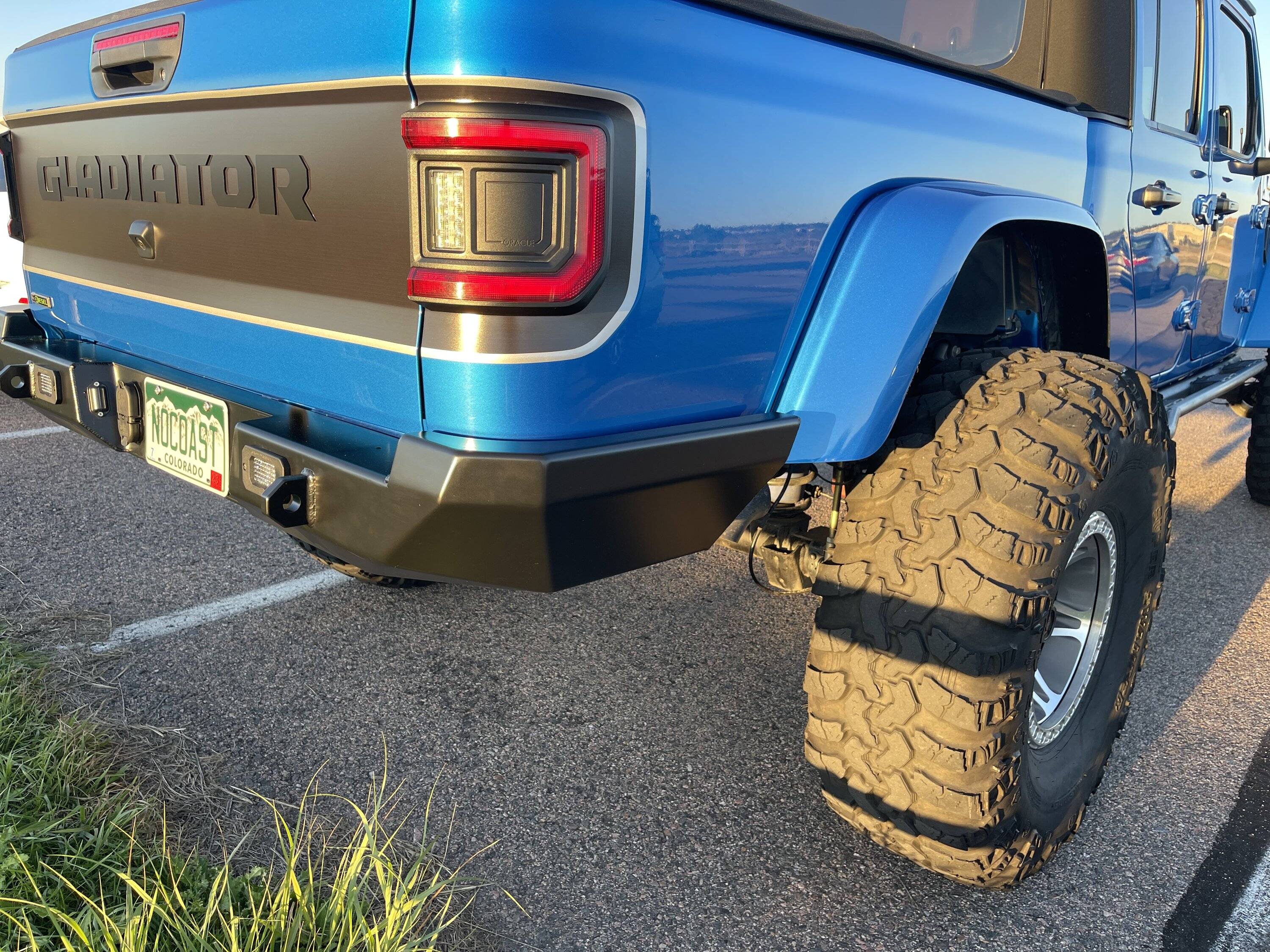

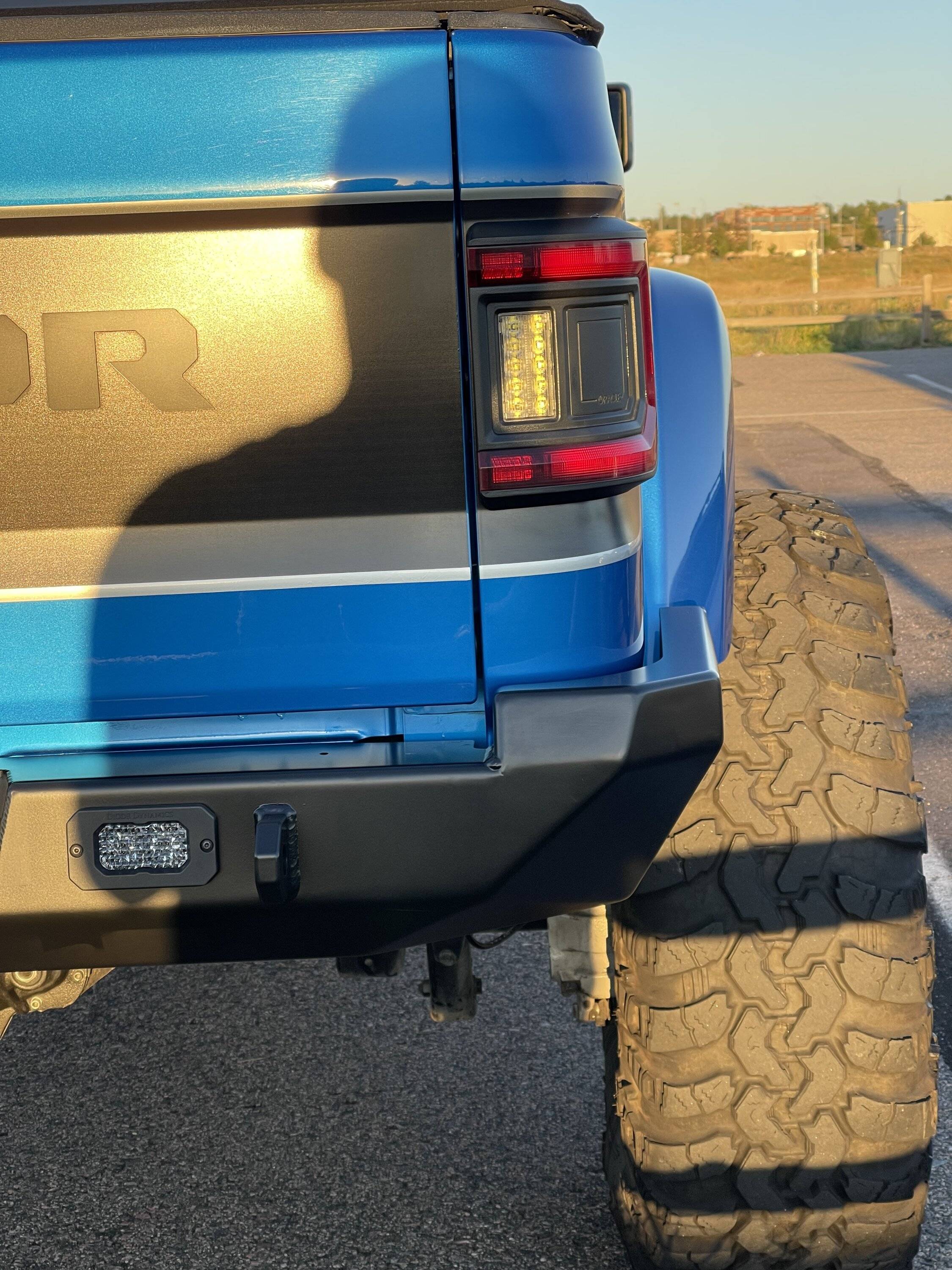

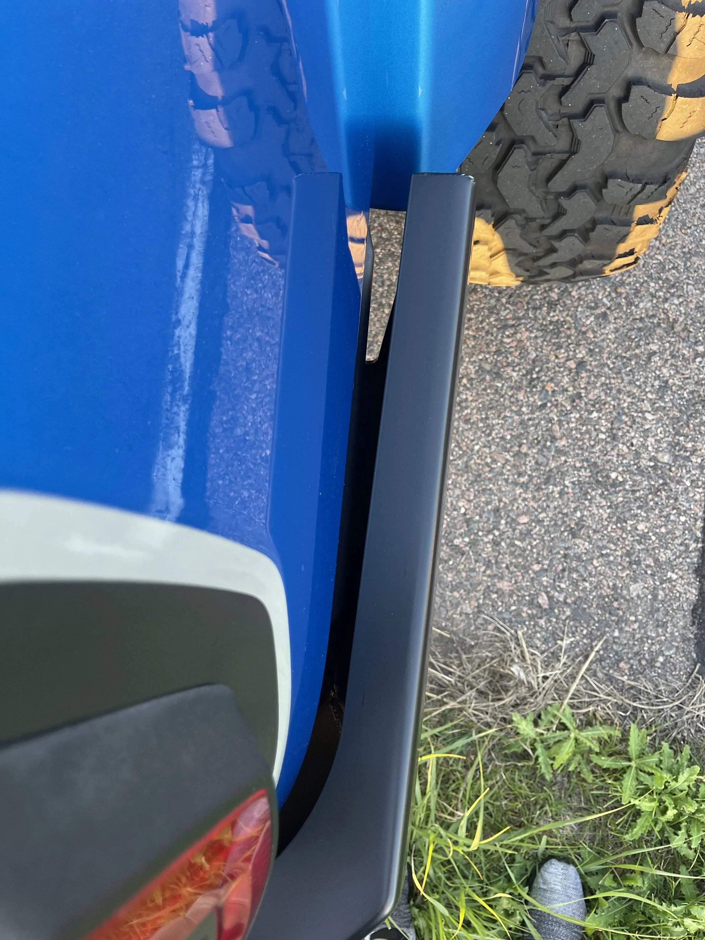

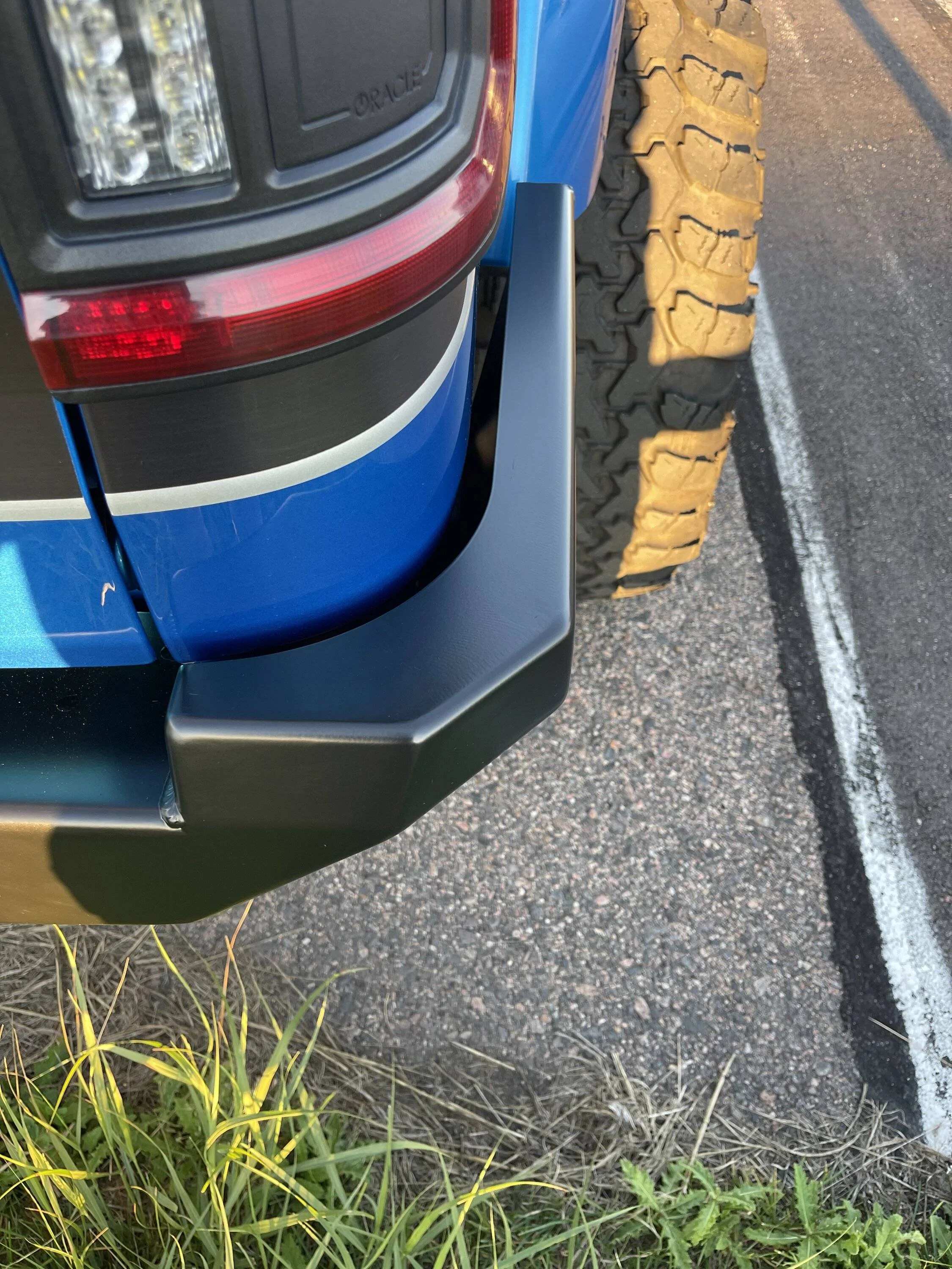

Finally got around to installing the bumper. Had to modify the light holes to accommodate the Diode Dynamics lights. I chose these light because I love the backlight feature and the fact they have a harness that plugs into the hitch so I didn’t have to cut any wires. Otherwise, this was a very easy install. The hardest part is getting the old bumper off.
Jesus… how much offset are you running? That looks incredible. Just noticed you’re not to far away. Would love to see it in person something. I’m so close to pulling the trigger on this bumper.
Those are 73.5" wide Dana 70 axles with 3.5" backspacing. She is VERY wide! I really need to get to about 4.5-5 backspacing to help my scrub radius a bit. I'll go there if/when MT ever releases their Baja Boss MTs in 42". I am in Aurora near Southlands. Lets definitely link up.
