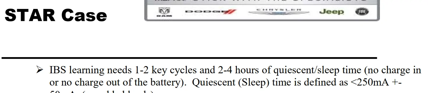

quote form online :
This relearning process requires 5 normal, operator initiated starts with at least eight hours off time between each start. Usually, the process takes a few days of vehicle operation to complete.
Not sure where that comes from, the FCA info is different, and it often happens in 4 hours or so.
This is June 2024 from FCA STAR -
Jeep Gladiator remote start dont work in the cold 1759371711321-51
My experience is no more than 4 hours, and just 1 or 2 crank/startups tops.

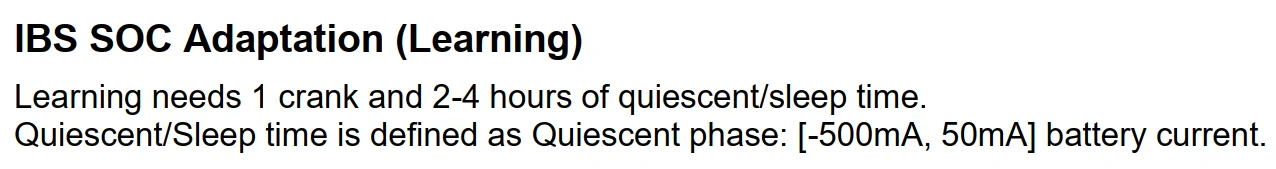

Here's from another FCA STAR document -

Hmmm, do your motorcycles and old cars have AGM batteries? They are quite different in charging needs.
I noted the "watermark" on the one image there - it's sort of a hodge-podge of info out there as "service information". Some from FCA, some from who knows. One of their documents actually contradicts itself, and one says "Jeep says that" on one page, then says something else on another page.
My personal experience doing the full recharge and reset matches the 4 hours bit.
