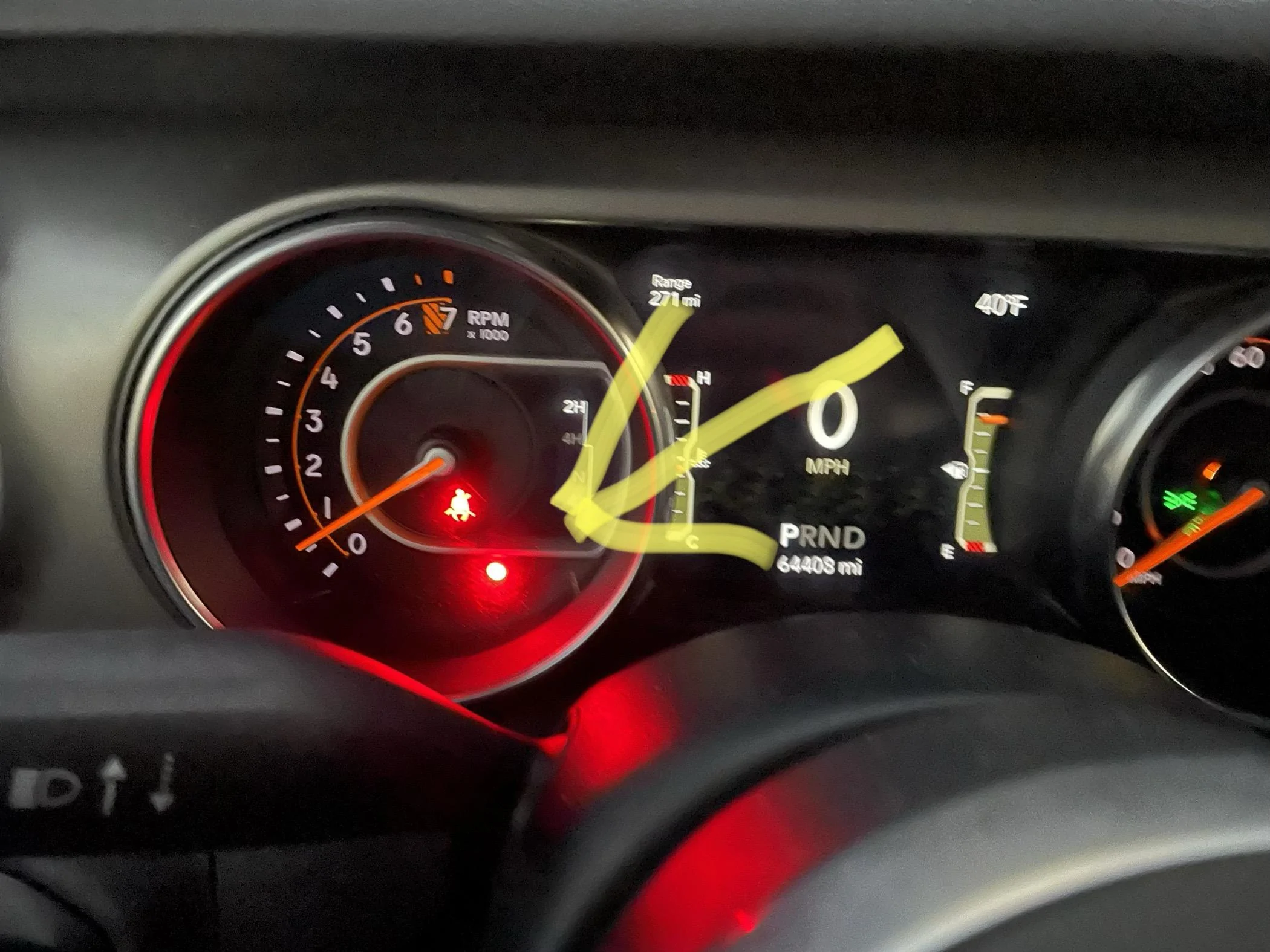

My resting voltage is 12.2. Not really sure if that’s too low to crank with the remote but it starts fine the normal way. Also, is it possible it’ll recover when it gets warm? My start / stop doesn’t say charging as well. Any chance it’s the key fob even though it goes through the motions and the locks work with it? TIA
Edit: it says start/stop not ready but no reason why below it.

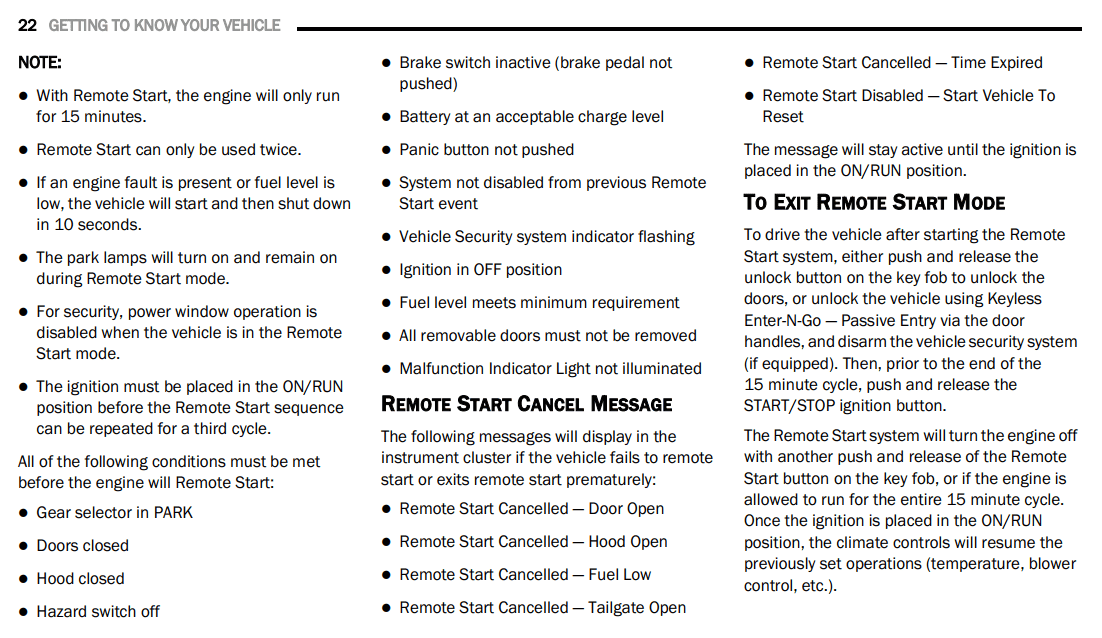

We've had a cold snap here in the SE this week and my remote start isn't working. The lights flash, and it attempts to start for about a half second and then nothing. It starts just fine normally. Battery shows 14+ once running. Is the Aux battery responsible for the remote start? Thoughts?
I had the same issue. I replaced both batteries and it corrected the remote start.
