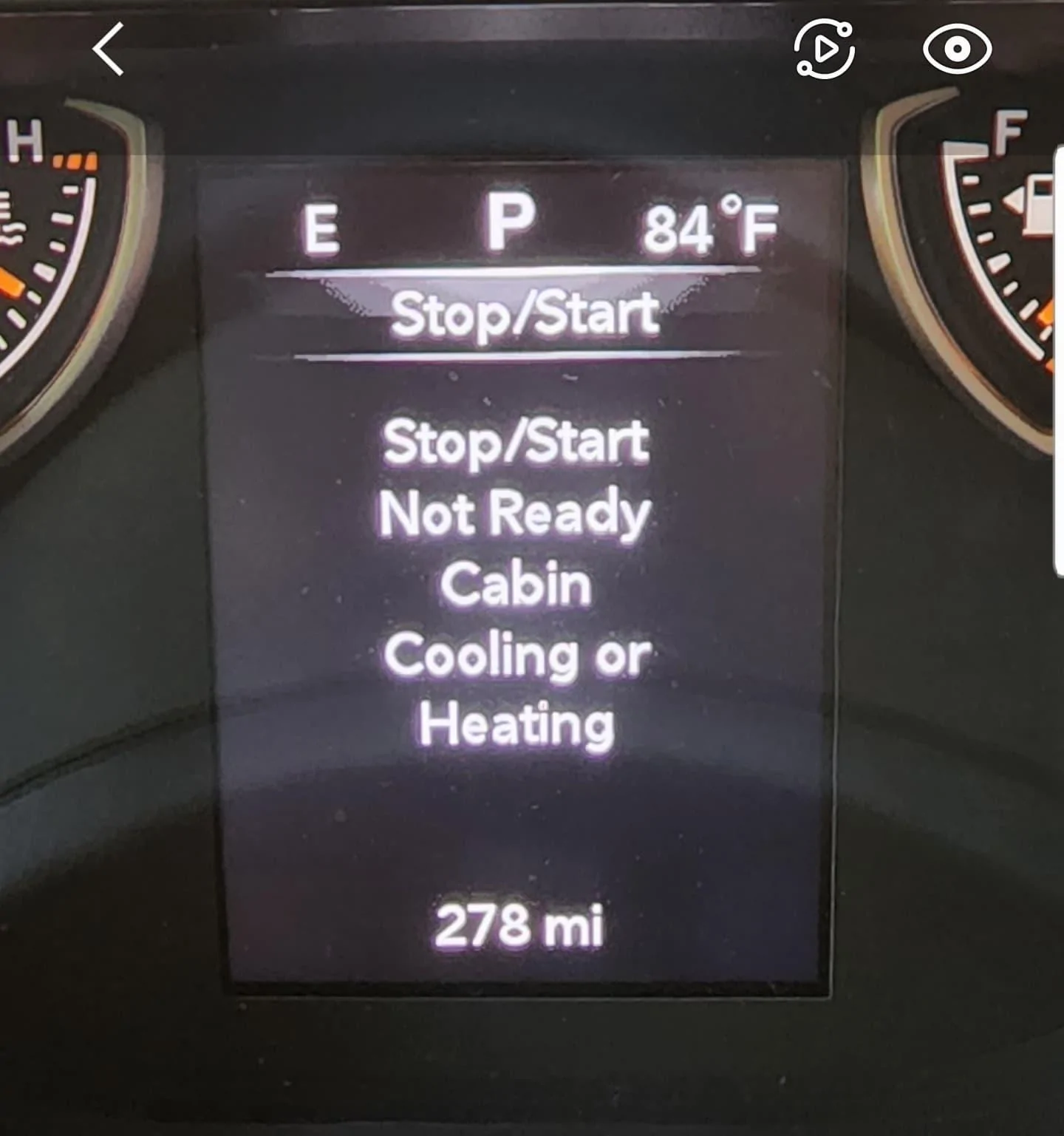

I ended up toggling through the screens and the start/stop was off because I was using the AC. Thank you all for the input. Mystery solved.

This says the heat / AC does affect it.
Wow. Reading really is fundamental. It states the cabin is cooling or heating. Not that the AC or heat is on or off. I have now owned two completely separate and distinct Gladiators. I assure you, just because the AC or heat is in the ON position, doesn't not mean that ESS/ASS will not work. If it's 80 in the cabin and you have the auto thermostat set to 68, then no, it will not work. If the thermostat is set to 68, and the internal temp is 68 or below/above, then it absolutely will work.
I will stipulate that I have not tried it with the AC ON. I always use the auto feature. If that is part of a misread or miscommunication on my part, then I apologize.

I do not have the AC or heat temp on auto.
