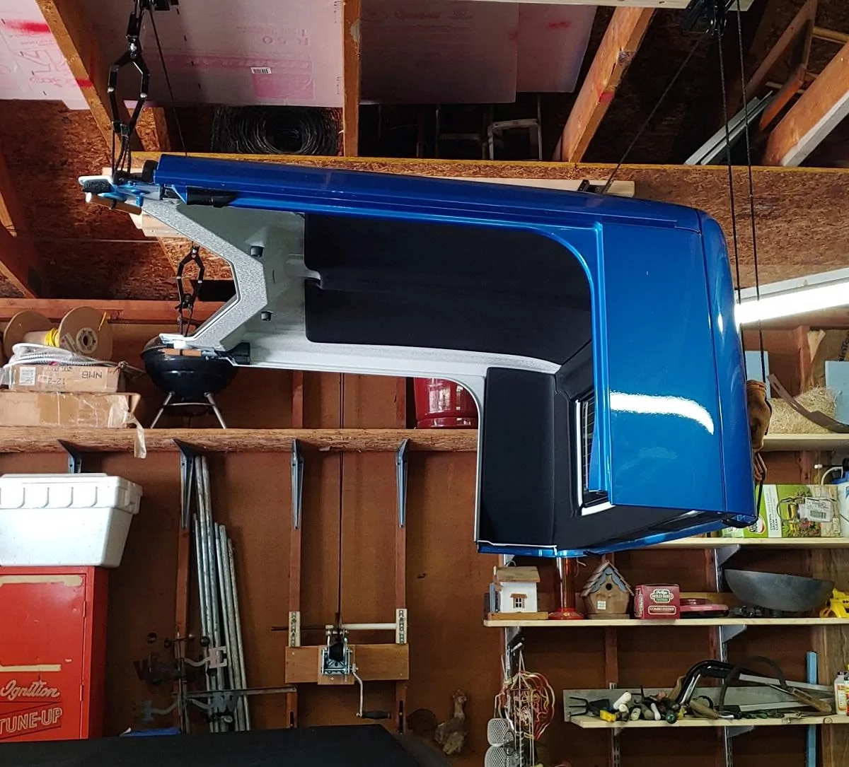

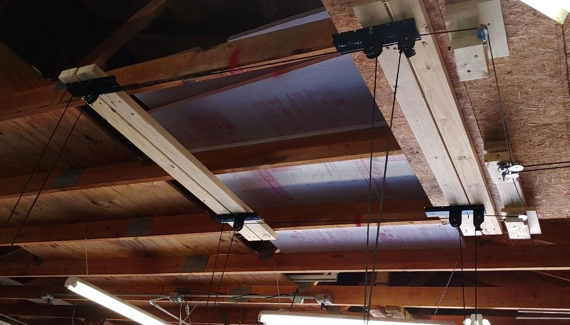

@ShadowsPapa , technically you should hang from the upper chord of a rafter. At a minimum put additional screws here to spread the load over 3 rafters.
There actually are screws up into all 3 (see pic below)

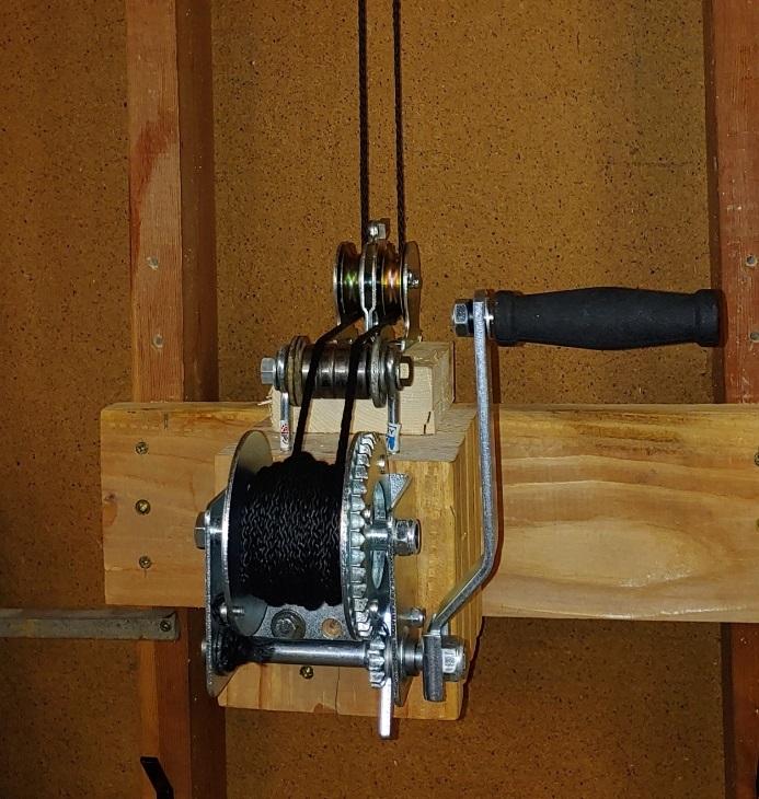

When I was sure how it was going to work and I was satisfied with the position and all, I went through and put more screws in. Some of the screws are the same type that hold shelves to the walls in my shop that have several hundred pounds of car parts on them.
I took pictures all along as I put it together.
Because the guy had sheets of OSB screwed up there, I couldn't put these 2x4s above without ripping all of that down. Seems there was something else up there, too...
I figured if I could hang from one of those rafters, that roof a fraction of my weight could hang from 3 of them tied together LOL
The original builder has all of the rafters tied together down the middle with plywood running the length of the garage. It's a truss roof structure and he used to use the upper area for storage.
I got curious as I was putting this up and used my long straight edge along the bottoms of the rafters and there was almost no deviation. I was amazed that a 40 year old structure that had things stored up there for years was still so straight, but that's how the guy built things. He worked for a large commercial construction business in the area and built the place for himself.
