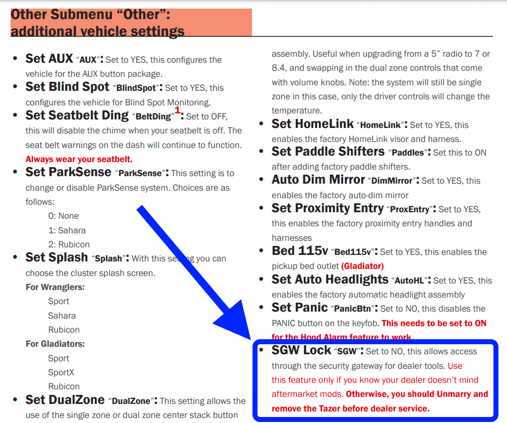

What is the result of just disconnecting the Tazer mini, and reconnecting cables to SGW, not unmarried ?
The changes you made with the Tazer, stay in the computer.

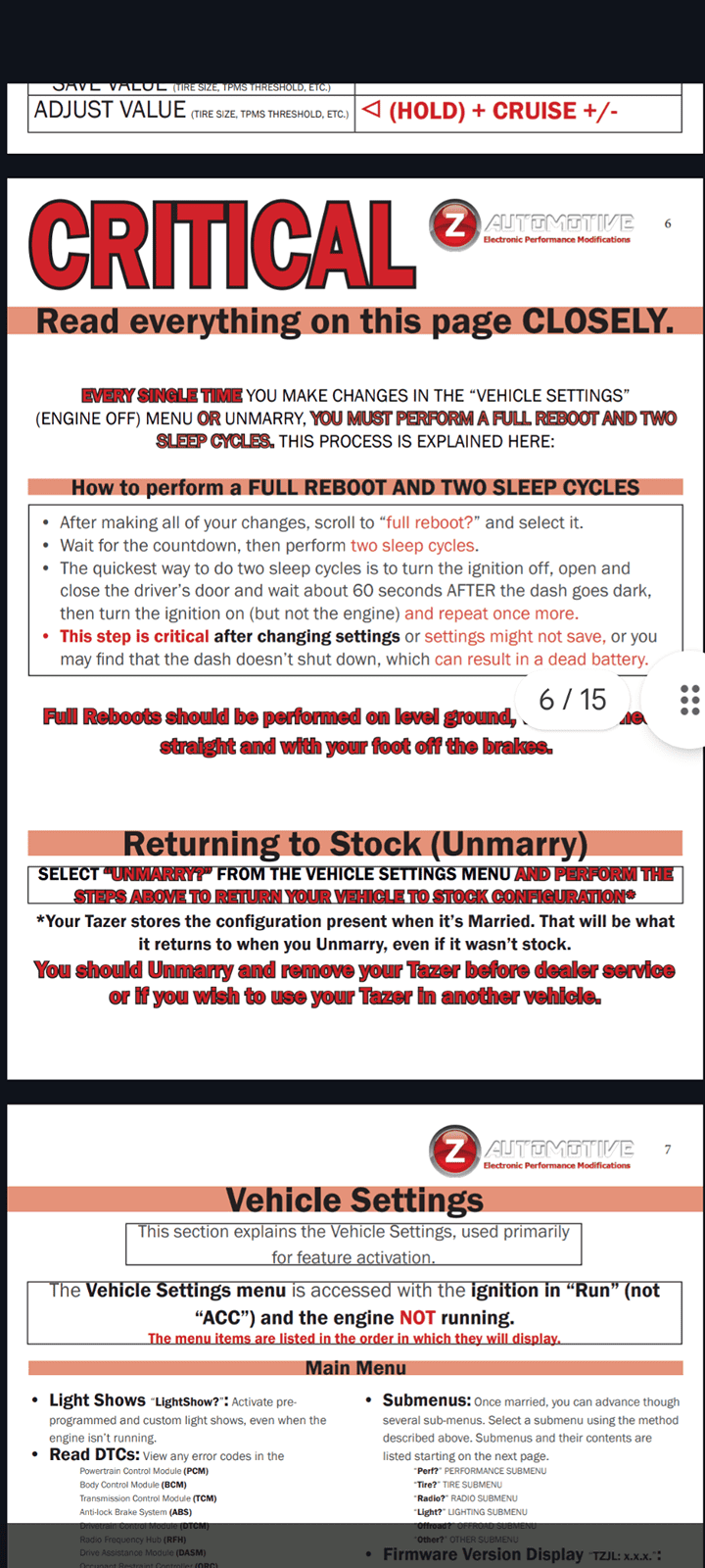

Jeep Gladiator removing Tazer mini before going to dealer? Screenshot_20240607-163932

Yes…you must unmarry and remove it before taking it to the dealership. Any programming or updates they perform must be done without the Tazer married. That said, if you have re-geared and they install any new modules or the Transfer case itself, you will need the marry the Tazer back up or it will throw codes like crazy. Once married and all the parameters, gear ratio, tire size etc. are reprogrammed the codes will go away or not be thrown at all. This happened to me with a new transfer case. PM me if you have questions.
