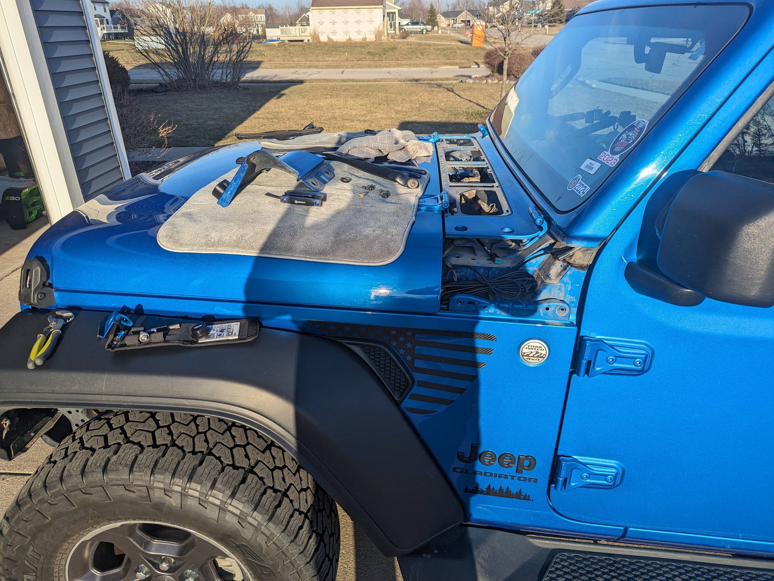

I removed mine yesterday and started from the driver's side.
Jeep Gladiator Removing Wiper cowl (painted section) PXL_20240222_221119296.MP
