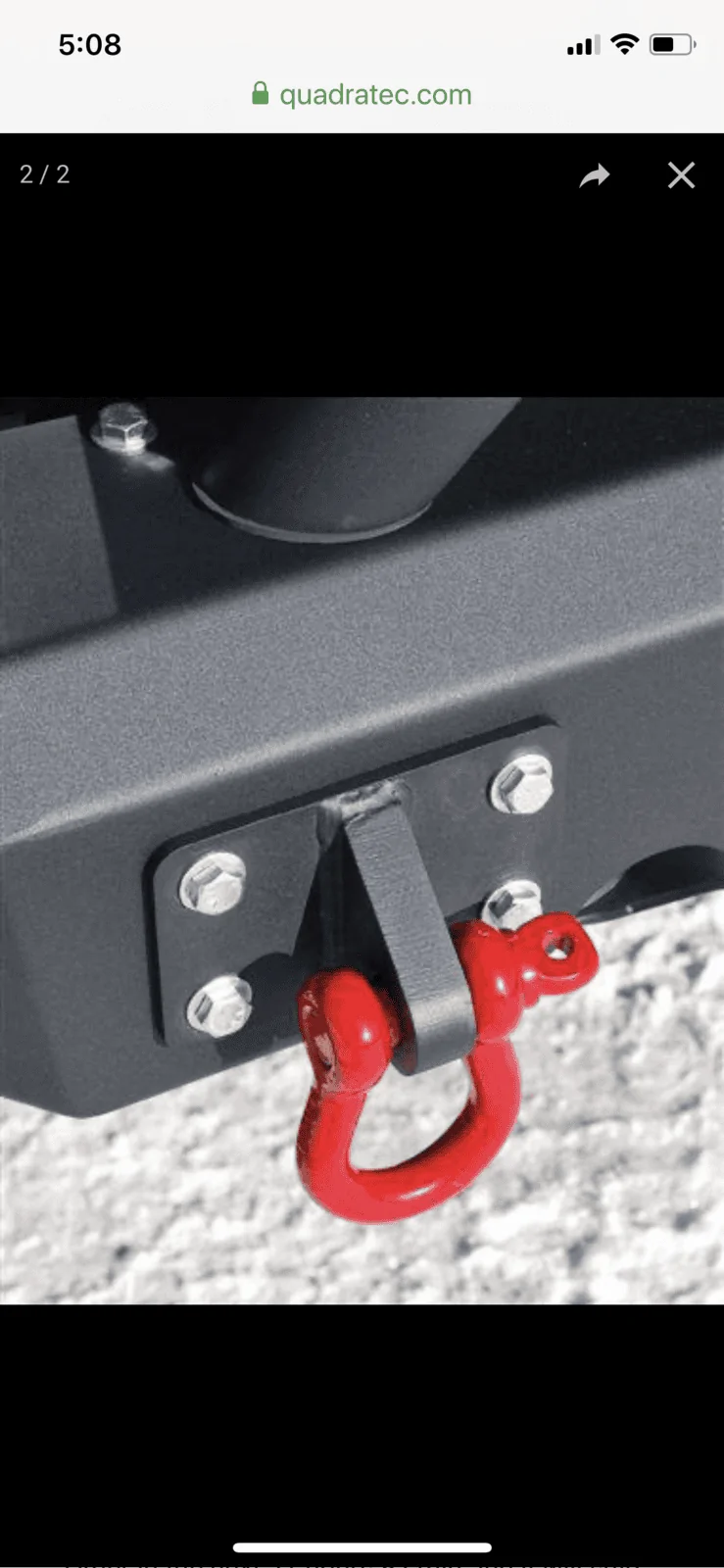

Looked up how they attach to get some ideas. Hope this adds something to this discussion. Not seeing anything on the inter webs. Seems like just closing the stock hook or a closed replacement would have your D rings in a weird orientation and apt to clank back and forth and just not look right ??
Seems like you’d need to turn the “O” section 90 degrees if you want to keep the factory style mounting points. Or if you can get/fab a bracket or mounting plate in there maybe you can attach something like one of these? Anyone else got any ideas/solutions? Good luck

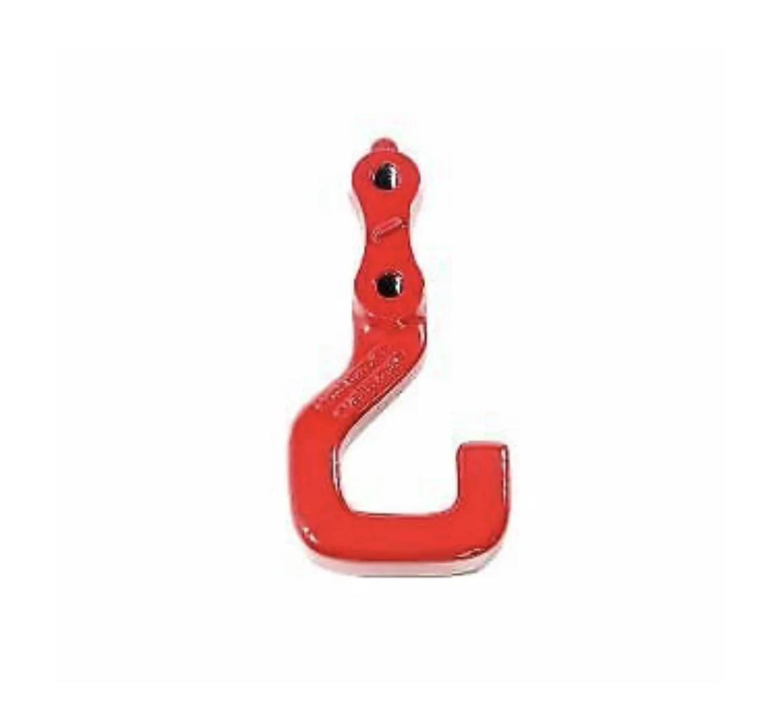

My Sport S with max tow has a rear hook only on the left side, attached to the flange of the hitch. From the above photo, you can see that there is an angled boss to help locate the hook while installing the bolts. I wanted to flip the hook and add one to the right side. If I need them, I will run a strap between them to distribute the load better when pulling the Jeep. That way, the closed sides are inwards so the strap is less likely to slip. I ground off the boss so the hook could be installed inverted and got new grade 10.9 flange head bolts, M14 x 2.0 x 35 from McMaster-Carr. (Stock bolts are grade 9.8). For the right side, I could not find a black hook even with the forged in part number on the hook, but the red version is easily found on-line (68334733AA),

While we’re on the subject of rear tow hooks does anyone else besides me think they are oriented on the wrong side?
By that I mean that the open side should be outboard?

I can see times you would want it both ways, and you never want it to come off regardless, which is why I think a closed solution is the only solution. That is why I appreciate this thread and am watching it for a good solution. I am not an engineer, but wonder about how the OEM hooks will stand up to side loads? I recognize this is an issue with closed solutions too. I could see it snapping at the bolt under a side load.

Yes, I also feel the open side should be to the outside, and that is why I described turning the hook the other way in my post above. I don't think two M14 grade 8 (the metric equivalent, M10.9) bolts are likely to shear. M14 is close to 9/16" diameter. They also give great clamping force since they can be torqued to something like 120 ft-lb (with lube) if you could get on them with a torque wrench. I used an 18 mm wrench and a long cheater pipe. They quickly get to the point where the wrench is "springy" since there is very little stretch with such a short bolt having long thread engagement. The OEM grade 9.8 bolts have a 21mm head (the slightly smaller 13/16" socket fits well).
