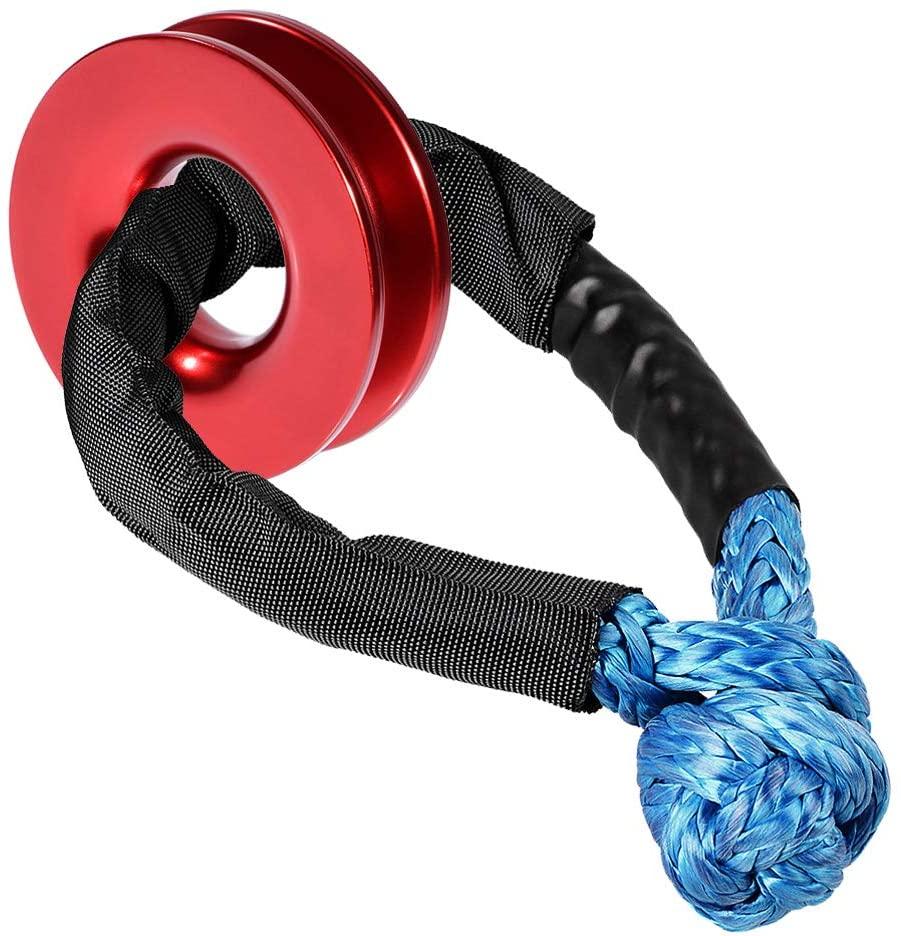

What blocks do you use? I've been looking at the soft shackle with a snatch ring.

What blocks do you use? I've been looking at the soft shackle with a wheel.
Harbor freight 20k blocks. They're $20 or $30 each. I've seen them used on videos with soft shackles but they're not made to be; too sharp where the shackle attaches.
Unless you're doing a single line pull (which should IMO only be done out of necessity) I think the name of the game is to take as much stress as possible not only off the vehicle but the winch too which means separate anchor points and line redirections. I feel like I'm about 2 static straps, 1 block, a 80-100' moving line, an X-Lock, and a sand anchor or possibly 2, from being completely set up. In the meantime I'm probably well covered, lol.

I have one of these - no soft shackles. I have a couple of steel clevises.
Wow those are nice and the same price and an extra 9k lbs not that it's necessary.
I didn't read your question properly.
Looks like a great setup and safer than a snatch block/ D-ring combo.
If you run across a good deal, LMK. I'd like to do a comparison.
