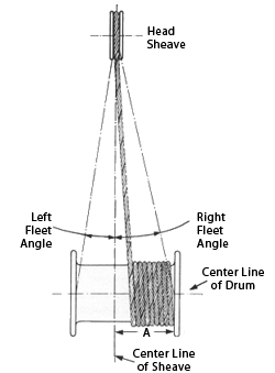

Some photos
Short story long is fleet should be between 2° and 4° for optimum loading of the drum and minimization of stresses in the winch mount. In our case this is a function of the distance between the fairlead and the drum. The next tidbit is what concerns us and that is the pitch angle of the bridle. If your leg length is too short, ie a small angle between load and line, the bridle will
transfer compressive lateral forced between the hooks. So longer legs with greater angles reduces lateral loading.

Some photos
