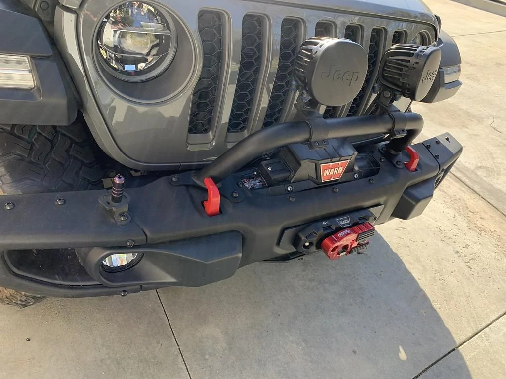

I have a Rubicon (steel bumper); what if I don't want to swap it out?
I just posted this in another thread... The Warn Bull bar for the Jeep steel bumper will close up the open hooks, so, they are safer for winching/pulling. Here is a pic.
