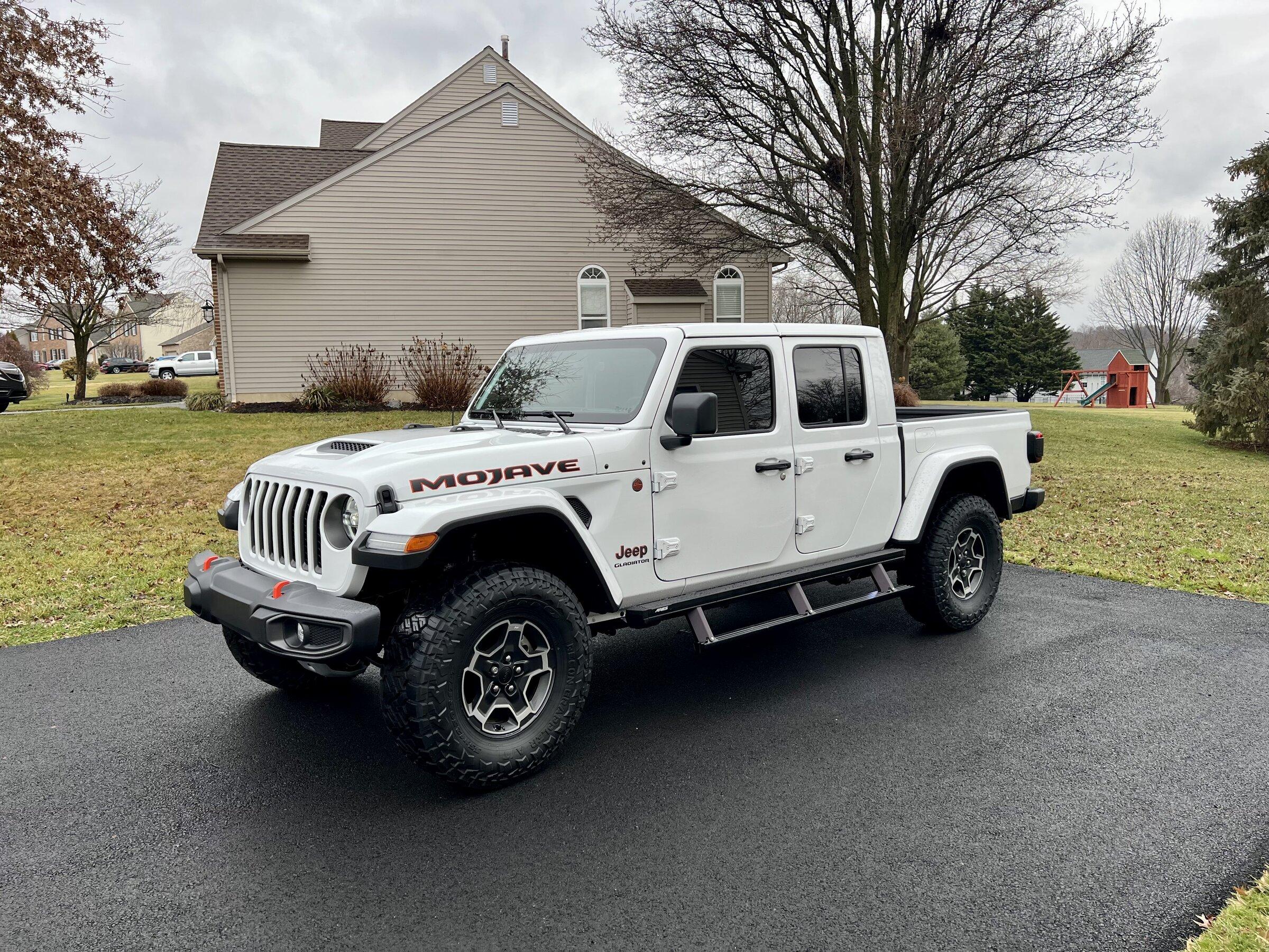

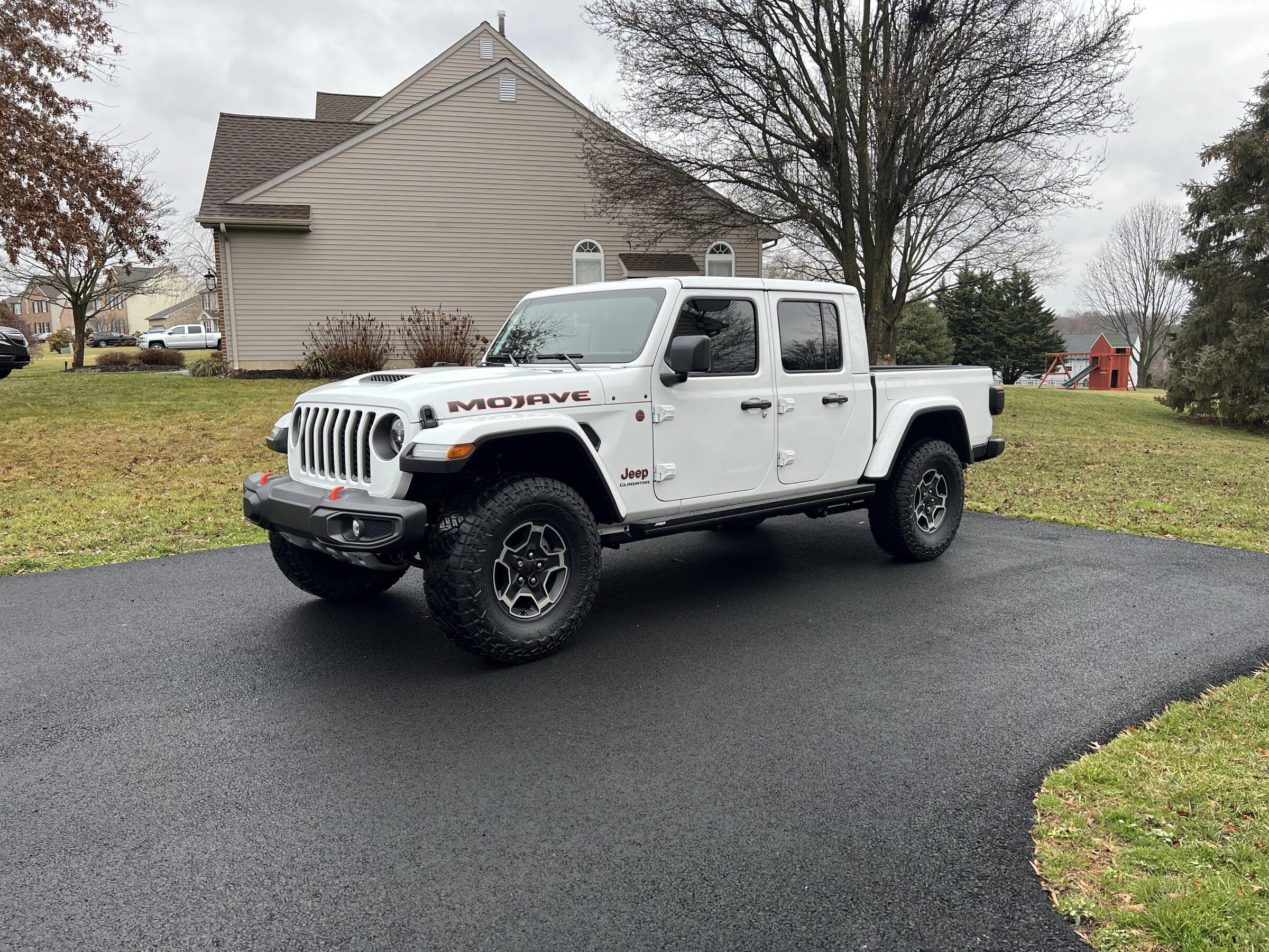

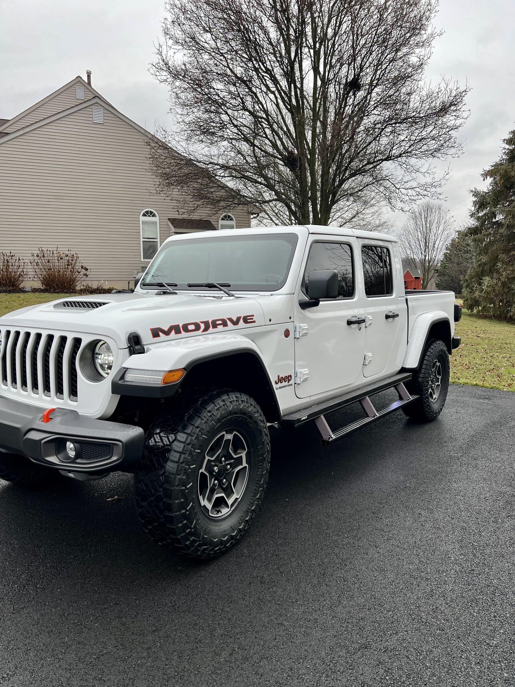

I picked up the Aries power running boards a few weeks back for my new Mojave. Seem to be working fine. Was able to snag them for $1300 after 15% discount code on AutoAnything.com
