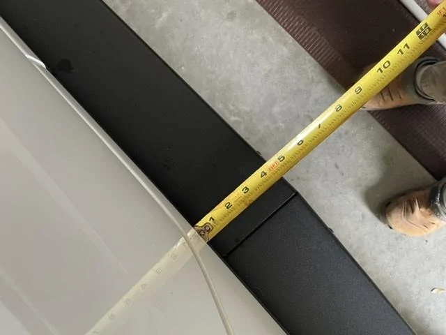

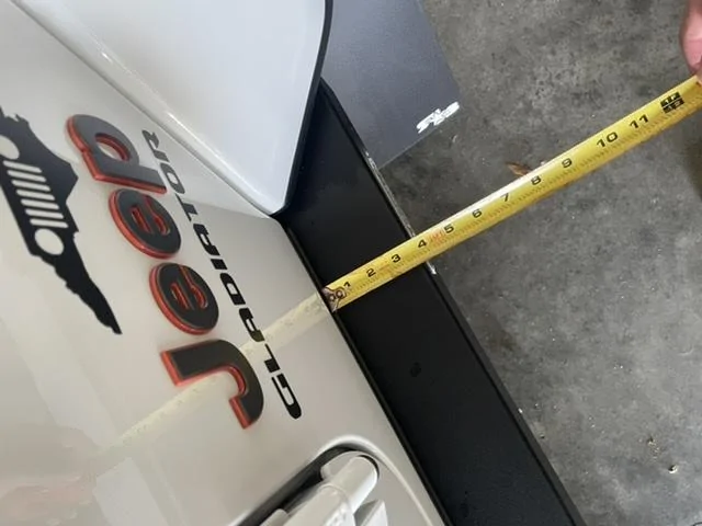

Can’t speak to the Overland width but here are the Rockslide Engineering Stepsliders widths. It’s about 3 ½ ā€ at the narrowest point and barely 4 1/2ā€ at the widest point. Still plenty of room to use as a step or stand on.
Thanks for the info - I can measure my Overland stock running boards and see how things compare. I'd not mind taking the front of mine up another 1/2" but my wife has trouble getting in as it is.

With the retractable step coming down, we don’t even use the upper portion of the step that I measured for you. I guarantee your wife will have an easier time with these steps. My wife loves them.
