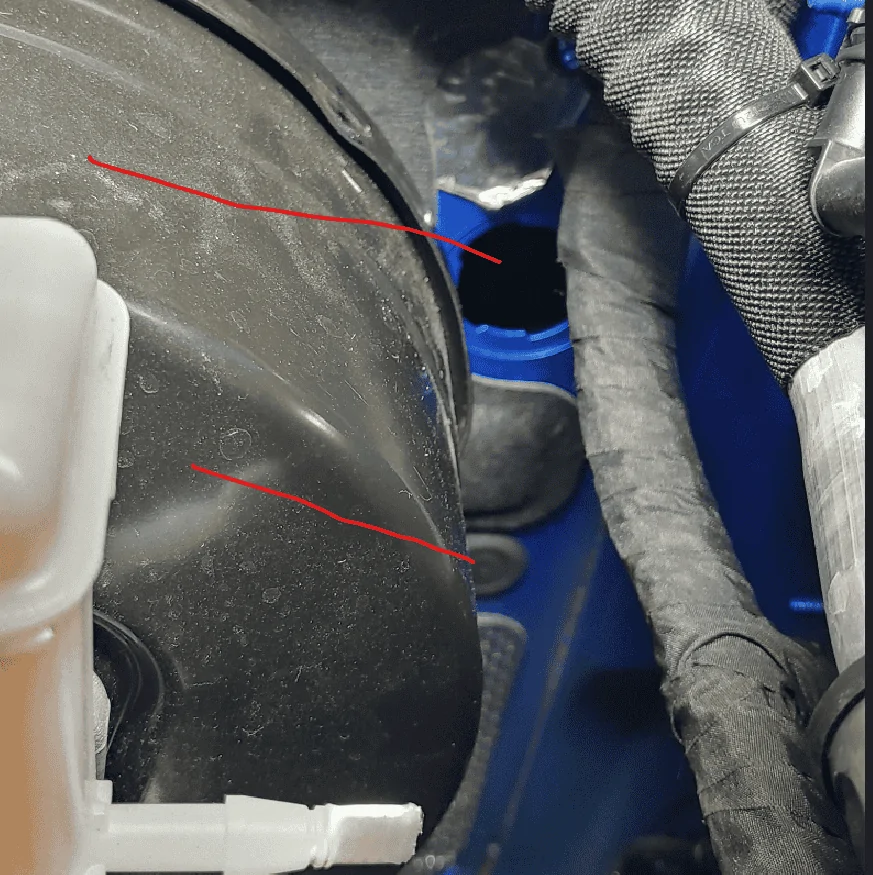

Probably using the clutch access through the firewall… for the cable release.
This is probably the exact reason they say it doesn't work with the manual. I suspect you could use this with a manual transmission, but you would need to create an alternate route for the air lines and release cable.
I also think they may have chosen to use an air-lock system so that there are no power requirements under the hood.
That's no reason - you need to run the AIR LINE out there, you could just as easily run 16 or 18 gauge wire out there to operate a door lock motor to move that back and forth.
If you can route an air line, you can route a wire - and there'd be no power out there unless you locked or unlocked it. Otherwise the wires would be dead.

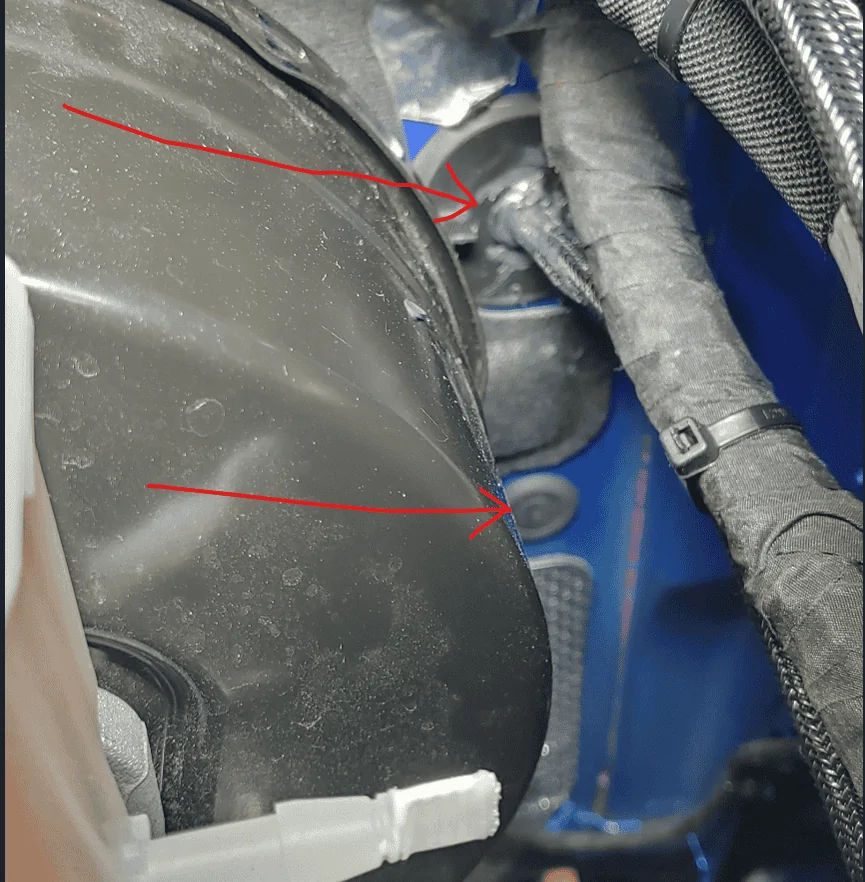

There's more than one place to route wires through the firewalls - I had to route some heavy cable from the cab out to the left side of the engine bay for my snow plow and there's at least two possible paths to do so. (one a bit easier than the other)
Jeep Gladiator Review of Lasfit's new Anti-Theft Hood Lock System (version 2.0) 1672068264680
This bundle has several wires - the lock maker could have run power for door lock motors out in less space than this snow plow harness takes (the lower hole could be used for the lock - I chose to use the higher, easier hole to reach from the engine bay)->
I don't think it has to do with running the line through the firewall, more about durability, especially when wheeling or subjecting a Jeep to Jeep things. lol. It is just my speculation as to why they chose this route.
That lower hole is a real pain to get to from inside the cabin. I was going to use it for my amp wiring but didn't want to deal with the effort of reaching it and pulling it through. I am too old and lazy I guess.

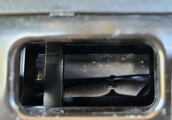

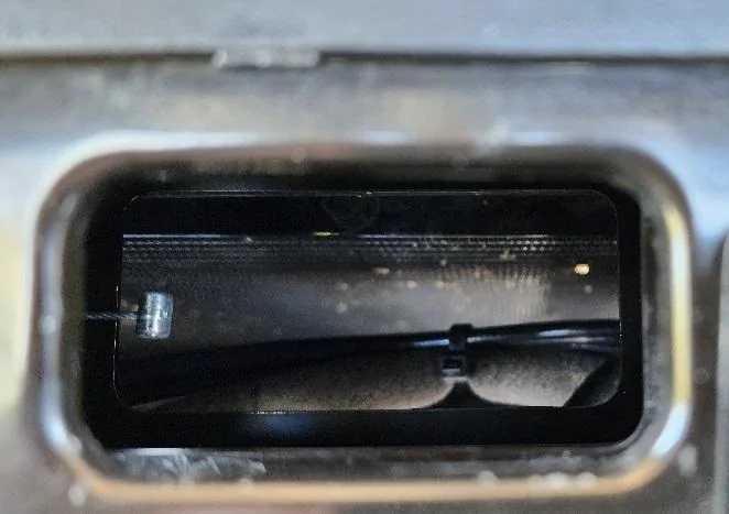

I can see your points on this.
From the video and pics, this plate on top of the cowl has an integrated bar that slides across the factory latch (the "hook") to prevent it from releasing.
Way I see it, linear actuators wouldn't work. And yes, they've been used for years for latching but there's no easy way to easily mechanically release this in its location in the event of a failure, power, corrosion or otherwise without compromising the security the device provides.
IE: Say it gets stuck closed (latched)-- how do you release it without doing damage to the actuator/gearing? Maybe find something like a garage door track release that pulls the teeth off the drive?
And then, even if you can release it, how then do you pull the bar back when it is inside the cowl?
This system has two redundancies-- a button in the cabin and the mechanical link to pull the bar back.
